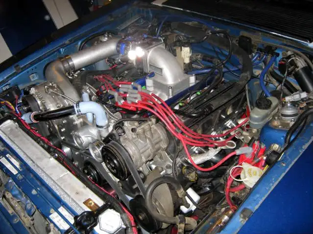

So I am finally getting the '88 GT on the road this Thursday, with an alignment and new tires, and a windshield, then on Friday the dyno is booked. Guesses on power? Street legal drags are Friday night too, 1/4 mile guesses??
306 Stock Bottom end girddled and ARP everything, F cam, forged speed pro pistons, Performer RPM heads, Hurricane intake, 70mm TB, 90mm LMAF, 42#ers, 255 walbro, aeromotive FPR, Novi 1000, UPR power pipe, mac longtubes, h pipe, dumped flowmasters, 9.3:1, 10lbs boost, CF DF clutch, fidenza flywheel, T5, aluminum DS, 373s.
GMS UCA/LCAs, Eibach sways and pro kit, Koni yellows
Probably forgetting something....

Sorry for the delay. The dyno run was ****. When I got there, I had to wait for 1/2 an hour (after the appointment booking time of 1030) So at 11am, the car was finally on the roller, I took out the laptop and pulled up the tune for the tuner to look at. He didn't look at it. We did a quick run, it was lean. He was not familiar with a tweecer at all, told me he could sell me a SCT chip and tune it no problem, but wasn't really interested in figuring doing it. After a couple half throttle pulls (no boost) he said the MAF signal was to jumpy (and it was) and we should clock the MAF. Then I didn't see him for 20 minutes. Good thing I have a small tool kit in the car (First couple of day on the road, had to be prepaired) So I 180'd the MAF, still a jumpy signal. And that was it. They told me that I couldn't have the airfilter right on the end of the MAF, as the air would be too turbulent and was causing the dirty signal, which would make sense, although I have seen alot of setups like that. Anyways, I stood around for another 15-20 minutes while he was talking to some other people while the car was still hooked up and strapped down. I finally got fed up and interupted him and his buddies and asked if I could get the car unhooked and get out. I was there until 12:30, paid him for an hour dyno time ($120)
The whole time it just seemed like he wasn't interested in doing anything, spending time with other people who came in, texting/talking on the phone, it seemed alot like I was a burden. So that will be the last time I go there. I have heard alot of great things about that shop, but like I said it just seemed like he didn't want to do anything.
Best pull without getting into boost was 276hp/290tq. My ass dyno feels alot higher.
