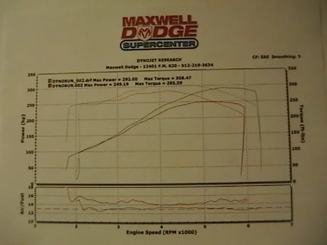

Here is my dyno from bolton with a crappy mail tune(red) vs now with VT stg 1s, Lts, dyno tune, ect. the LTs were added after the tune..but it didnt seem to effect it at all :shrug: . Notice the power curve even with the cams/LTs...didnt really loose much of anything down low. I LOVE the cams.

KenB on Modular Depot has posted a couple of times a dyno graph of car with Comp 262's and a car with VT Stg II cams, yes that is correct Stg II, that had identical mods. The Comp cammed car was right there HP and TQ with the VT's. I personally like the Comp cams better.
