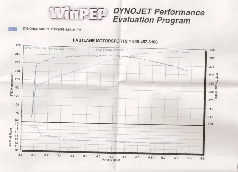

heres the chart
that gragh is not scaled right.
I know, I hate when they do that, one side for the torque and one for the horse power. They do that for a variety of reasons, the practical side of me says its so everything fits nicely on the graph, but the cynical side of me says they don't want you to think one "line" is so much different than the other.

looks like you may need an ign upgrade with the squiggly lines there good numbers though
Not necessarily, it all depends on the smoothing factor the operator is using. The dyno graph is like writing computer code in that "garbage in = garbage out." On the other hand, you could be exactly right. Might be time for an MSD blaster 2.
Great numbers, I think she is running well!
