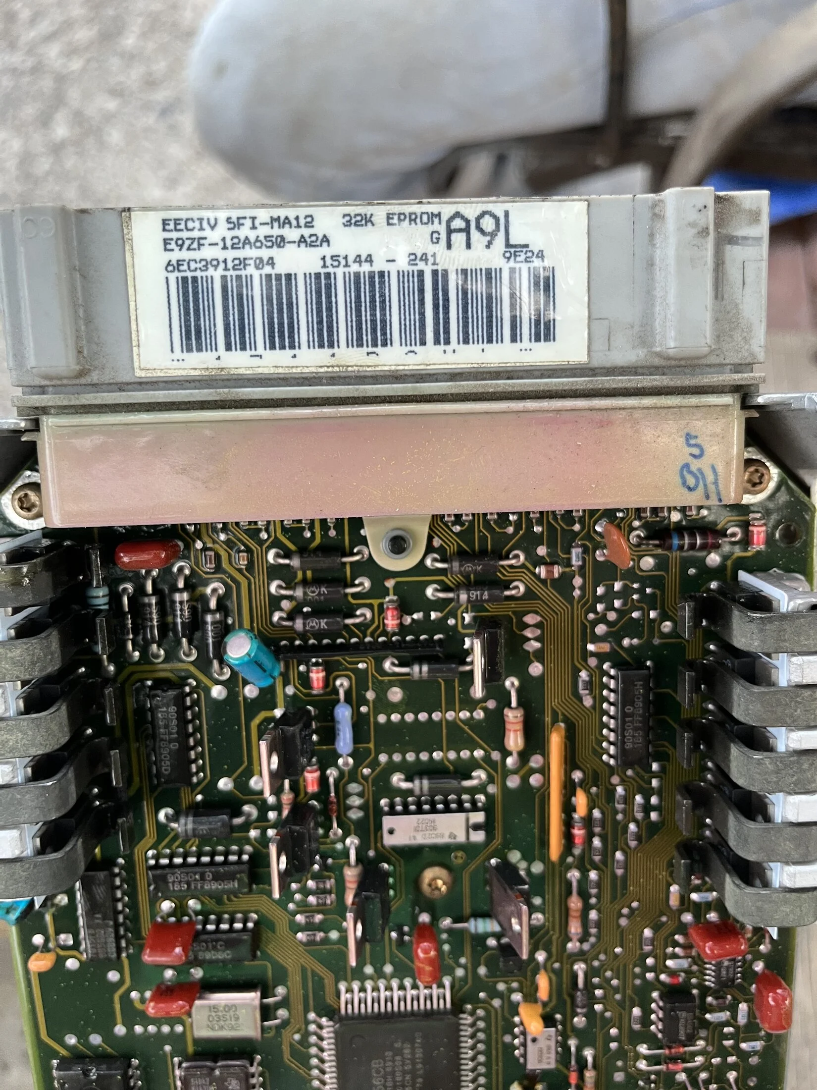

Recently purchased an 89 5.0 5 speed convertible. Computer has gone bad. E9ZF-12A650-A2A A9L is what it has currently. Wondering if it is the correct computer for my car or if i need a different one. Anyone with a similar specs fox can you let me know what computer you have? please thanks in advance!

That A9L should work fine. The A9L and A9M are basically the same. The A9L you have came from a hatch back or notch 5.0 5 speed. If you suspect a computer problem I recommend ECUexchange on ebay. They have rebuilt tons of computers for guys on here and a few of my customers.

An A9L is probably the most common computer to find for the Mass-Air equipped foxbody. It will work in your application regardless of what was originally equipped. There are some very minor differences in some of the ECU's but they aren't big enough to really work about.
Generally when comparing fox ECU's, most go by the 3 digit code on the right side of the label. So in this case, the popular nomenclature would be A9L for that one in your hand.
WHy do you suspect your ECU has gone bad? I would send it to ECU exchange for recapping if you are not able to do it yourself. WIll be MUCH cheaper than trying to source a replacement A9L as prices have gotten a bit crazy on them.

Any 89-93 5spd mass air ecu will work if the car is wired as a factory 5 spd and not some ones swap.. Most old search/ google results have the 3 digit catch codes wrong for auto vs manual outside the common a9l/a9p. But if you have a core, a rebuild service is much cheaper these days, if they say they can't repair it ask for it back. outside of a burned board and a couple chips they can be repaired or used as parts cores by a large rebuilder like cardone or BSE..
The caps are easy, the compatable transistors are getting hard to find and backordered though. Parts houses would list the A9l as E9ZF-AA, they drop the numbers from the full part number. Most places only have inventory of 88 Cali computers For remans which would be the 8L X series, outside of that the parts hoarders and flippers on ebay are asking stupid money for them and are are probably just only throwing new caps if that in them.

Thanks for the info and i was told by a mechanic that the computer has gone bad because it turns on then shuts off also some of the inside parts (dont know what they are called) where loose and with like black oil coming out of the bottom.

Yeah if you have a core ecu it's definitely worth repairing, even most local computer repair places are capable of repairing those, caps and transistors are a few dollars in parts, rest is labor to replace and test them.. the guys trying to get 500 and up out of used or repaired one, better options out there, people just hoard them.
