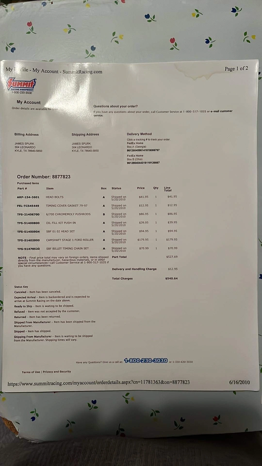

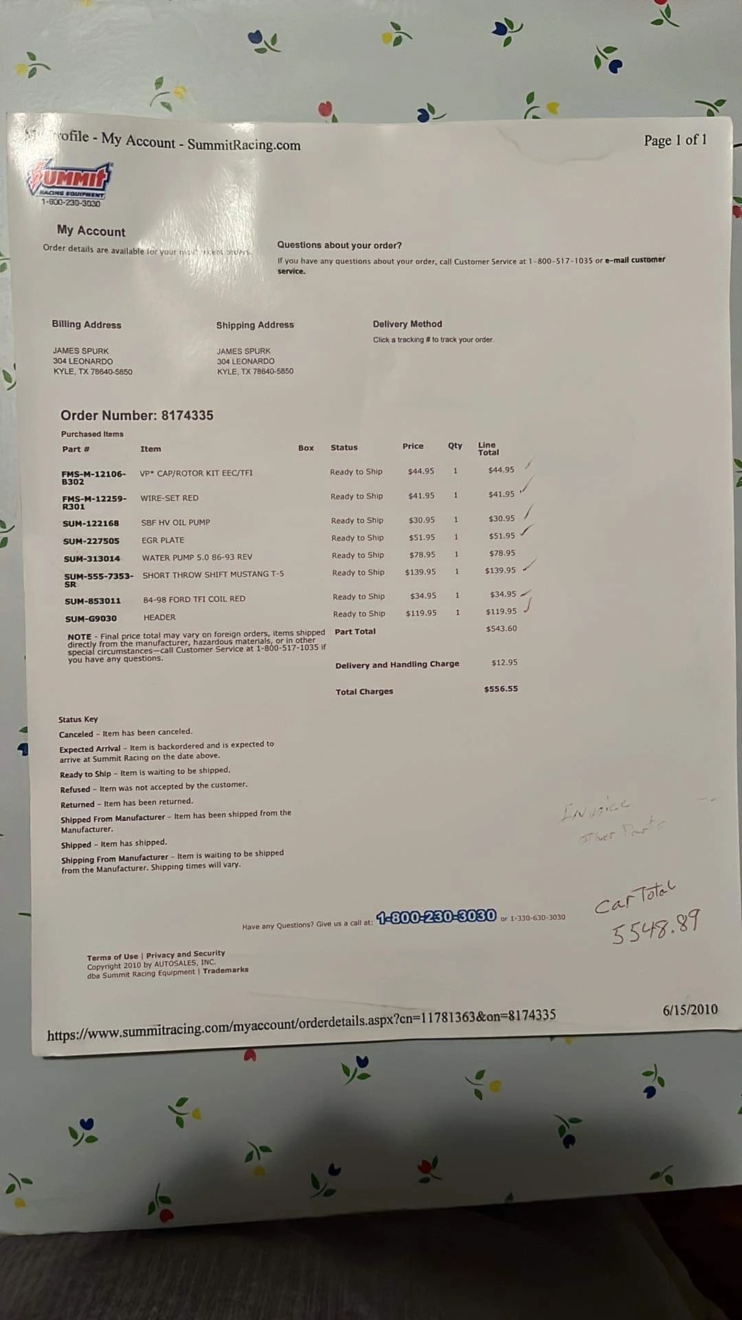

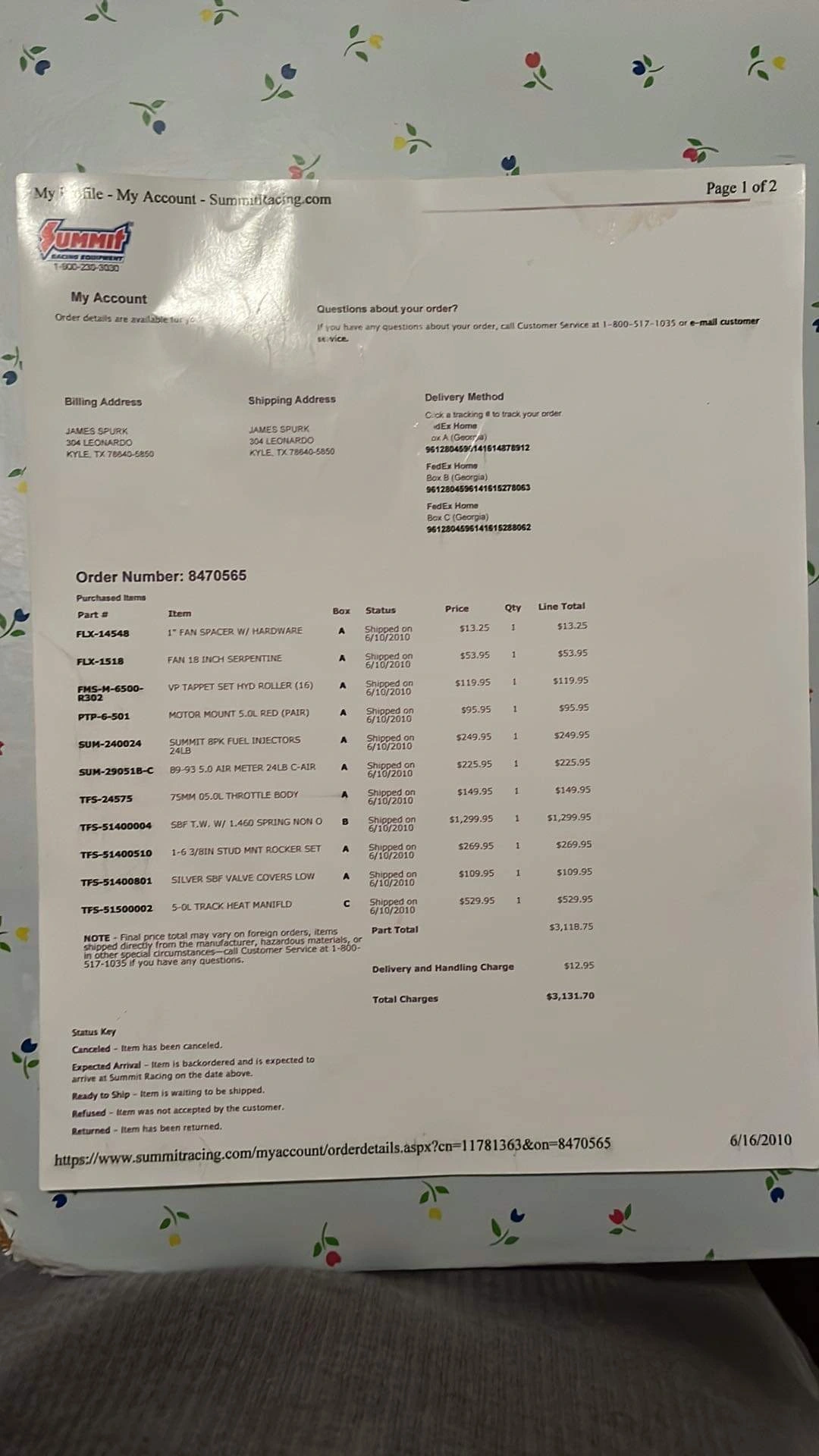

Ok will try to find out later today. Im hoping i can figure out before putting the new computer. I did find a parts list in the car and it has a bunch of stuff
