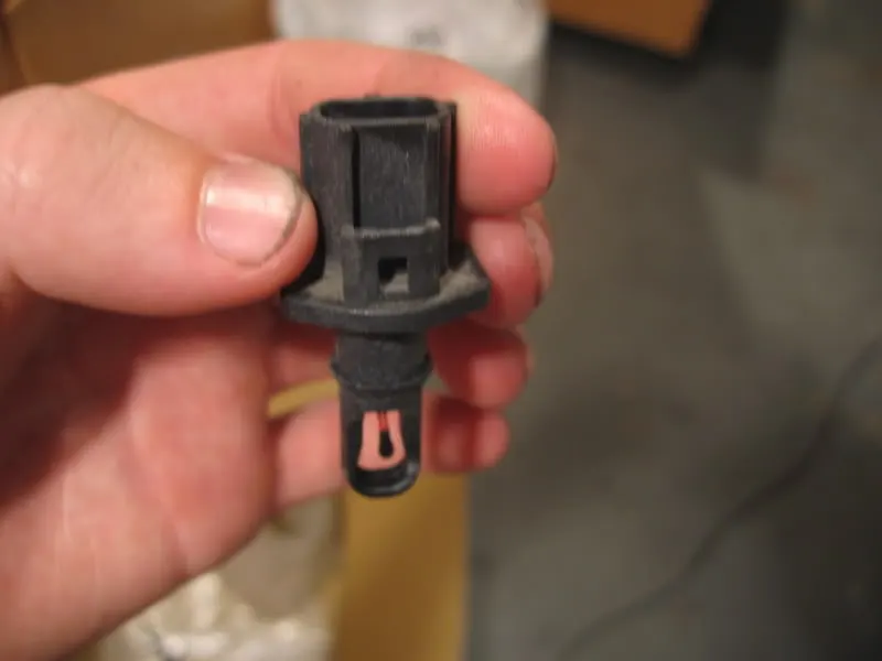

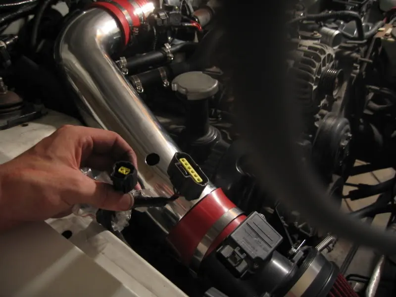

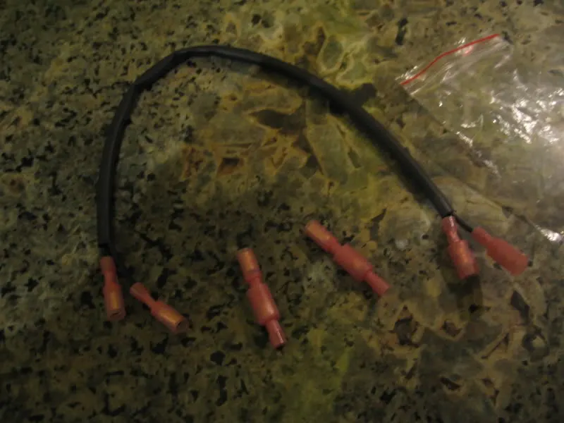

So I bought a cheapo intake after being forced to because of the mods I'm doing. There were no instructions. Included were these wires and connectors.....
I'm assuming they have something to do with the connector on the left...I went to take the sensor that the plug goes into on the stock intake and put it into the hole on the new one but it didn't fit. There was a plug for the hole in the new intake included.
What should I do with this....

well what do i do with that harness on the left? what is it for? I was able to remove the sensor ?!?! or whatever it is from the old intake tube but again doesn't fit on the new one.... I have since put a plug over the hole on the new tube you see in the pic..
help:shrug:
Yes, that should plug right into the hole already drilled out. As stated above it's the IAT sensor (intake air temp.). If it doesn't stay in, maybe use a small amount of RTV (?) with a small o-ring or gasket to make it stay put.
The plug on the left in your first pic plugs into the sensor you are holding in the last pic. Those got to go into your intake tube were the hole is at. The other plug goes right into the MAF. Also, there is a gromet from the stock tube that you need so the sensor stays in the hole.

As to answer your question... the sensor is the IAT, it measures the Incoming Air Temperature. This sensor must be located in the intake, otherwise your car will not be right and it will be impossible to tune. As others have said, there is a rubber grommet (like an "adapter" or "bushing") that fits into that hole and will nestle the IAT making a tight seal.

Its missing a rubber bung that goes into the whole so your IAT can fit snuggly. The stock upper intake tube doesnt have the bung because the IAT already fits snuggly into the hole.
