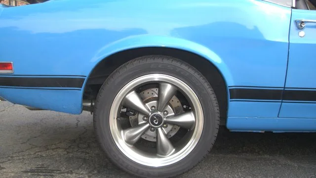

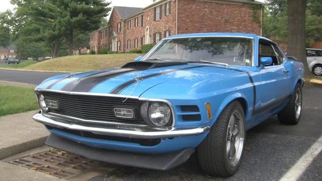

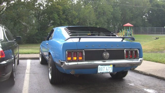

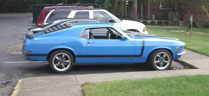

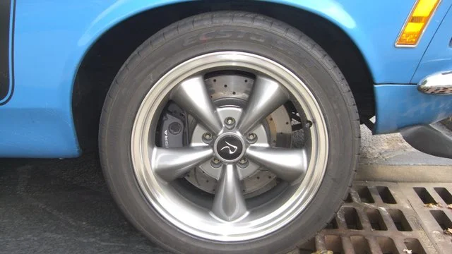

I put these exact rims (17x8 front and 17x9 rear) on my 70 sportsroof, but with the gray color. I went with 245/45's on the front and 275/40's on the rear. I initially had a rubbing problem, but that was attributed primarily to the old (read original-minus shocks), sagging suspension. New leafs in the rear fixed that problem and i am currently putting coil-overs on in the front. I am not anticipating a problem there either. Once i get to do some hard driving and see how the end result performs, i am considering rolling the fenders to provide a little more clearance. i can post some pics if you want.
i'll post some more pics here in a minute. Overall, I was very impressed with these rims. The finish was smooth and without any flaws in the coating. I am unsure of the weight of these, but they are probably a bit on the heavy side... but i guess that can be expected for the price. I have driven with these rims on now for about 7 months and do not have any rusting or pitting anywhere on these.
