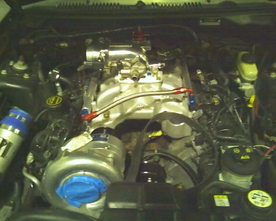

here you go

thats a high rpm intake! the only reason that procharged car made that much more power is because it was reved from 5200rpm on the first dyno to 6500 on the second with this intake.
if they reved to 6500 with the plenum and the stock intake it prob. would have made the same power as with the edelbrock
5200 was where peak hp numbers were made. The dyno run made it to 6200 and was falling. 6500 was after the intake install and its peak numbers. The car would have made even more power w/ a better set of after market cams. If you would like I can get the two dyno sheets for you guys to look at.

tank_567 said:
here you go
where did you get the adapter plate from the plenum to the intake....i want to run that setup!!!!!!
My brother made that at his shop BIGWOOD RACING HOMEPAGE Give them a call they will make one for you.
