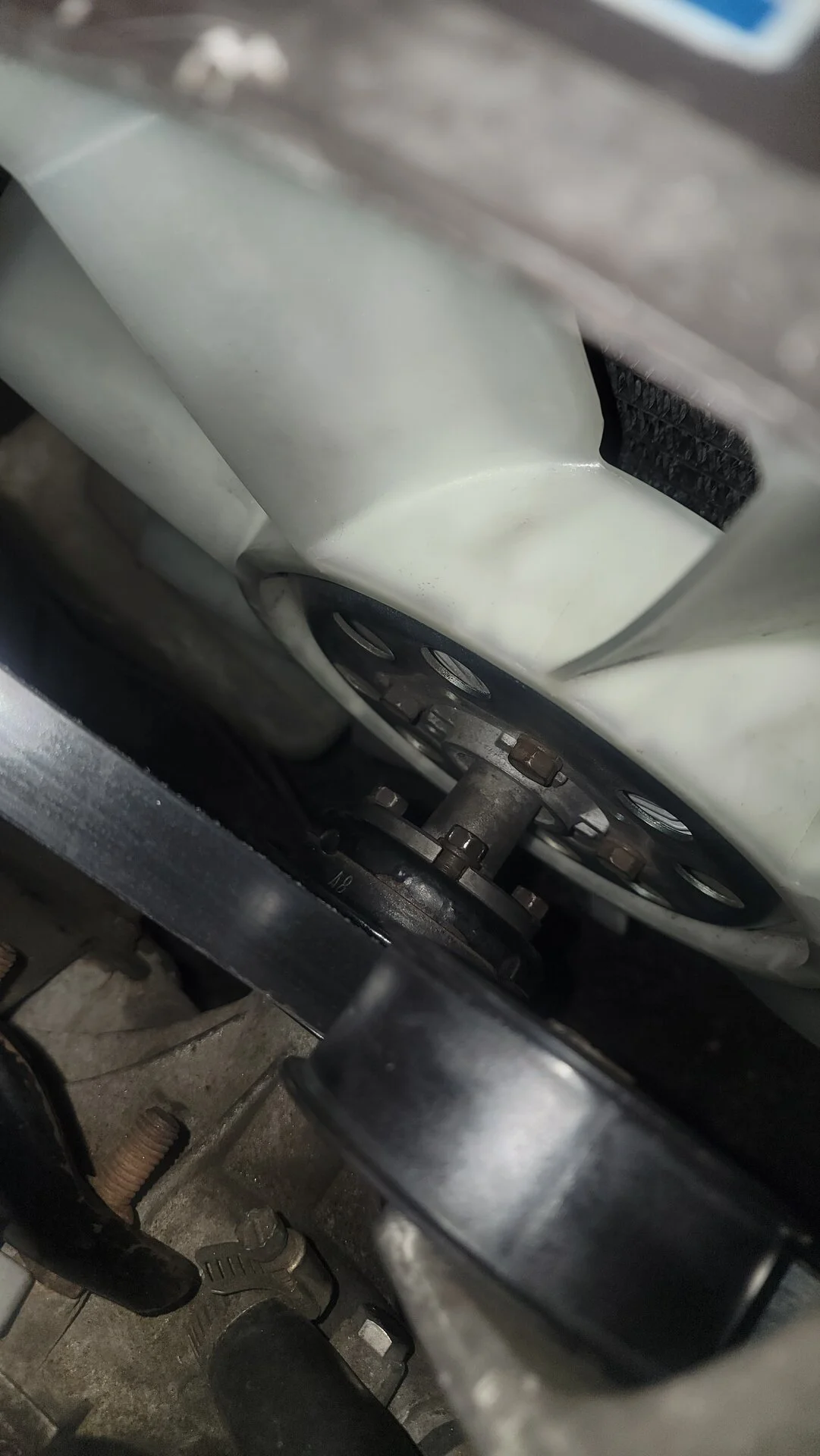

it's so hot under the hood but I wasn't sure if that's from the vacuum and EGR issue I have going on I open the hood and it's like I opened the oven
That is the good fan setup IMHO
So if that fan clutch still has some resistance and has not lost any of its oil you should be good
The shroud should surround it
Someone may have cut yours to aid in removal
You could rivet or bolt in a piece of thin plastic to replace what is missing
So if that bclutch still has some resistance and has not lost any of its oil you should be good
You could rivet or bolt in a piece to replace what is missi
