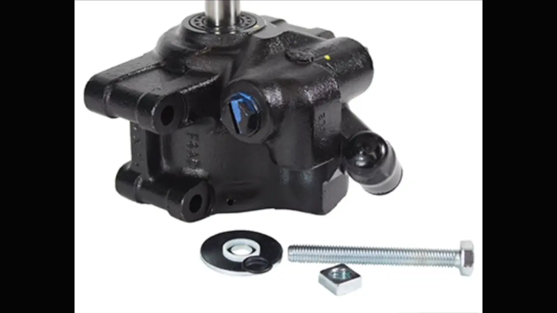

Guys, I just ordered my power steering pump from Ford. Part number AR3Z3A674BRM . I wanted to make sure I got a ford part since I didn't want to get a cheap one from autozone or other places that weren't Ford OEM . My question is am I supposed to prime the power steering pump? Did you guys have too? Or just plugged everything in and filled the reservoir and turn left right left right till the whine sound was gone? @TOOLOW91 @89oem @RacEoHolic330
Just filled it , turned right to left to bleed out the air pockets

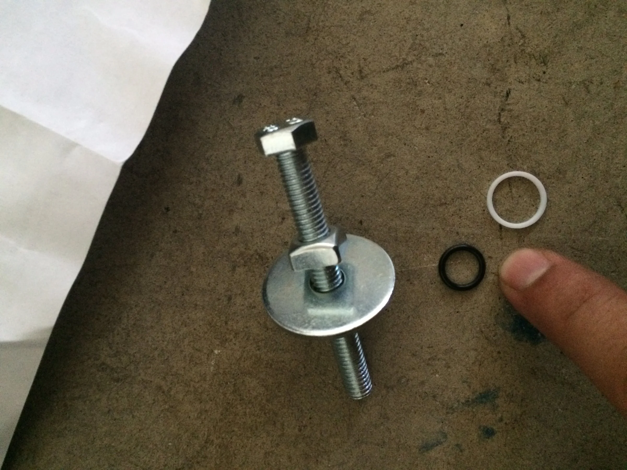

@TOOLOW91 @89oem when I go to install the pulley how far down should I press it? I don't know if it should go down till it bottoms out? Also looks like the kit comes with a o-ring /washer / square but and bolt. How do these go installed?

The PS pump I got came with the pulley mounted as part of the bracket kit. It's reverse mounted but the billet pulley looks all the way on shaft if that helps

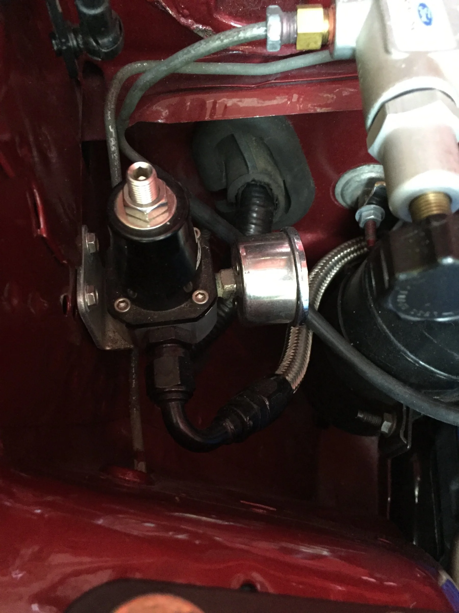

How dos you do your fuel system? Did you keep it returnless? From what I have read it seems that the control pack is calibrated to use return style but then again the the rails on our coyote motors come with returnless fuel rails. Am I suppose to buy different fuel rail?
Has to have return line, We used an Aeomotive regulator, here's a pic of the PCM harness entering the bay and exits to wheel well behind regulator, fuel lines all route through the regulator, find a good place to splice to the existing fuel lines or run new, the fuel connects to the fuel rail as set on the drivers side.
