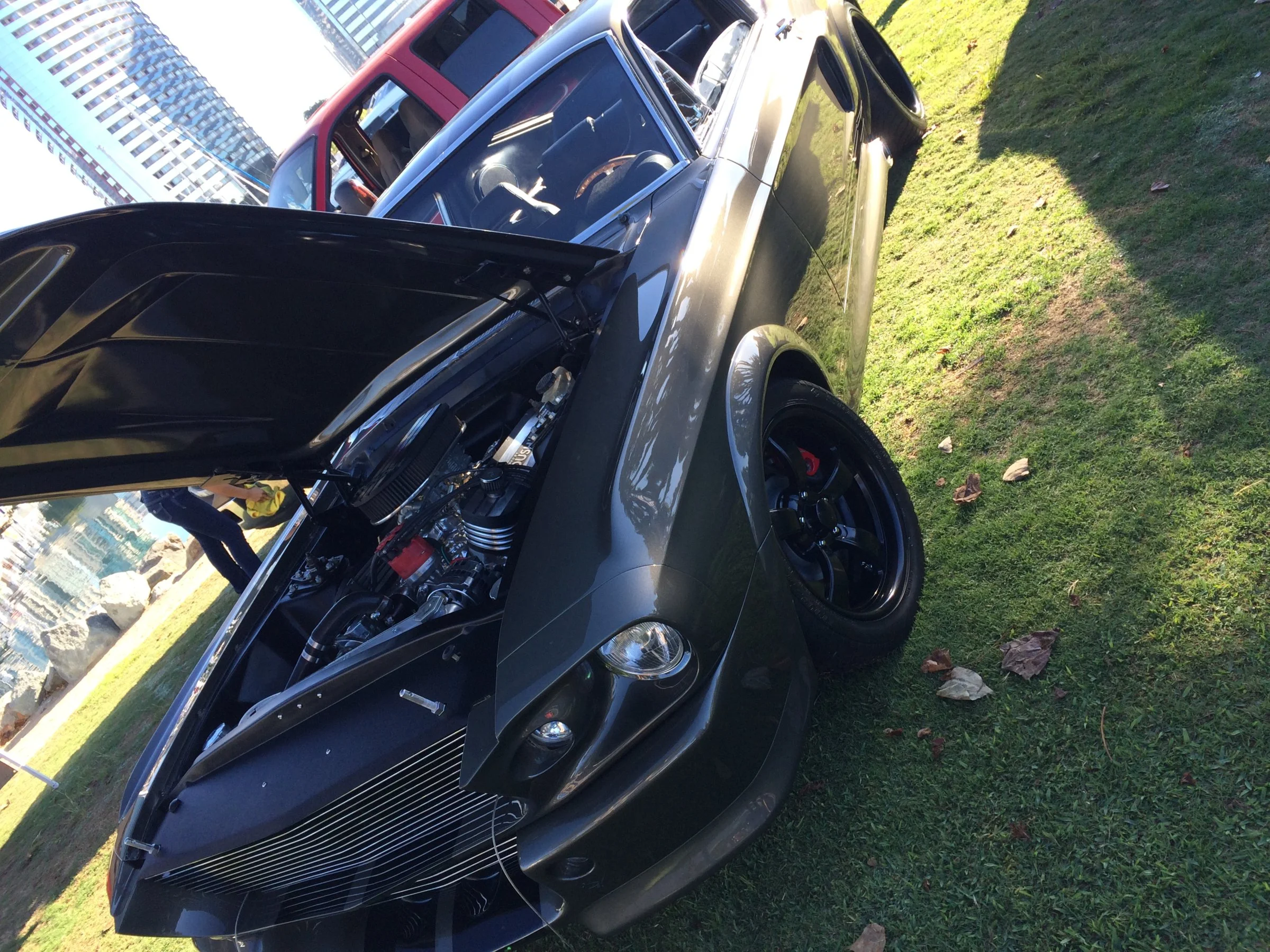

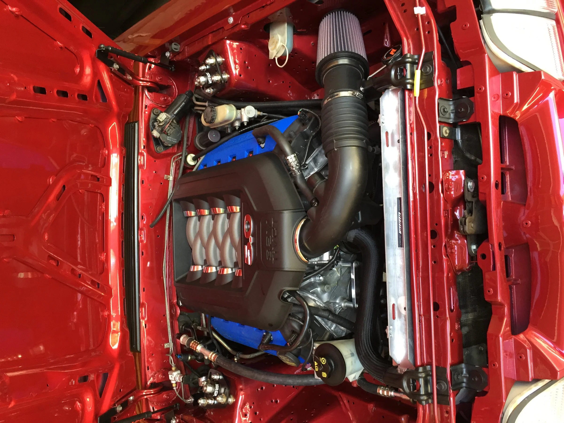

Has to have return line, We used an Aeomotive regulator, here's a pic of the PCM harness entering the bay and exits to wheel well behind regulator, fuel lines all route through the regulator, find a good place to splice to the existing fuel lines or run new, the fuel connects to the fuel rail as set on the drivers side.
Ok I'll do the same then. I have nothing so I'm starting from scratch as far as fuel system goes I'm buying Aeromotive tank and every thing else that goes with it all the way up too the rails. I wasn't sure how you would route a return line to a fuel rail that is returnless . Now I see that the "return" line is routed thru the regulator. If I understood it correctly that is. Thanks guys! Learning quite a bit thru this thread!

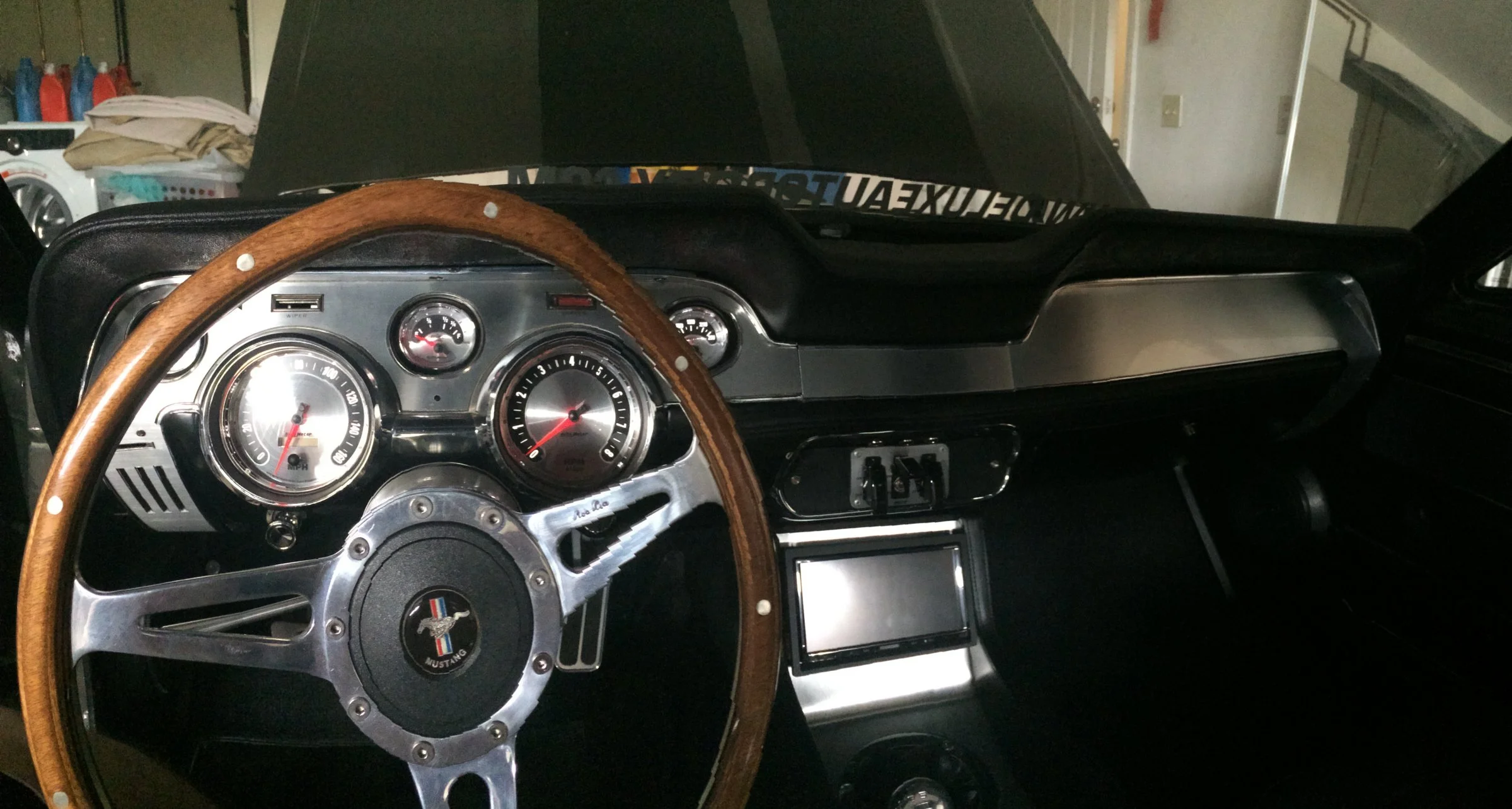

. Funny cuz I bought this car and I wanted to just make it run good , slap wheels on it , and paint it. And look at me now!! Crate engine! Completely restored and sandblasted ! Custom interior ! Completely redone front and rear suspension and the list goes on! One thing lead to another and now the only thing old on this car is the shell it self hahahah. I love this project and what it has came to be.
