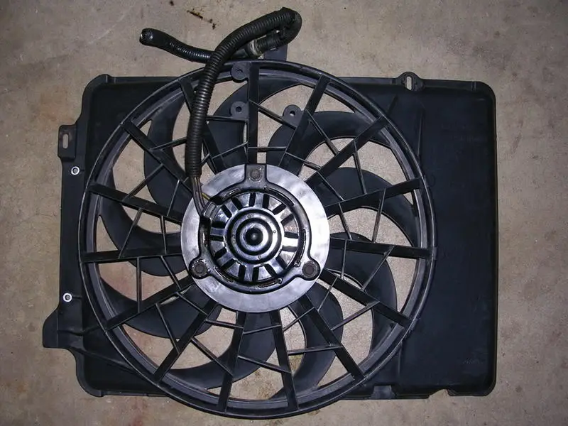

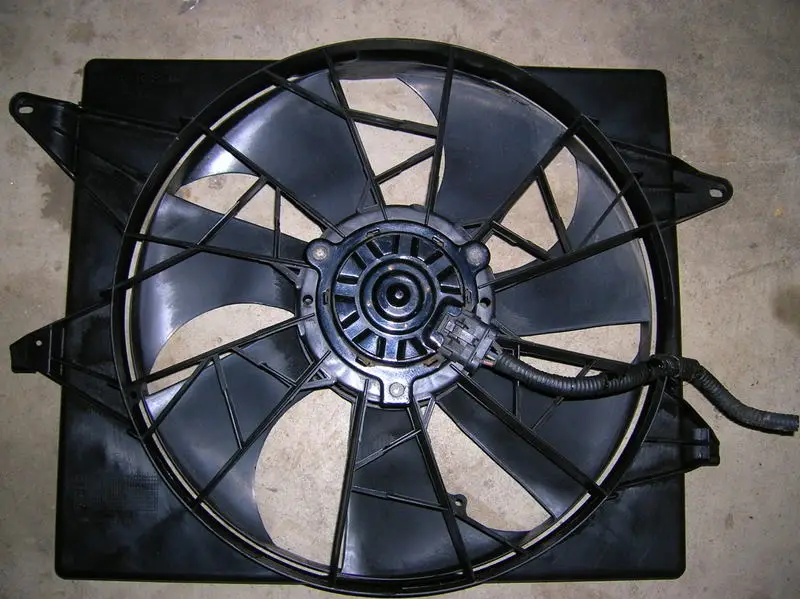

o The Mark VIII and Taurus (Taurus and Mark VIII fans have same motor) fans flow about 4500 CFM and some have done about 4900CFM.

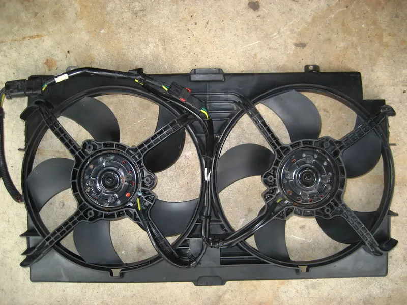

o The older style Dual Ramcharger style fans flow about 3500-4000CFM

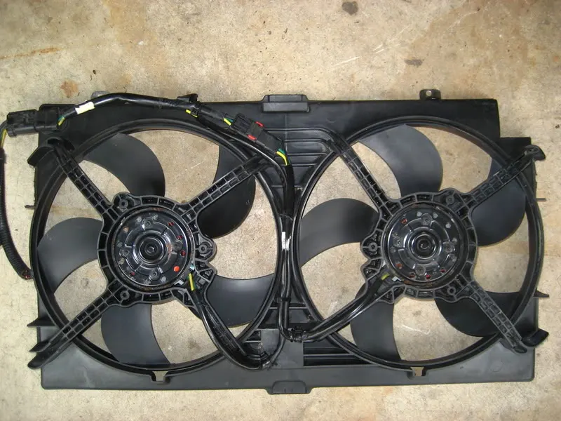

o The newer Y2K Ramchargers flow about 3000-3500.

- Mark VIII dimensions are 18.5 x 22 x 6 and 18" blades, not including the tabs.
- Mark VIII w/ trimmed tabs and trimmed depth dimensions are 18.5 x 22 x 5.25 and 18" blades
- Taurus fan dimensions are 18.5 x 23 x 5 inches, and 17" blades
- Y2K Dual Ramcharger style fan dimensions are 26 1/2 in wide by 15 1/4 in tall and a slim 3 5/8 in deep
- The older Dual Ramcharger style fan dimensions are 15 x 25 x 3 inches deep in the center and 4.5" at the small fan motor center and 5.75" at the tall motor. 13" fan blades.

Y2K Dual Ramcharger fan w/ Cusom brackets for 5.0
OEM unmodified Mark VIII fan
Dual Ramcharger fan w/ custom brackets for 5.0
Taurus fan
