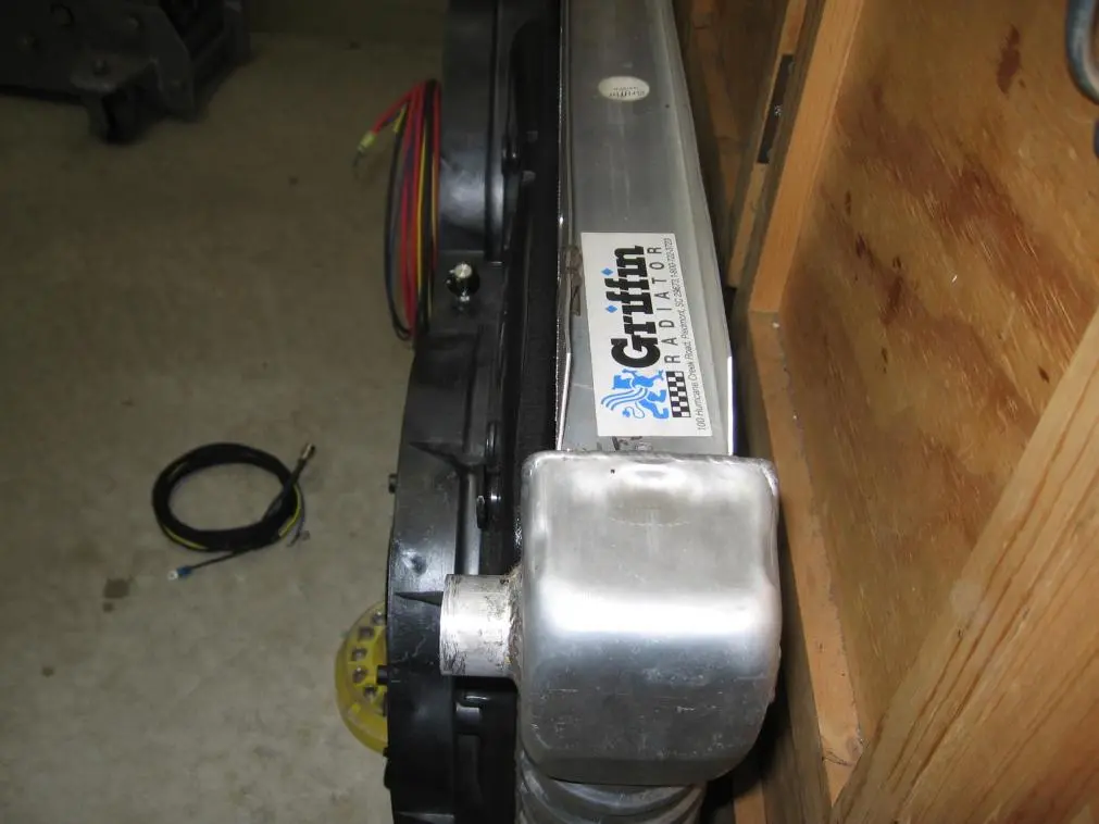

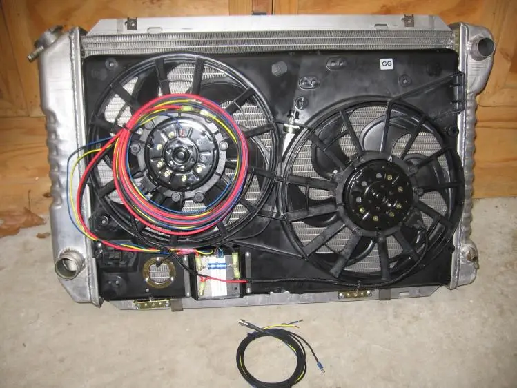

I have the dual fan/DC controller set-up. It runs at 180 all day long, even w/ A/C on. The fan is an OEM Ford unit from the SVT Contour. See Search Results for " dccontrol.com " for specs on fan. Baskin makes a great controller that I wholeheartedly endorse.
