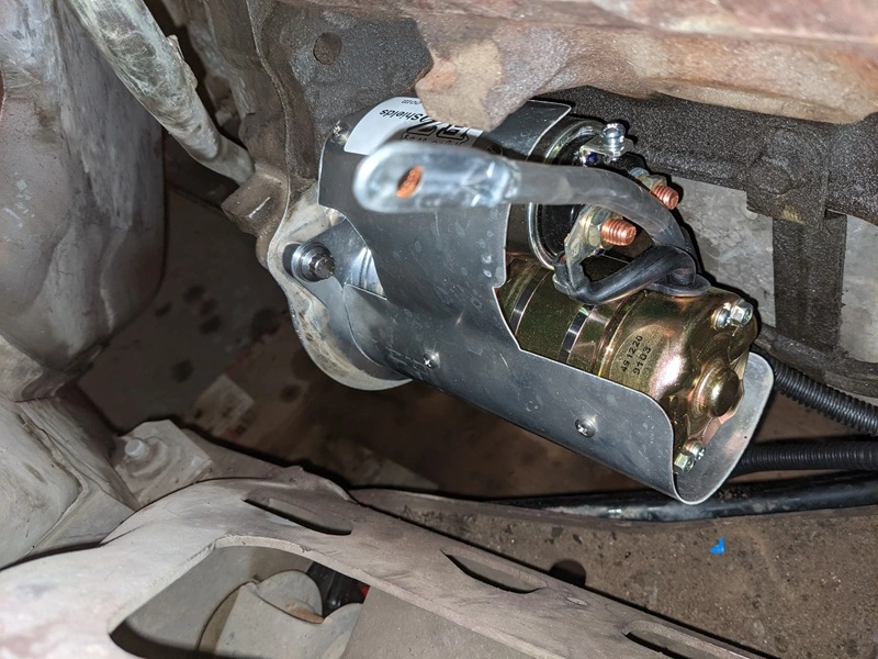

I installed long tube headers and a Powermaster high torque mini starter at the same time, got a nice heat shield off ebay and it has worked great. The PMGR style mini starters are less susceptible to heat soak in addition to having more physical clearance. I would definitely recommend a heat shield and not a wrap as they can hold in heat, whereas a shield allows air to flow around the starter.
Can you take a picture of the heatshield installed?

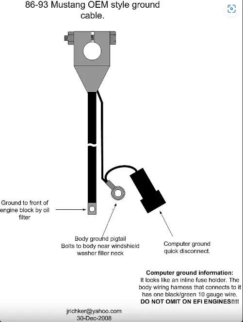

Which wire are you referring to as the "frame ground"
Negative off the battery comes of and goes under the engine and grounds to a specific boss on the timing cover. There's also a small ground that comes off the back of the cylinder head and connects to the firewall.
Took me a while to find a good picture of what I am referring to and it is not on the timing chain cover. This is not a picture of the motor in either of my cars but this is where the ground wire is connected. This boss is on the stock blocks as well but this is the only picture I could find really quick that showed the location.
Is it possible the picture is reversed? My ‘86 is in TN so I can’t look, but my ground is on the drivers side.
Bill
  • ItsAliens
Reactions: General karthief
Nope. Verified on the 351 in my T-Bird and the 331 in my Coupe. If you use the factory bracket to hold the cables then it verifies the boss is there. I am not saying this is factory correct but it’s where I ground my cars. It goes from there over to the k-member the up to the battery. This grounds the motor and chassis to the battery. On my Coupe there are a couple more ground but that is all due to the fuel injection.
