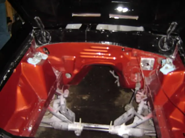

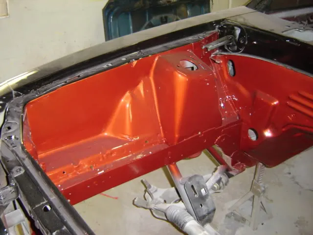

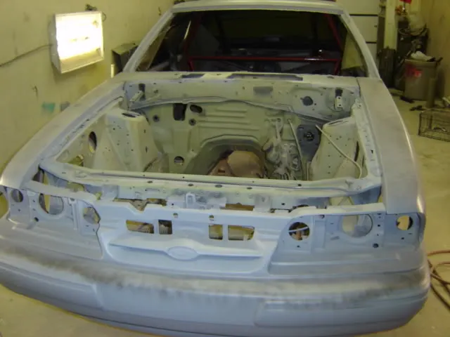

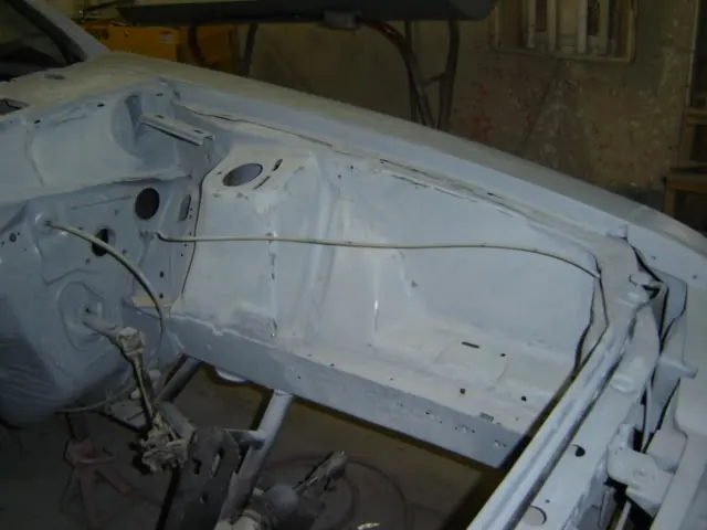

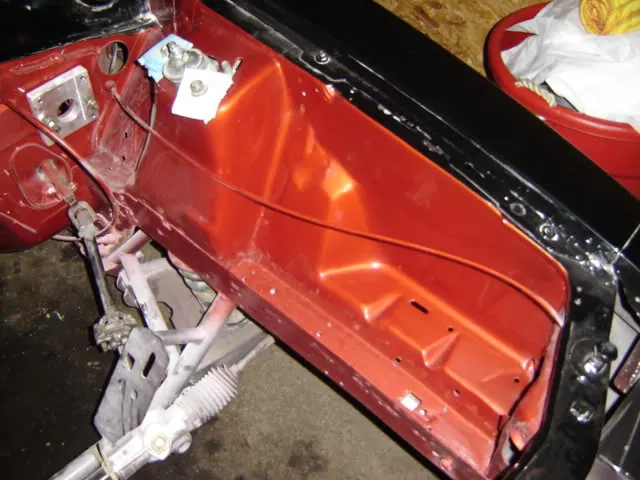

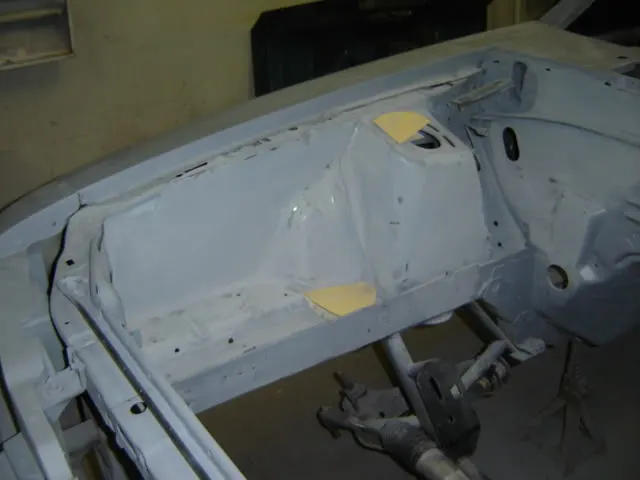

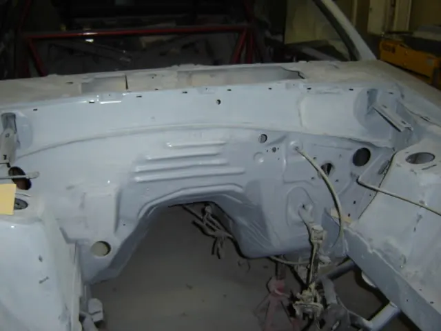

well my buddy did mine he also welded and filled every hole and painted the engine bay the same theme as the outside of the car was alot of work but well worth it....:D ENJOY

Just used a mig and filled the small holes, cut out plate with the plasma cutter (or you can use a cutting disc and a grinder) for the bigger holes and welded that in. I then used a product called all metal to start the smoothing process, few layers of that and sand between each layer, then my body man used skim coats of bondo for the final smooth.
Well worth it looks and style wise. espically if you plan on a battery re-location kit.
