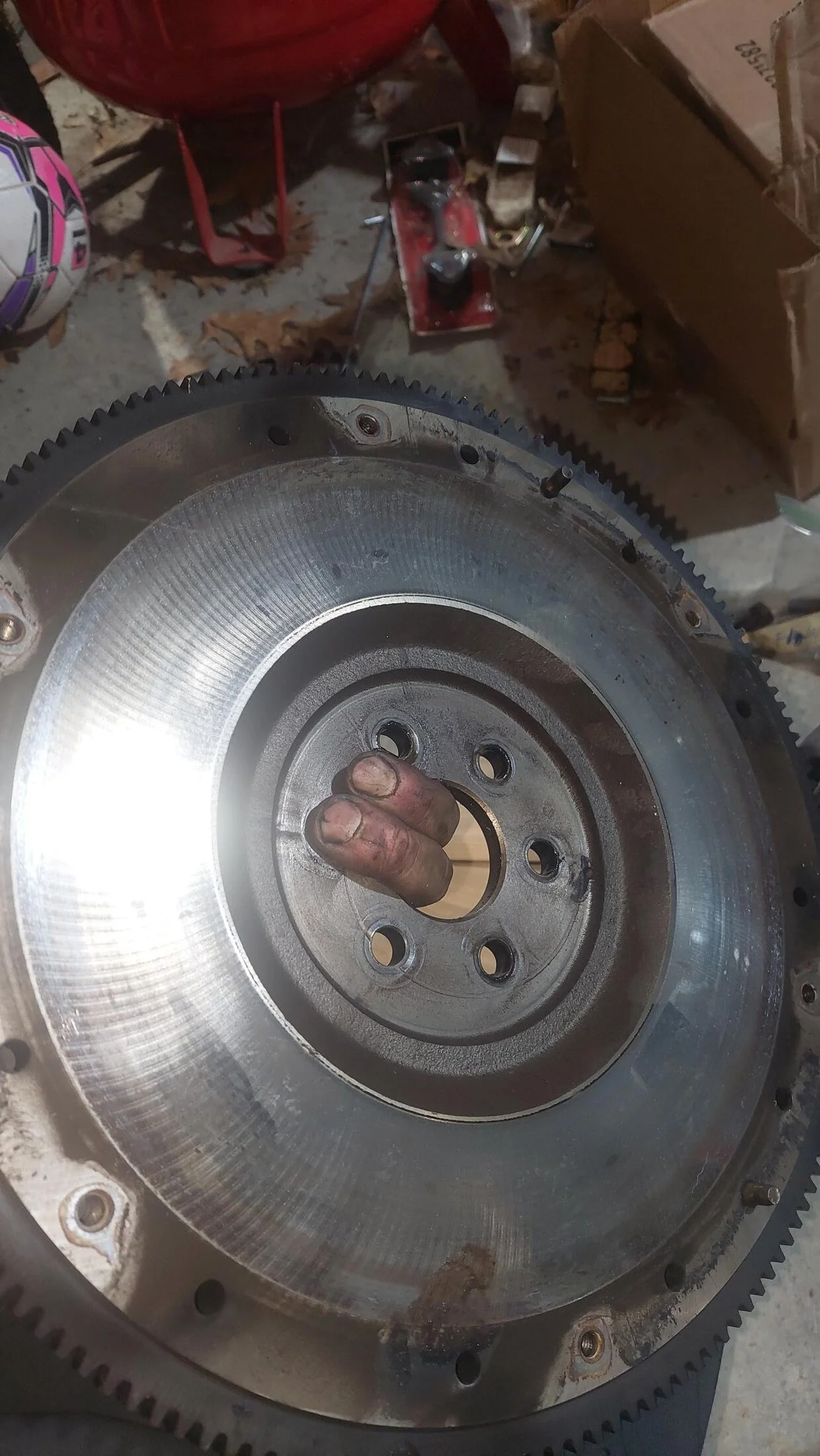

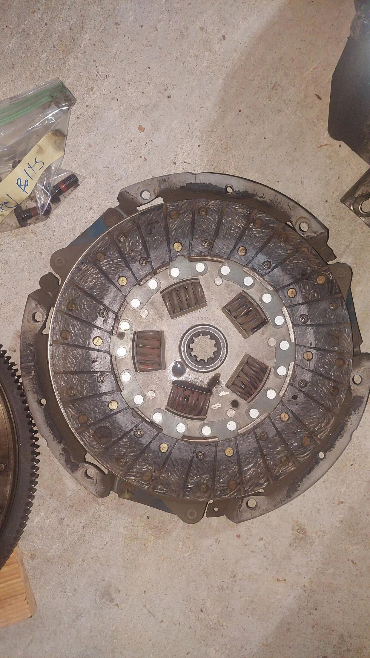

Is this a normal looking clutch or is it cooked? The transmission didn't slip, but the clutch paddle was really hard to push in.

What does the flywheel look like and what brand / model of clutch? Also, stock clutch quadrant or aftermarket?
Flywheel seemed fine to me. Not sure what brand clutch is. Stock clutch quadrant.

I would say the clutch disc is not getting full engagement. Looks like the outer part of the clutch is wearing more than the inner part which could be caused by the pressure plate but. Flywheel seems to show this as well.
The clutch type will dictate clutch pedal effort and having a stock quadrant will also create more effort than an aftermarket one. The clutch cable can also start to cut into the clutch cable sheath which will then increase the effort.
The surface of the flywheel just good as it appears it was done with a grinder and not a lathe. Couple of small hot spots but nothing I would worry about.

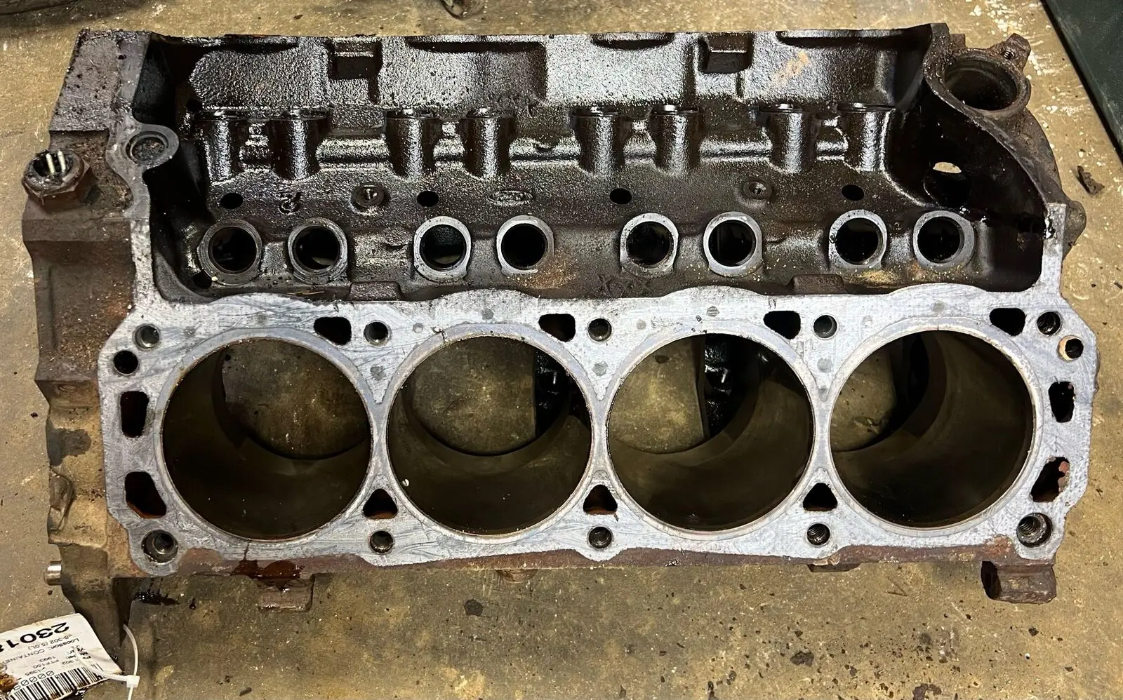

Moving along, was able to pull the old heads off yesterday. I wanted to ask what these passageways are that are blocked, and why you think they got blocked. I couldn't find anything on google.
You can see the carbon blocked holes at 12 o'clock, 11, 9.

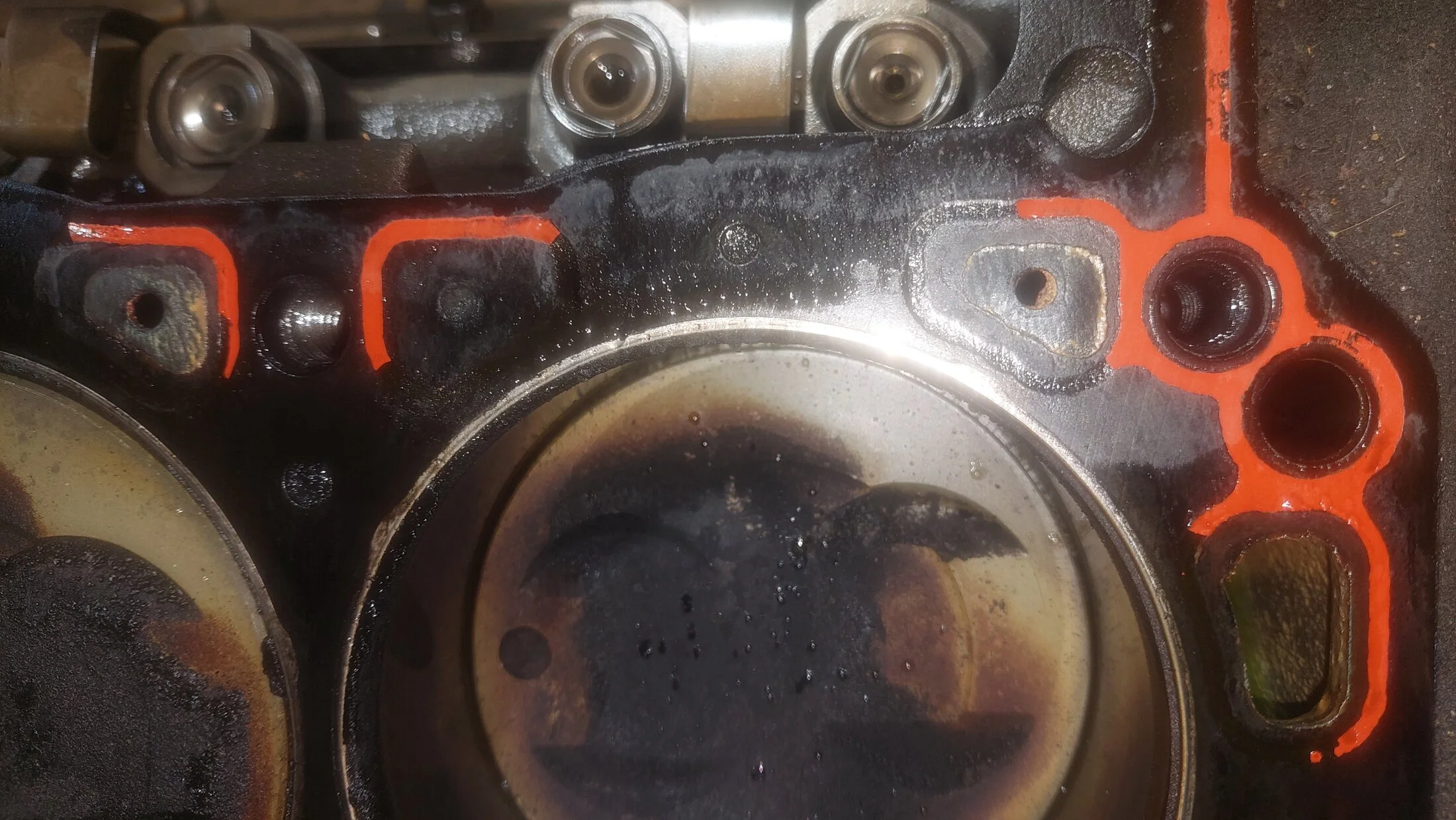

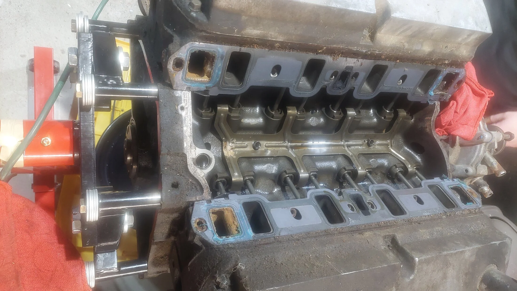

One more question. When I took off the lower intake manifold, the 2 first passages on the left side of the photo looked yellow. Is that the antifreeze mixing with oil? What would cause it?

So they are not blocked. Scrape the head gasket off and you will find that there are no holes in the block at these locations. Gaskets are meant to fit multiple years of blocks that may or may not have these holes. What you are seeing is rust which is common on high mile motors. This is what the deck looks like with the gasket removed. You can see the dots around the cylinders that you are talking about but they are just stains.
I would agree with you that oil has mixed with the coolant hence that color in the water passages.

How would coolant get to those ports since it's on the intake manifold? Head gasket gone bad?
