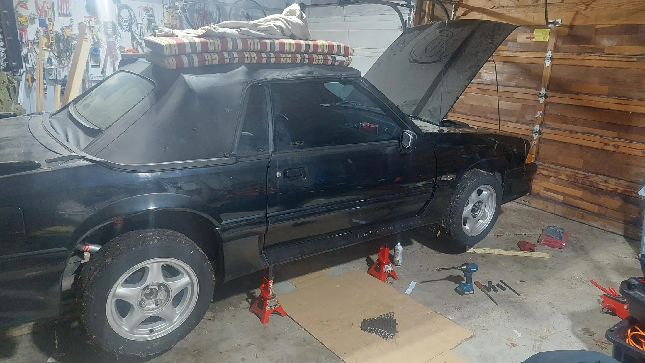

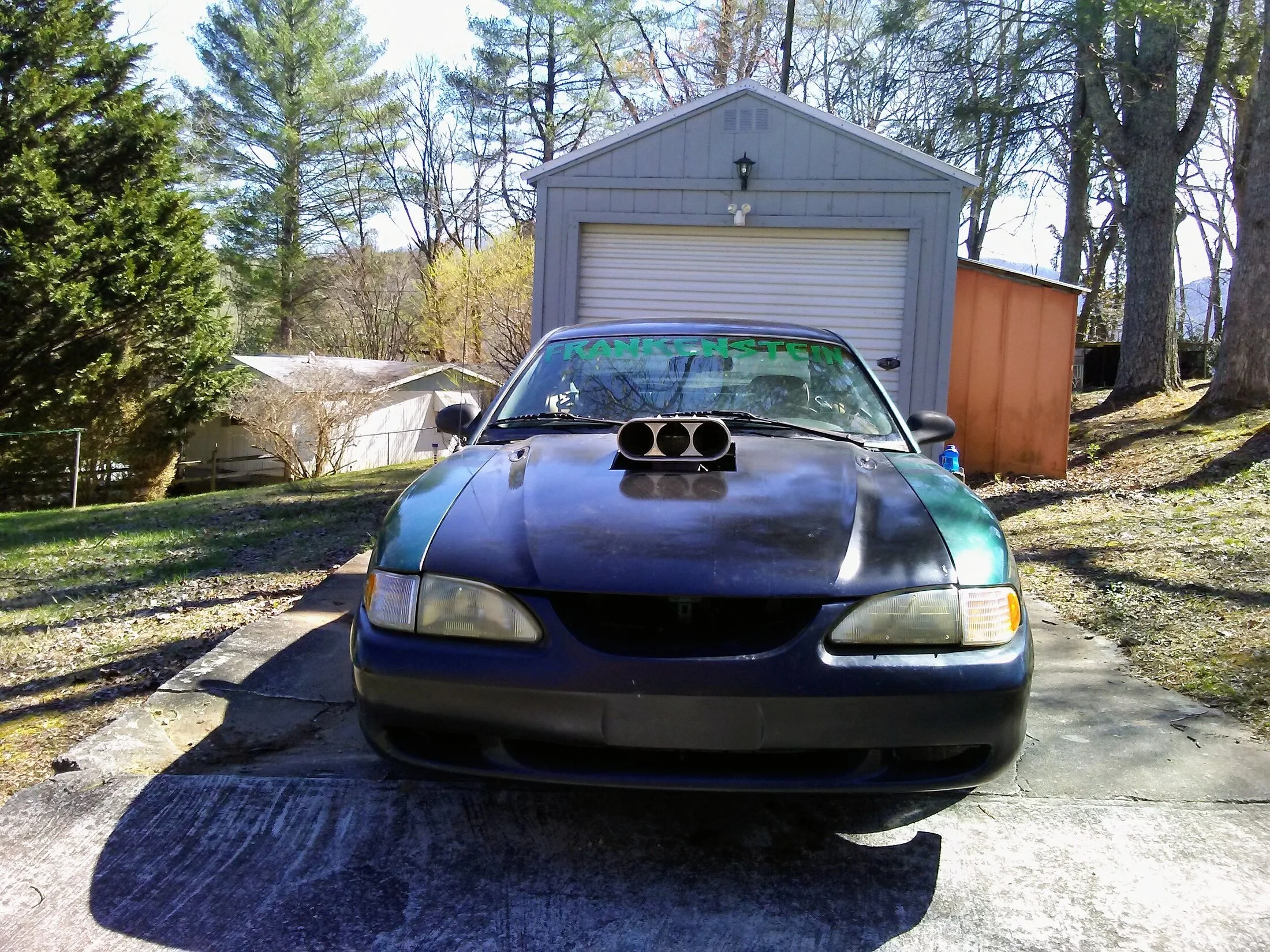

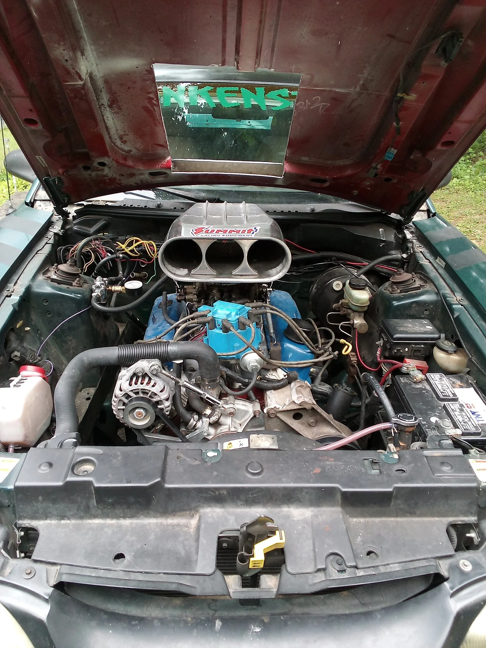

Thank you guys for your help so far. I'll have 1000 more questions, but to keep you guys coming back-- pic for motivation =D

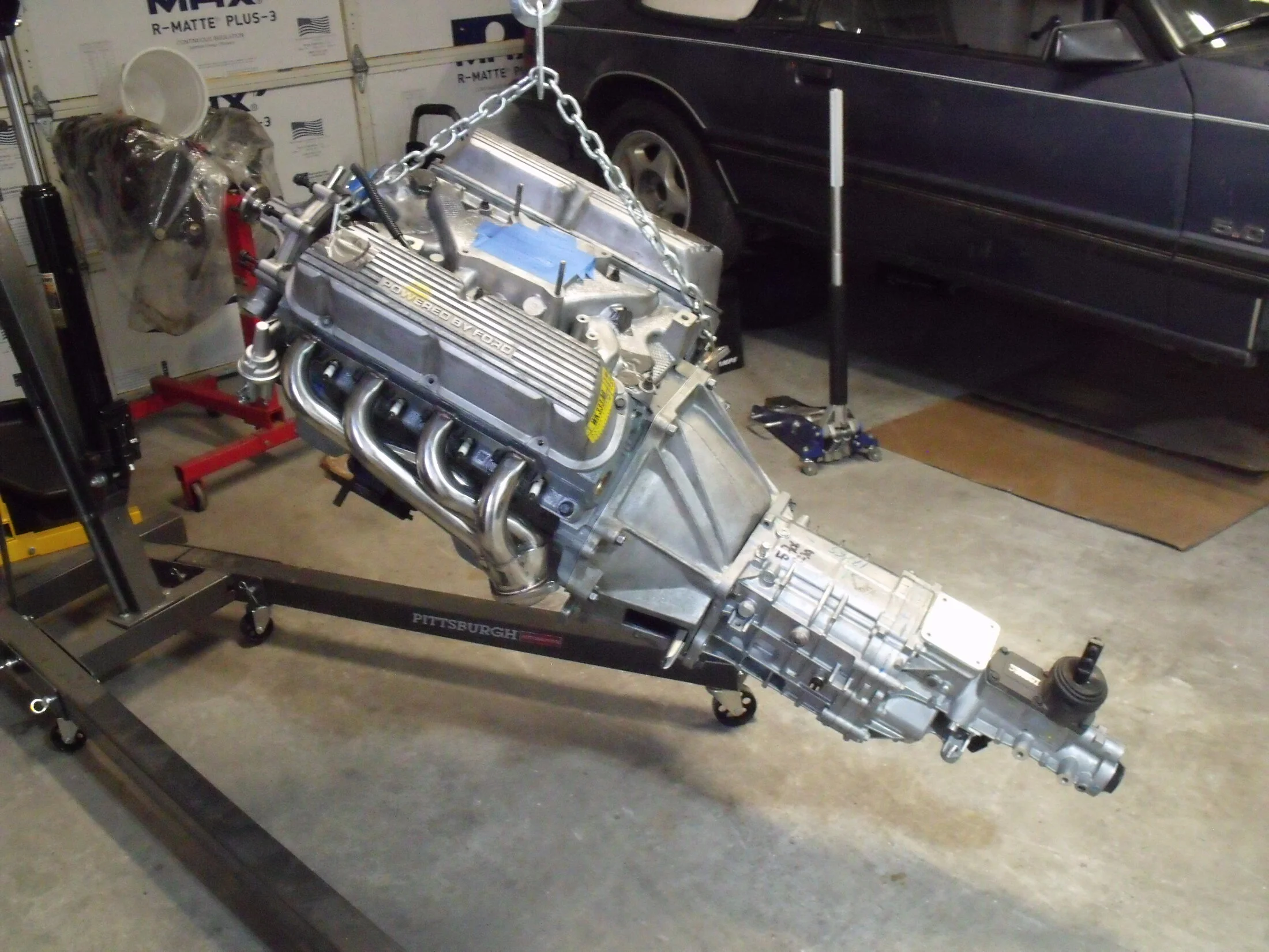

You don't have to go all the way with that build. It does use the stock heads though.

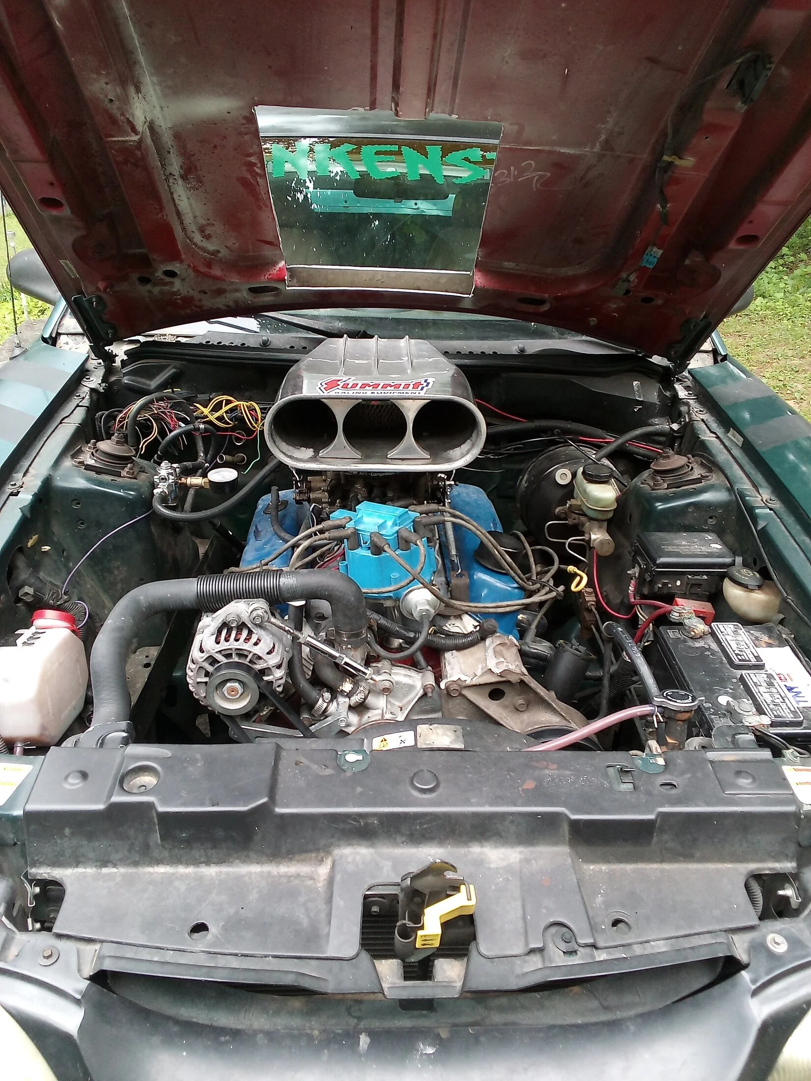

I went a little crazy and tweaked it.

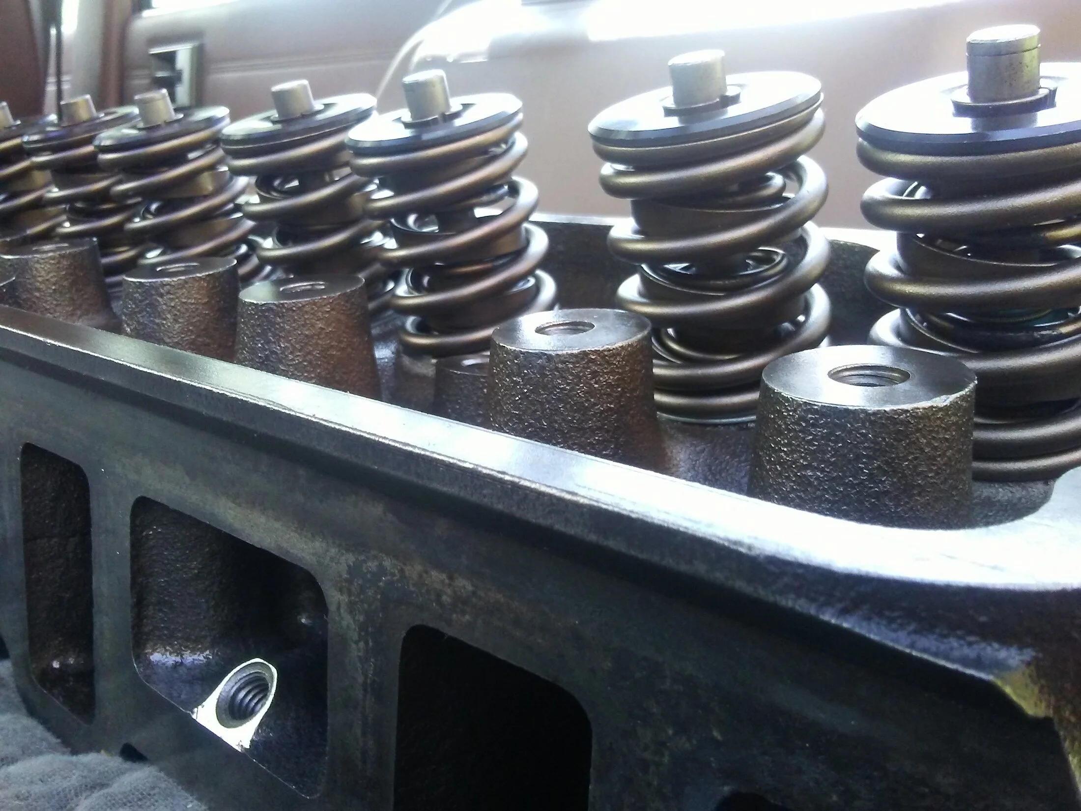

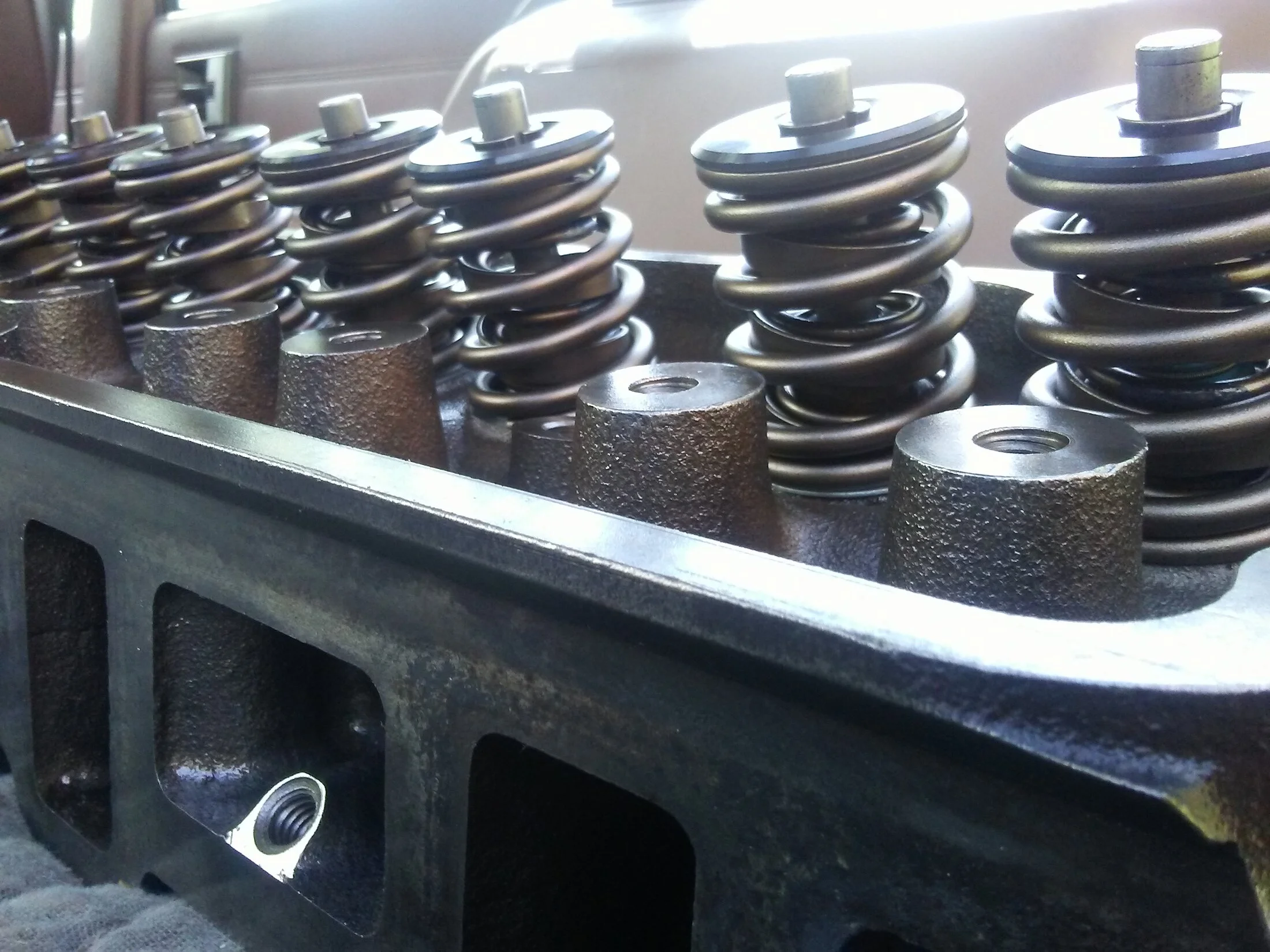

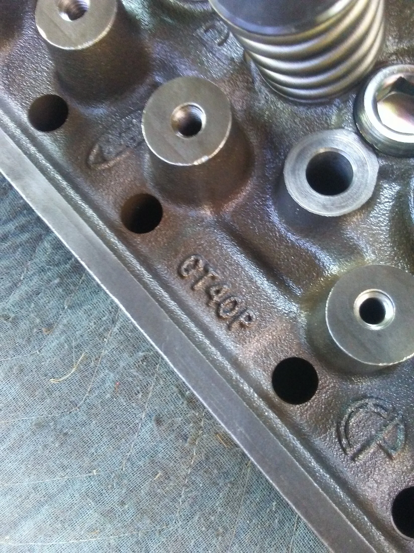

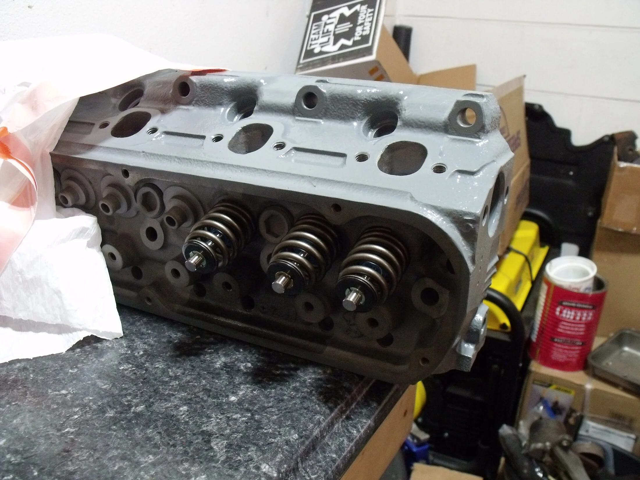

It doesn't take much to get the P heads ready. Plain them down and a little spring work.

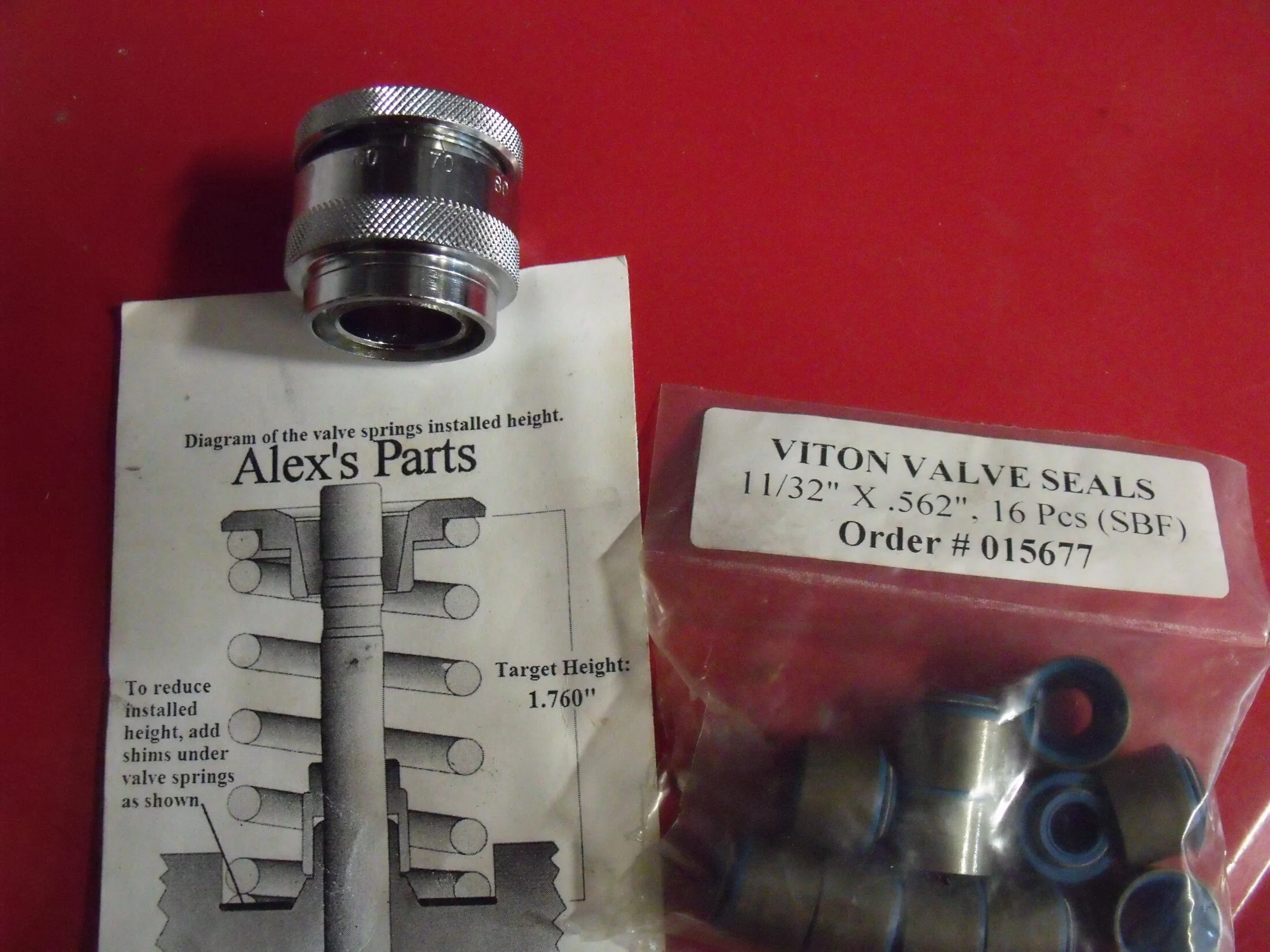

I purchased a complete "Explorer" engine from a wrecking yard for $400 with the P heads...
The heads were magged and " machined" by the Machine shop and included a simple valve grind ( No multi angle cut)
Purchased some new beehive springs, viton seals and new keepers from Alex's parts and assembled the heads my self in my garage..
Yes, I had to purchase a few new tools but it wasn't bad.. Thousands less than new " good " aluminum heads and I " think" its going to be a good little street car.... Second pic is the mic to adjust spring height with other parts from Alex's....
Reactions: JulianR

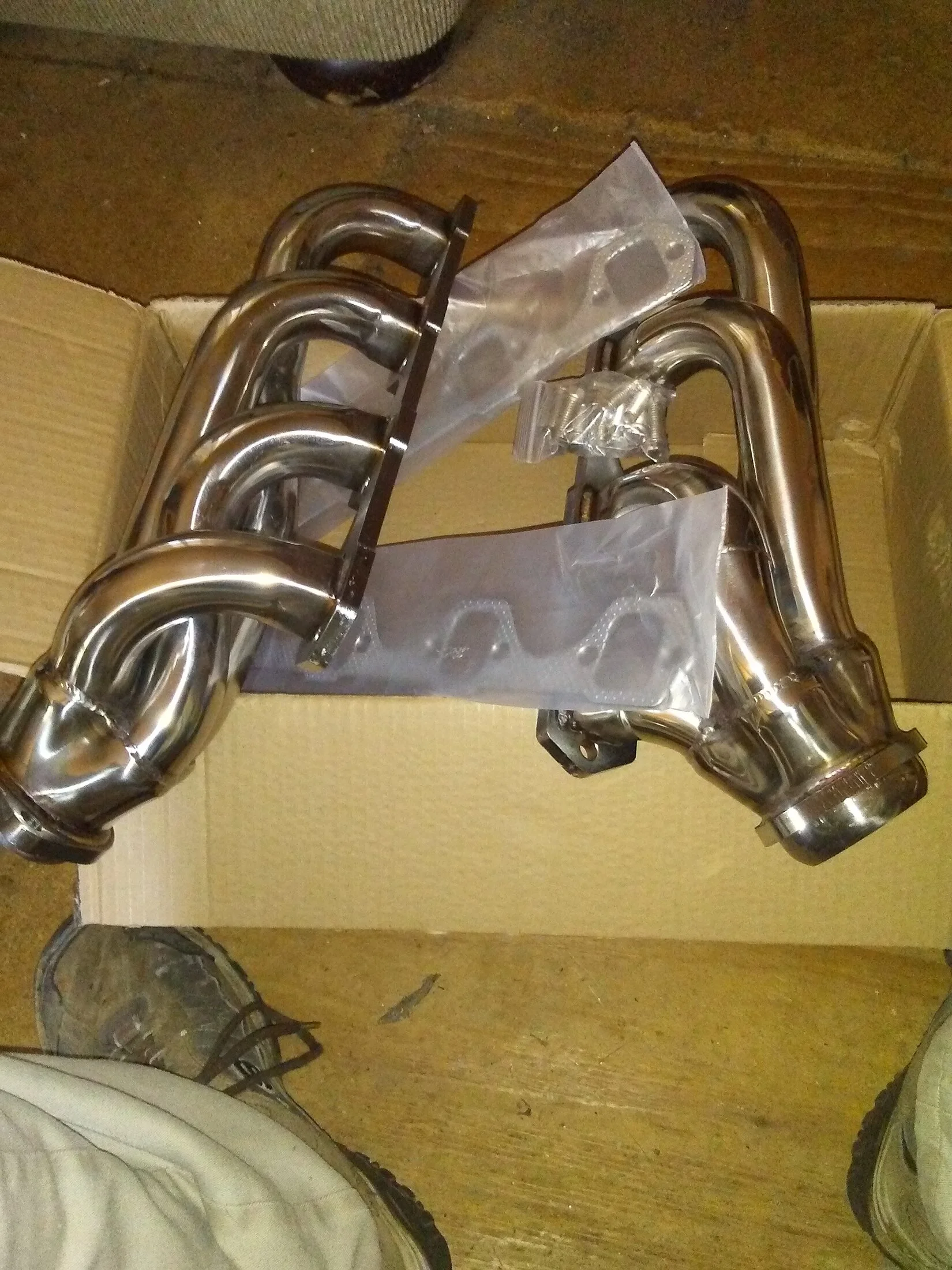

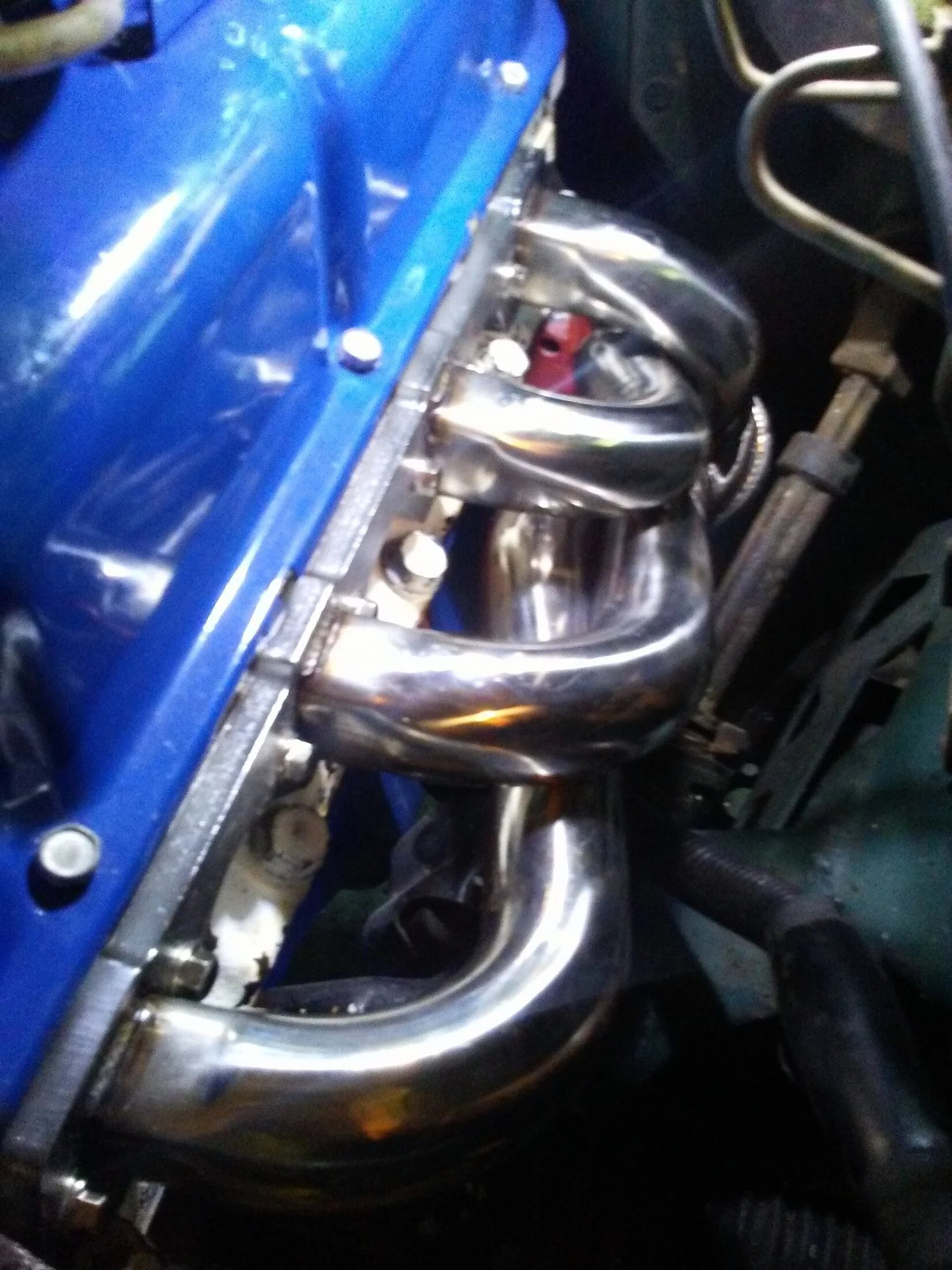

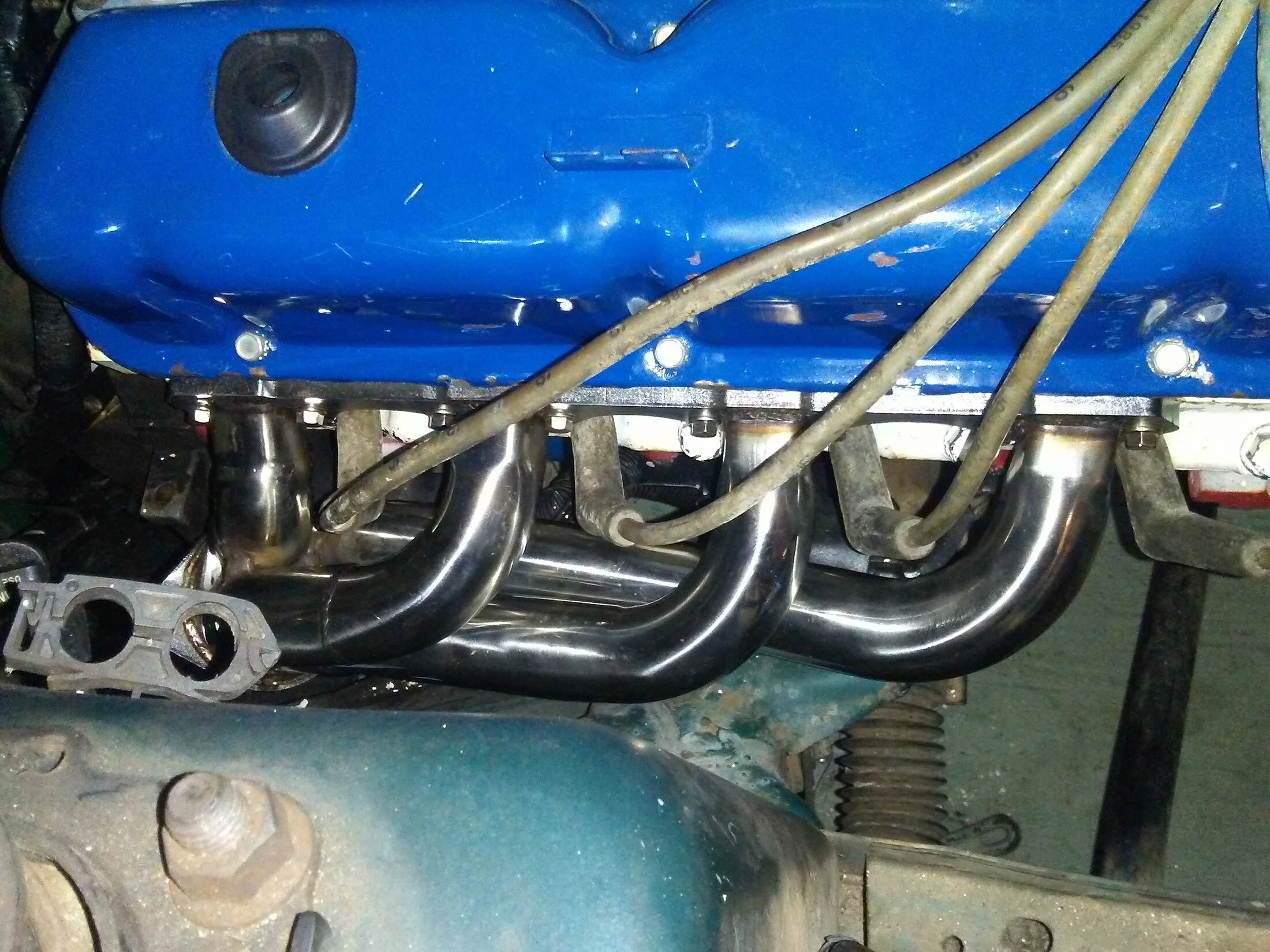

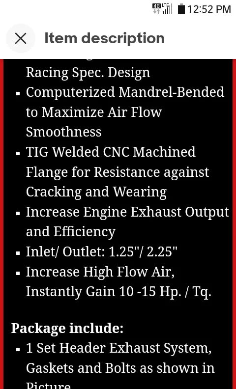

These are the shorty headers I found on Amazon for $81...
They were advertised as works on P heads and they did.. I did purchase the special spark plug socket from Trick Flow, designed for LS engines which made the few " hard to tighten" plugs no big deal.....
Since then I found some FRPP Headers and purchased them just because.. I wasn't even going to install them but out of curiosity one night I did...
Took me less than 1 hour to replace ( no exhaust system, headers only)
To be honest, the FRPP headers really were no better than the ching chong specials from Amazon for fit and finish..
The " problem " P heads have been pretty simple in my opinion to make work....
The spark plugs in my old 440 six pack Super Bee with stock exhausts were much harder to do than these......
I see they are just a single spring. My springs are matched to my cam. The machine shop wanted to get the specs for cam to get proper spring strength.

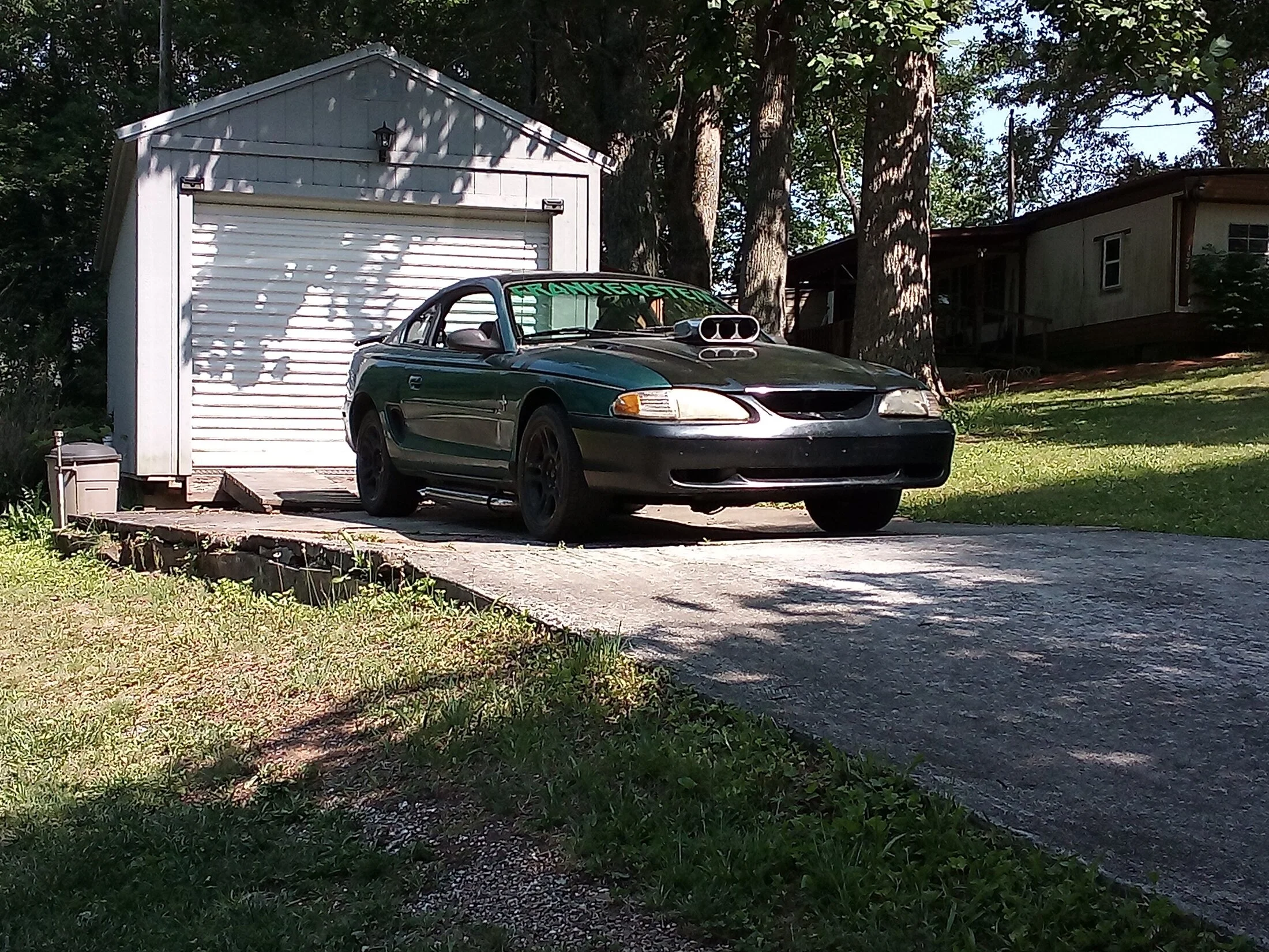

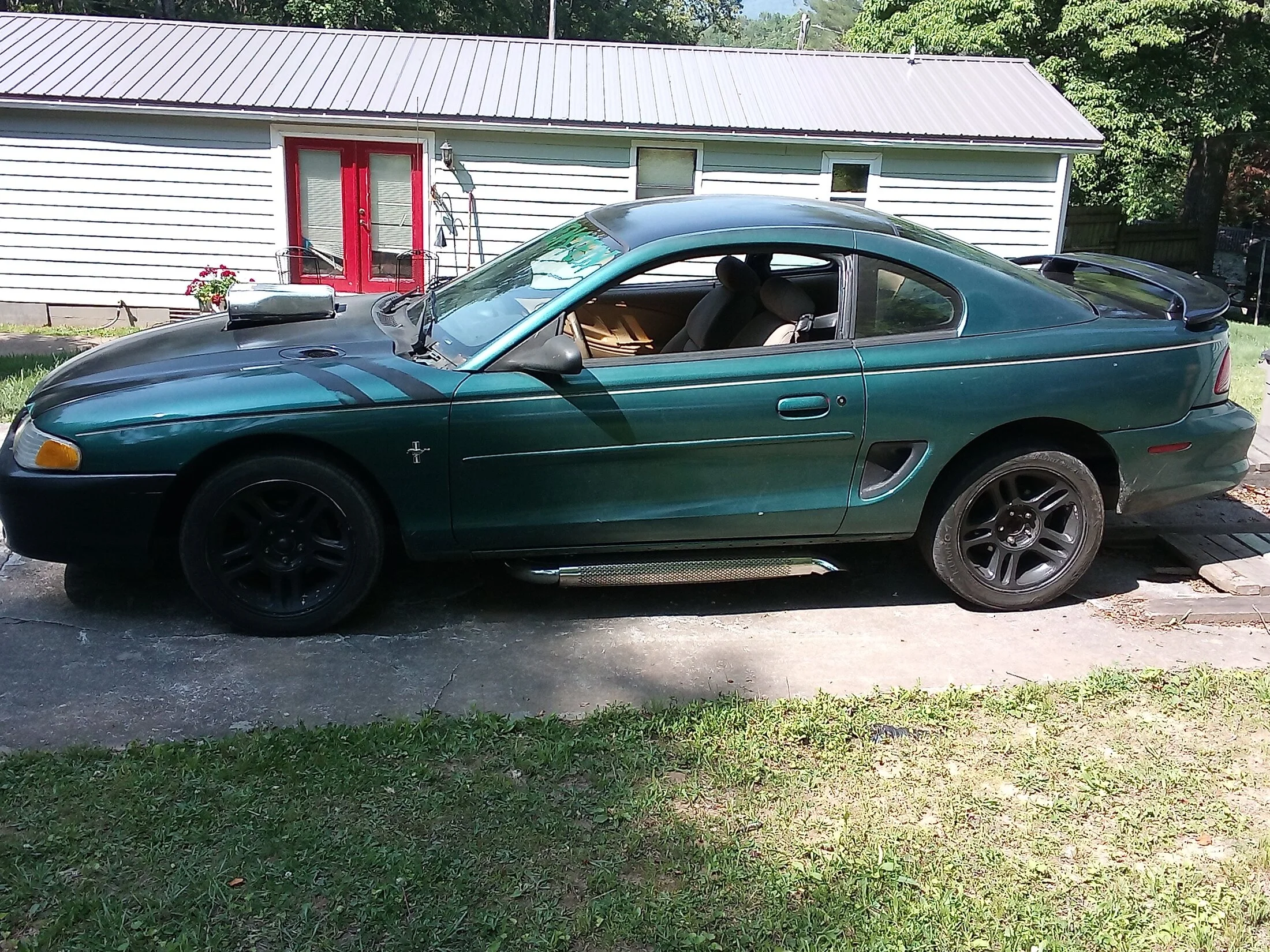

I'm not running a big cam. I went for the duration of cam for a street car. Seeing I'm running 273 gears Frankenstein is very fast off the line. My 0-60 is in the 5 second range. 1st gear will do 60 mph itself.

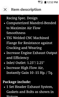

You found same ones I did off eBay. They work perfectly with my side pipes.
