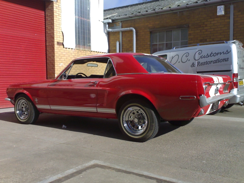

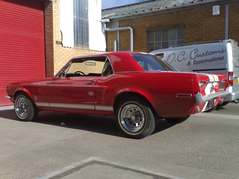

Just picked up this '68 Coupe for my girlfriend

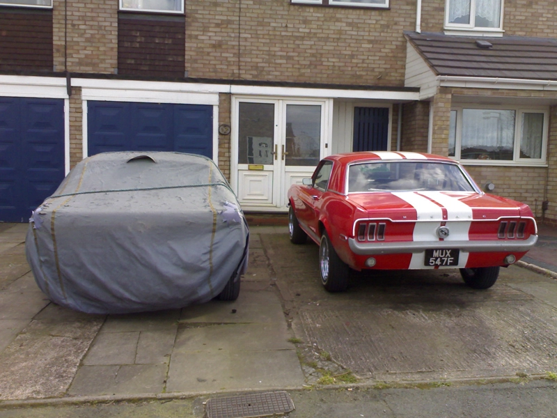

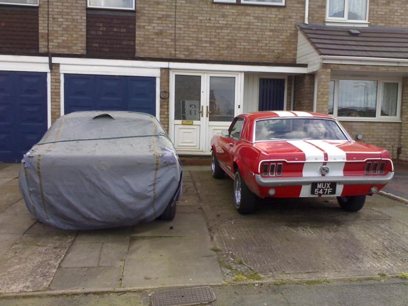

Also got the '70 Coupe under the cover
The '68 is running a 200 Straight 6 & the '70 has the 302 V8. When fuel costs as much as it does over here you're screwed anyway so might as well make it an 8 View attachment 395896
