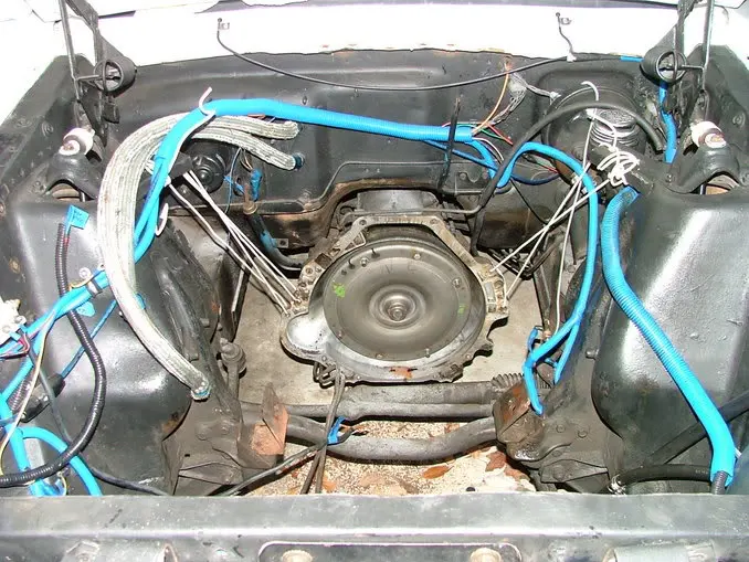

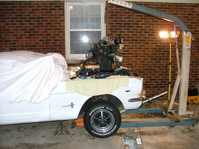

well i've made a couple of post about removal and such and wanted to keep you all informed. Well, this picture shows it all!
it came out fairly easy, once we found that mystery bolt that was still holding it on lol.

I'd rather pull the trans with the engine.. alot easier to bolt the trans to the engine out of the car.. to me anyway..

I did my first engine pull recently and i was a one man show. Came out really easy - I chose to do the tranny and engine all in 1 pull. After everything was unbolted, it took about 30 mins to pull it all out. Pump a little, check for clearance, pump a little, move hoist, check for clearance. Over and over again...
