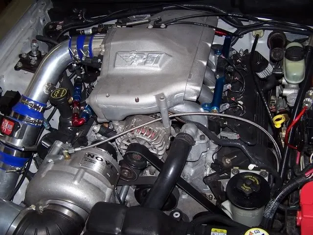

if you are going FI you should go with the 262s if staying NA go with the 270s. as for the intake, stay the hell away from the typhoon intake. they are crap. do a google search and you will see what iam talking about. some have had issues with getting it to seel up and one guy i know of had coolant spraying from a pin hole in the coolant crossover. I personally would go with the hps hardballer intake. I have yet to find anything on the net bad about it. plus it has plenty of extra material for porting.
back when it was all new again!!!
Texas Hotrods sells the THR Harballer intake. I personally am waiting for the one from BBK. I have been pretty impressed w/ their stuff and like the idea behind the 5.0 intake they make. I am NOT bad mouthing the Harballer at all(I used to want that one) but, there are people on a few forums who have had bad experiences w/ Texas Hotrods. I havent seen any hard numbers on the Harballer but, I think the intake itself is good. I havent had any experiences w/ Texas Hotrods personally.
