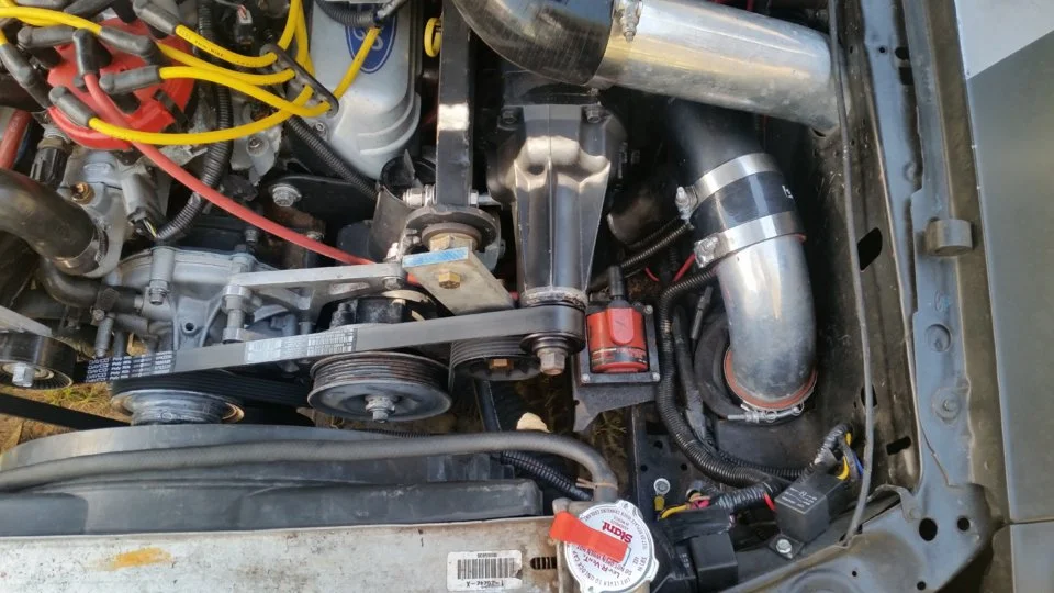

I am currently working on a different way to mount the extra idler arm and some extra pulley. The problem I'm having is the bracket that originally made for the supercharger has a lot of deflection. The aftermarket March accessory brackets are making it difficult they take up all of the usable mounting locations. Really my only decent option is to start over from scratch or at least very close to it while the system works the way it is now it is very ugly I proved that it can work but now I want it to look half too

Pics of ugly set up?

Man.... tough crowd.
this works but must go. I have a thick sheet of aluminum I would like to make a plate with for the pulley mount, then do away with the bar coming off the SC plate.

Meh, just paint it all black
