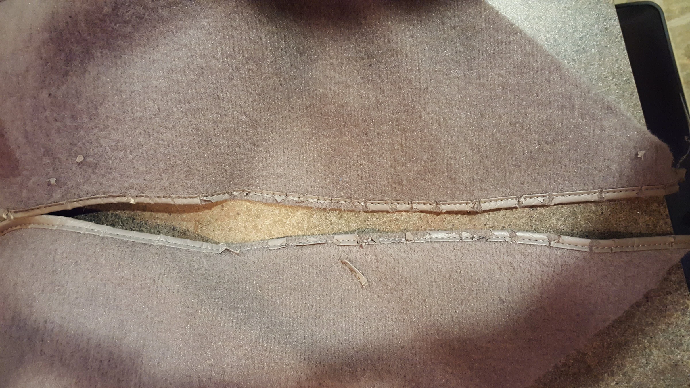

The washer really got the carpet clean.... but it disintegrated the piping around the outer edge...
luckily this piece is not highly visible with the box and front seats in place....
Soo..... @Davedacarpainter what do I use to dye it? Adhesion promoter then viynal dye?....... or should I wrap it in felt?....(probably not huh)
I hadn't really researched carpets that much since i got new ones for both of mine. I've heard any of the interior dyes or paints work decently. If it's made from a nylon thread, then an adhesion promoter would be a good idea.
Once the paint/dye dries, brush your carpet. That will soften it back up.

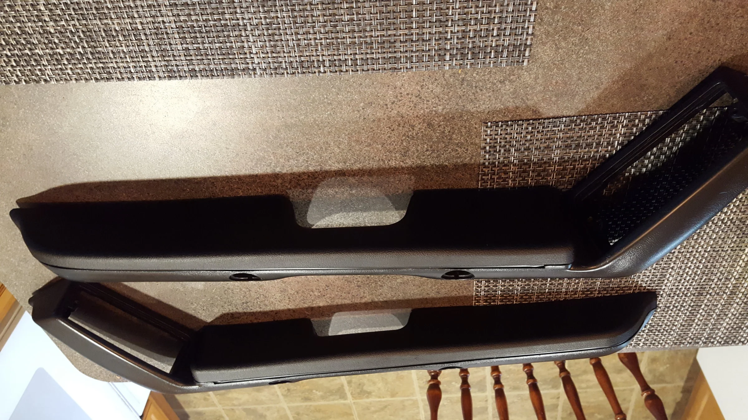

I got to repainting after that, I prepped and used adhesion promoter this time, the paint adhered better but will still come off with a hard scrape from a fingernail.... Oh well I'm done messing with it, they will have to do.
the new pads look great against the fresh paint, I do have one complaint though. The screws sent for the armrest pads do not match the ones off the old pads, the new ones are literally 1 1/8" drywall screws. I went and grabbed some from the shed just to compare them.... I'm a bit disappointed with that as they don't seem to grab the pad well...

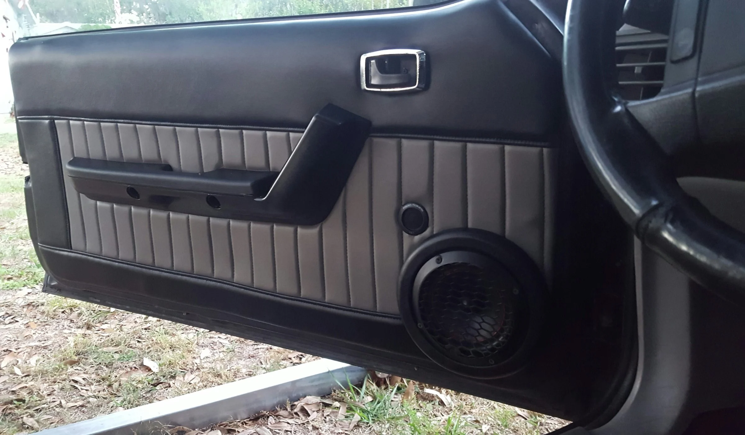

I was also able to get the speakers for the front all wired up and the crossovers into place. What a pain in the Ass that was, trying to tuck wires and crossovers up out of the way so they won't become problems themselves.
