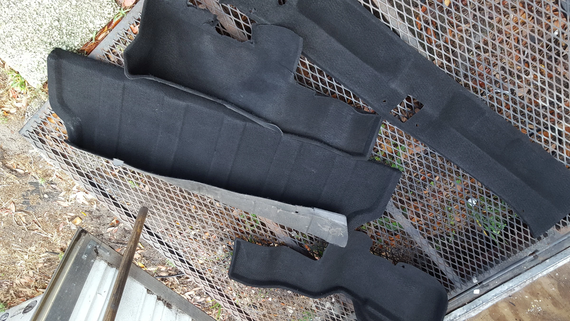

Took me 2 JY and 4cars to find all these pieces. After a good cleaning they got the adhesion promoter and black dye treatment. This works out great, they will match the black felt I will use for the amp rack.

The AGM batteries are spiral core and are designed for the spirals to fall as the battery ages. Putting them on their side would hinder that process.
Good score at the JY... I had a couple of those parts laying around...but you beat me to it.
Let me know if there are any other parts you need....I can throw them in a box with the cover if I have'em.

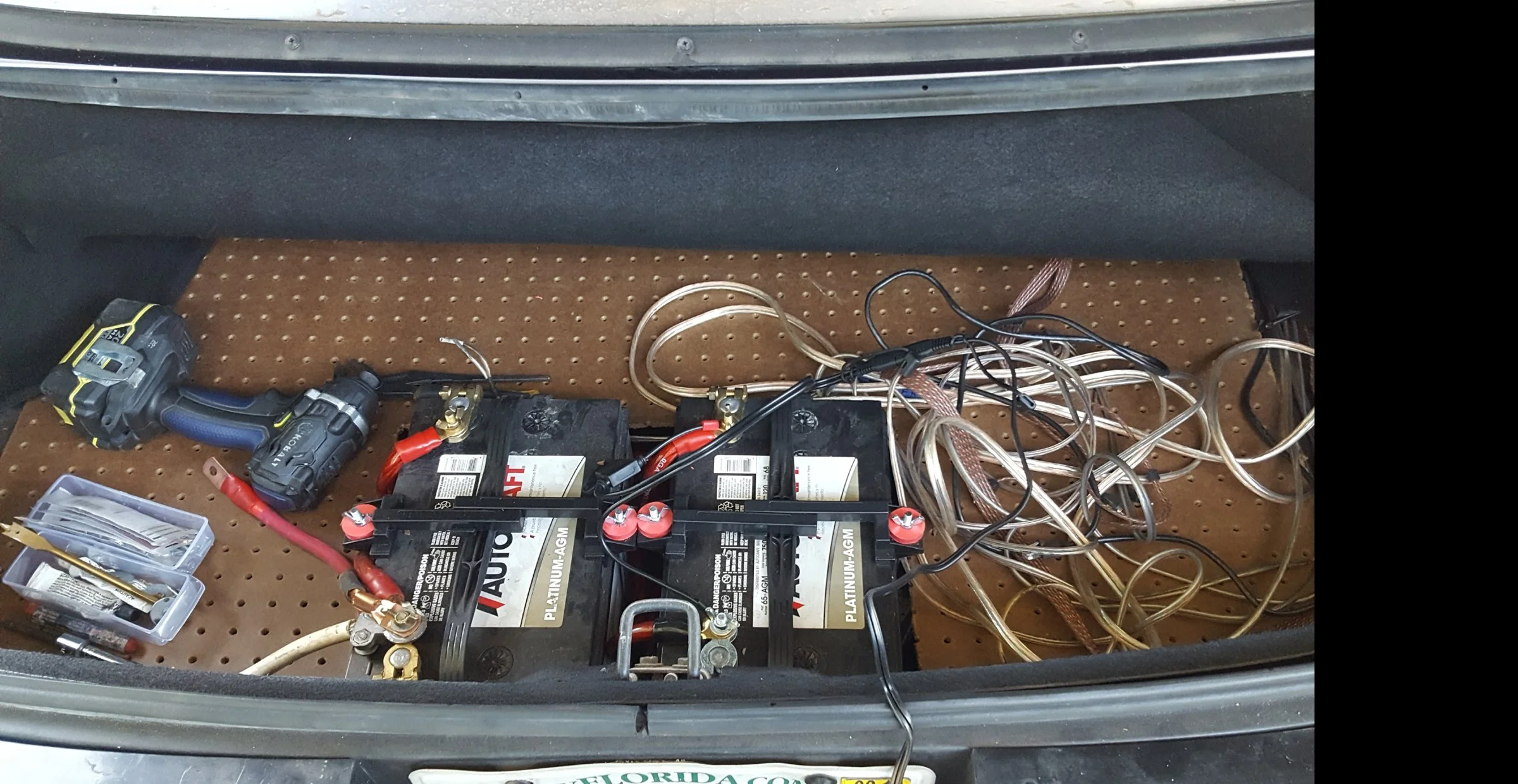

I need to go get some of those plastic push clips, the ones I pulled out are destroyed.
I usually keep more beer next to my beer.. I have to get ready for work..
I used a piece of peg board to make the first "floor" to cover the negative space in the remaining spare tire area. I was able to get the batteries mounted but need to modify them a bit, I want more beefy. I will end up covering the batteries with the factory carpet, I may slit it so that I can tuck it into the space around them. Once the amps get mounted and wired and all my fuses/circuit breakers for the main power get installed I will cover the whole lot with a false floor made from MDF and covered in the black felt.
Where I got to today..... don't mind the white cable it's going away, I just needed to move the car. Reminds me I need to pick up more cable ends for 1/0 welding cable.

The spare tire well looks like the perfect place for batteries. How far do they sit up out of the well ?

With the post style terminals, maybe 4-5 inches. I will measure them and let you know when I get a chance to work on it again.

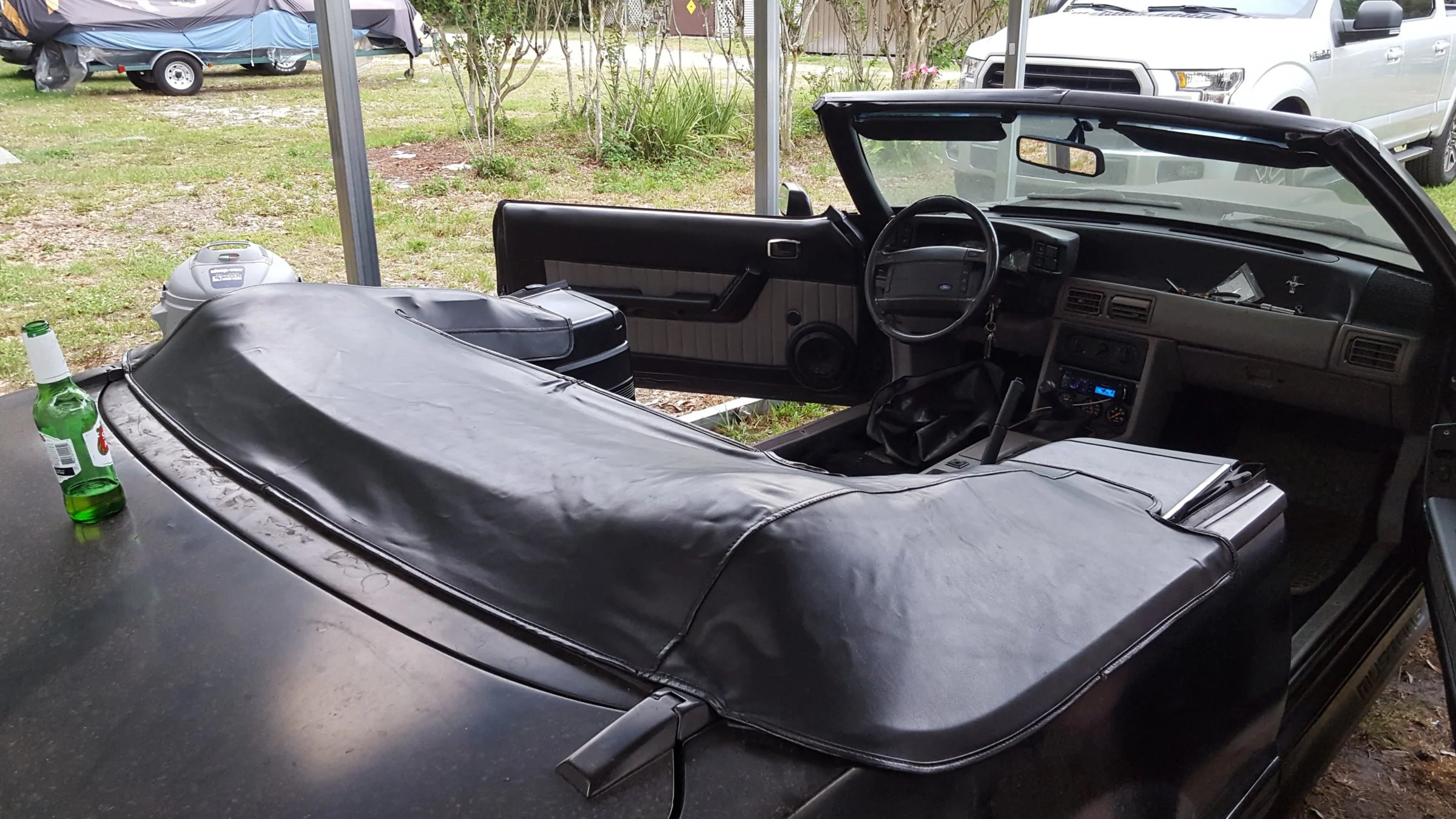

I just want to give a shout out to Scott @90sickfox a big thank you for the convertible top cover. It came in yesterday I will get some pics of it on the car hopefully this afternoon.

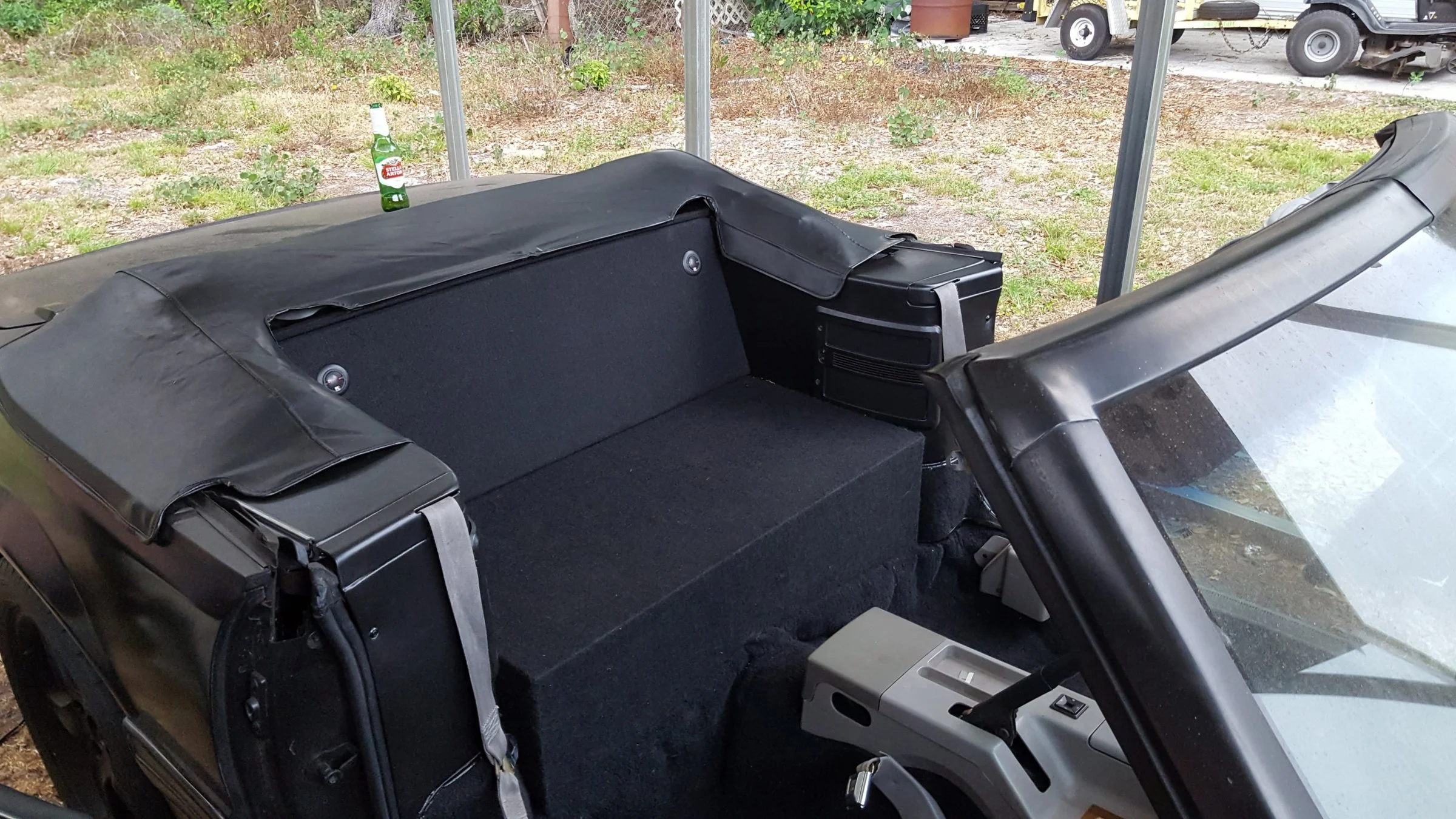

@90sickfox
Thanks man thing looks great!
