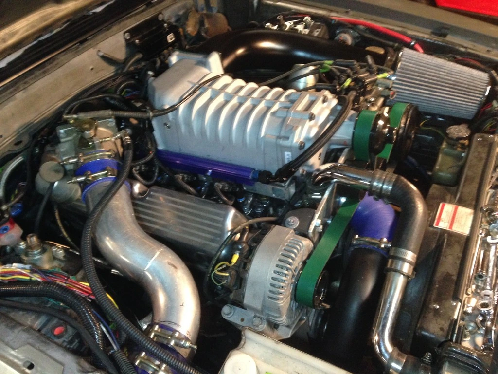

I will hopefully have a vortech bracket assembly here soon. This will make mounting the alternator down low very easy, along with making any extra pulleys simple to mount.
I'm normally very cheap and try to make everything myself, however this time I am going to learn from my past mistakes. If I pay myself 25$an hour labor plus materials I could build my own setup for around 300$ (R&D takes time) or I can buy the bracket assembly used for 250$..... well my time these days is at a premium I have multiple home improvement projects going on. I think it's worth it, not to mention it will look much more finished this way.
I am also considering making use of the area above the intake manifold... make a tray for a panel filter to feed the TB put it in a second larger tray with weep holes so water can escape. This would mate to the bottom of the hood with a foam surround. Making use of the cowl and the hood scoop would be nice, however it's all dependent on the space available.
Would be cool though.

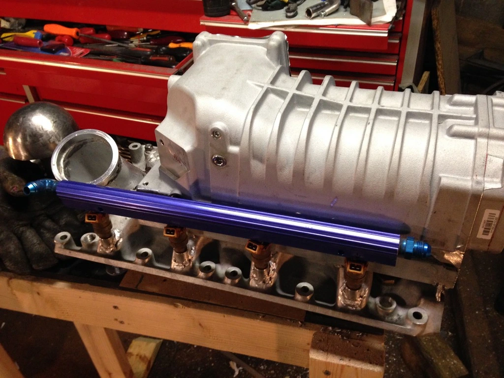

Fwiw, I still think milling down a cheap efi intake into just a big plenum with an adapter plate for the charger (and a distributorless ignition with a cam sync) would be the best way, but I also have machine shop access so my opinion may be skewed.

That is still an option I am considering. I already have an intake picked out to do it with. The only foly is the blower itself i need a unit that originally bolted to an intake manifold or it overcomplicates things.
My "shop" is a tool shed the car sits under a carport if I had the room and money for even a hand crank mill I think I could "easily" make it work. For now i am going with a KB style solution.
I read the stuff on the pizzano method and it looks amazing great stuff there.

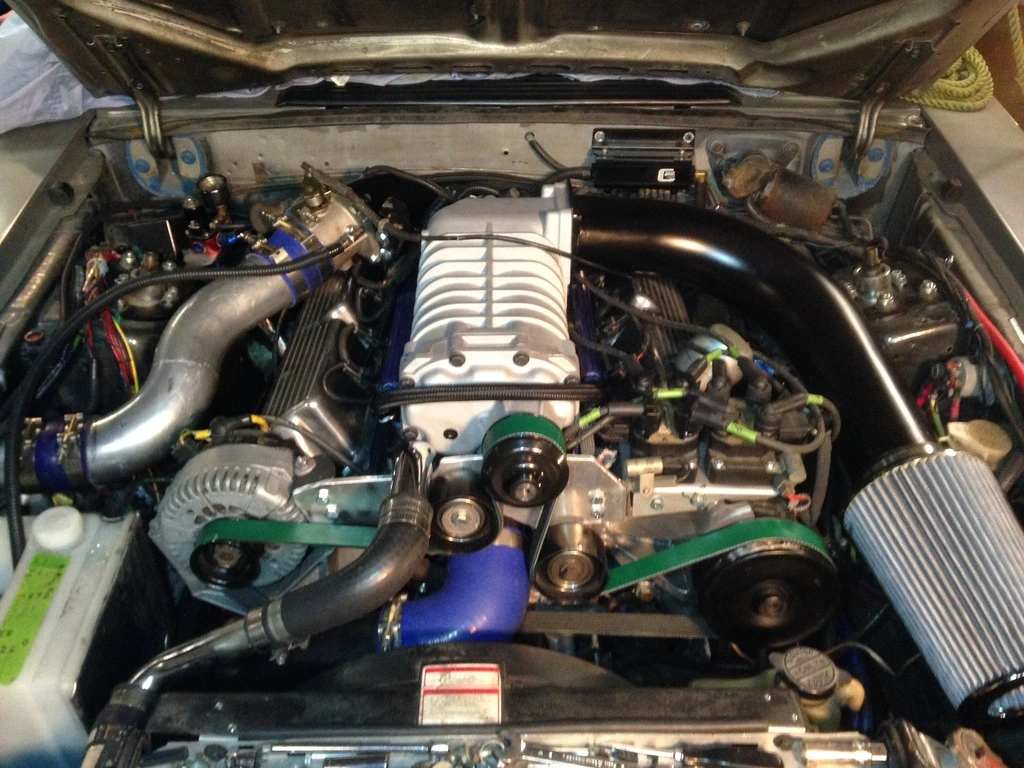

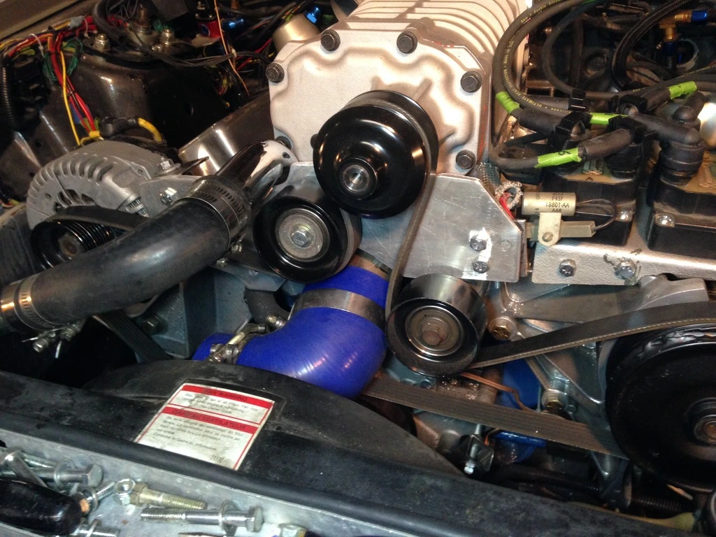

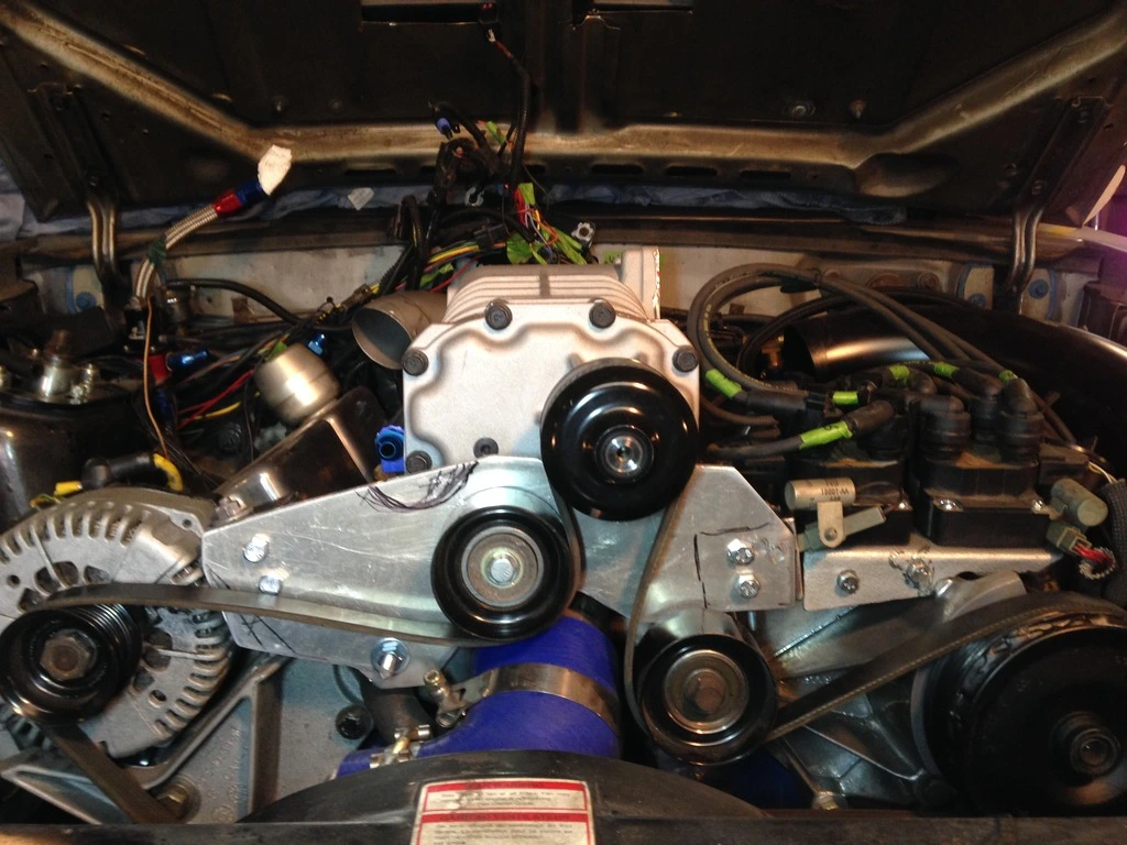

Well I have a very small update for you, I mounted the parts I got from @karthief. They look good but I got caught in the rain and had to stop short of the ps pump.
Reactions: RaggedGT, mikestang63, 90sickfox and 1 other person

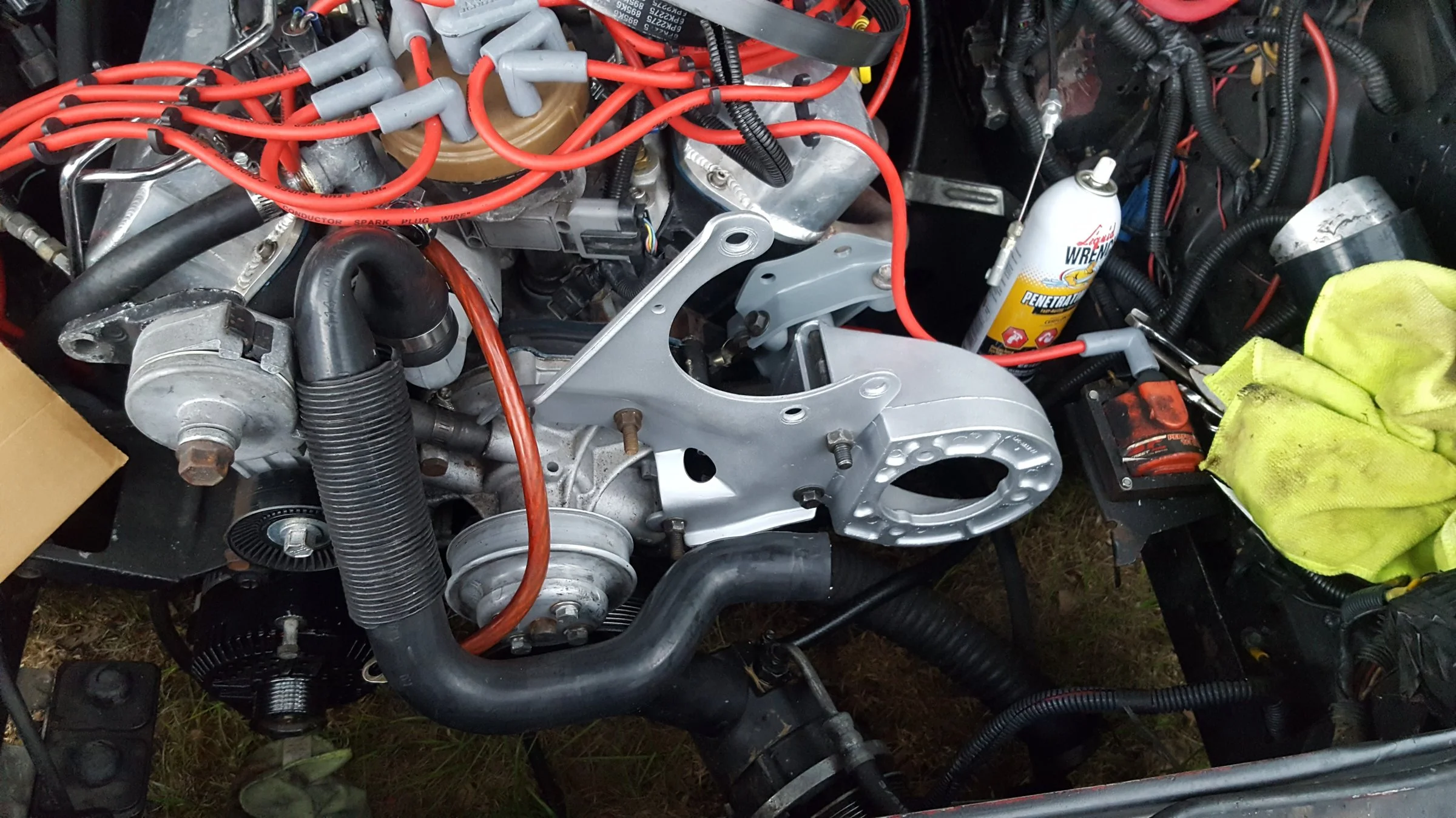

I hope to Christ that you haven't started off on some tangent trying to make that blower fit...
Because I found an instruction booklet for you....
Now this guy isn't making very much boost with this combo,..(like 4 pounds) but he is a gluin' screwin', and doin' kinda guy just like you and me...If he can do it, you can do it.
He's using EDIS, and MSII.
The previous version of this had a turbocharger in the back seat,..(be he decided that wasn't the best plan)
and put this M122? on the car. He is forcing the air to go over the river, and through the woods only to return to a little hole at the back of the manifold. (that goofy looking tube thingy). You are planning to direct feed the engine so all of that crazy piping will be un-necessary. He used a carb'd Offenhauser 360 intake single plane manifold,...(I could so make this work)
The snout on his blower looks waaay shorter than yours is though...might not be a problem though, IDK.

He is also using the explorer or sn95 front dress to pull the belt in closer. There is no way I would make as much of a mess as to glue and hope it held. But he made it work gotta give him that. I like the way he made it intercooler.
I ready have an intake picked out Mike for the when and if I decide to go this route. I'm still collecting parts, but I guess I don't need the vortec bracket if I do it this way.
Only cevat is the way my blower is designed, it's meant to have a hat bolted to it. Gonna be some extra work to make it work.

MIke, I gotta give the guy an A+ for ingenuity and effort..but those welds and it looks like he used Honda Bond... Did that all hold up under boost?

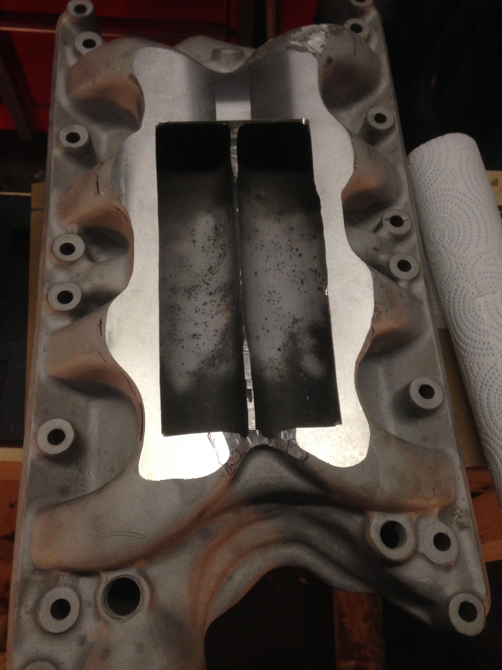

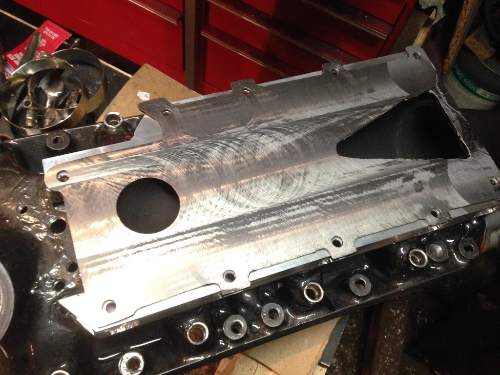

It just made sense to me that here is a single plane intake w/ it's top milled off. You make a 3/8" thick aluminum plate that matches the base of the blower, and "affix" it to the intake. If it were Mike doing it, he'd counter sink some kind of fastener into that plate, and glue it to the intake manifold base. Then mount the huffer onto the plate w/ bolts. It looks so easy to me that the only thing harder than that would require finding a log to fall off of.
I glued the fuel rails on the 363 that had 16 injectors that I drag raced in 06 that had the 95mm meth fueled turbo. It saw 35 p.s.i., and those rails didn't pop off. There is some really nasty stuff out there as far as glue goes,....Granted I didn't use JB on those fuel rails,..(MOF, I used some GE aerospace sourced stuff that cost 250.00 a pint),....Once the test piece was glued onto a piece of scrap that I had on my work bench, I could not beat the two pieces back apart. I figured that a 5 pound mallet at full swing was sufficient force to replicate 40 pounds of boost.
