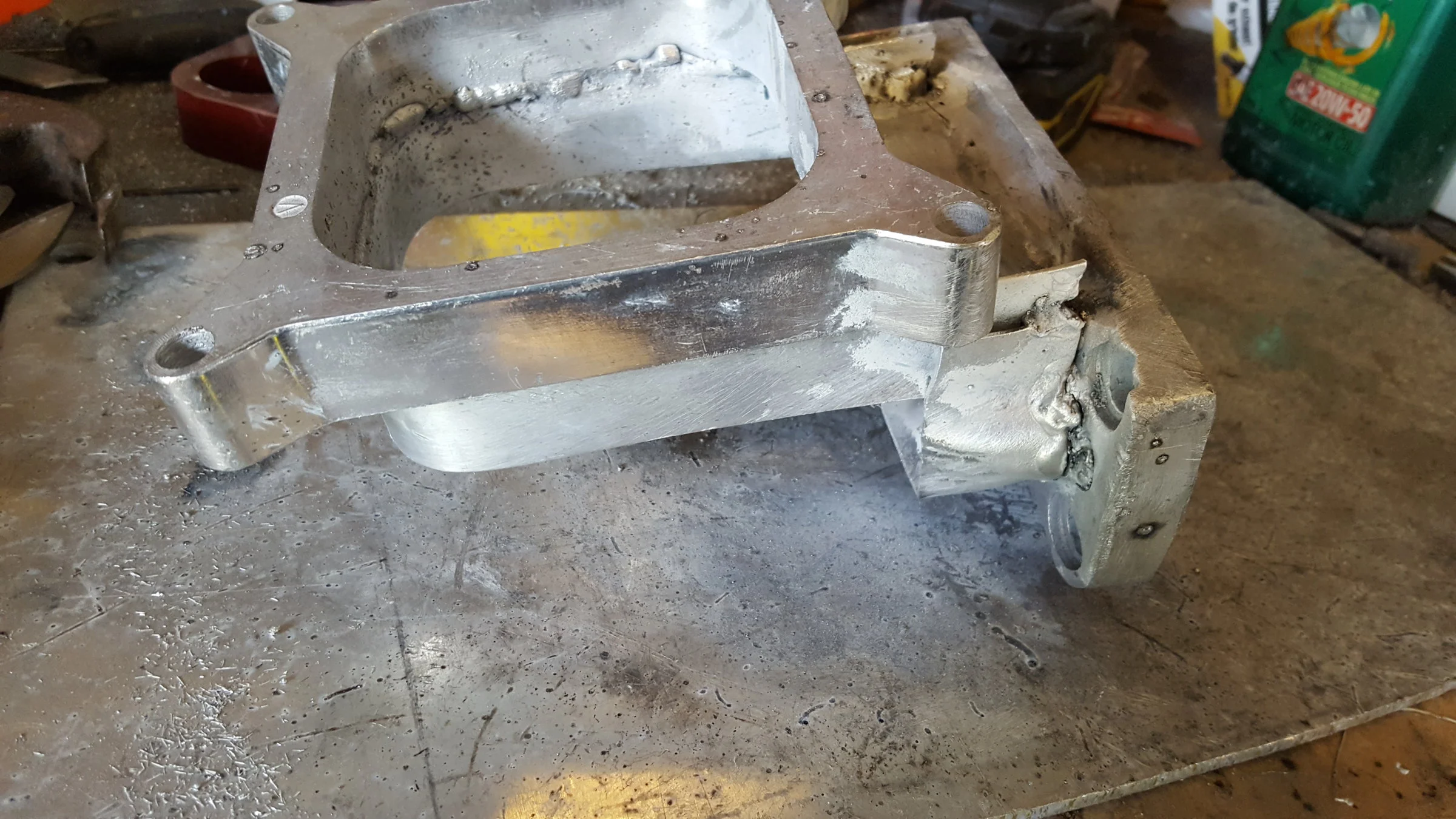

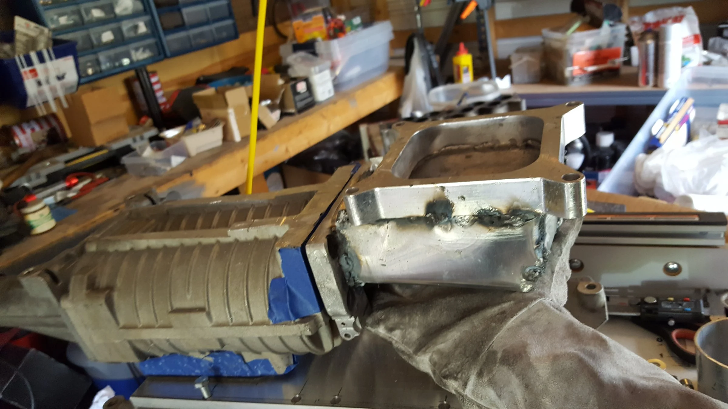

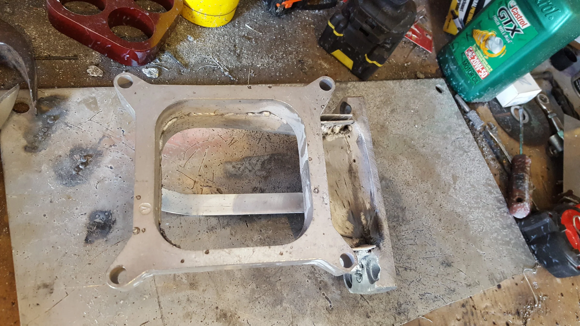

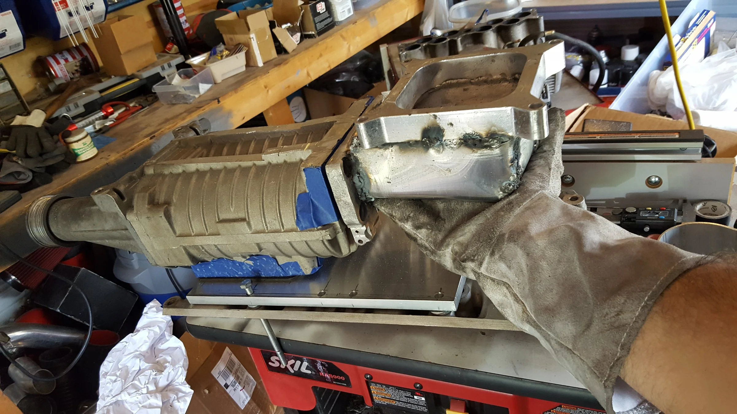

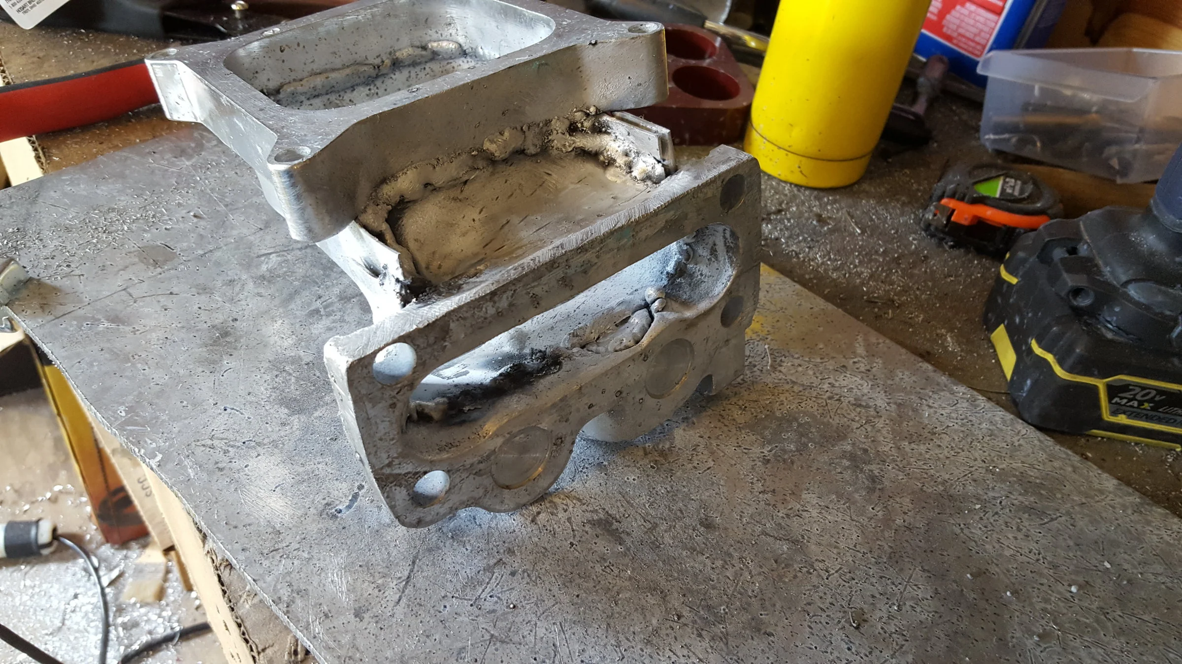

Yesterday I was outside staring at my engine in the car. The wife came up and asked what I was doing.
"Trying to figure out how to mount a tb on the new blower"
Wife: "what?"
So I showed her what I was trying to do.
Wife: "your over thinking it, just reuse stuff you already have."
Me: ok.......
Wife "why can't you just use the elbow thingy from the intake on the car"
Me: ..... wanna go into town....
We went and got a carb spacer, and aluminum bits from the hardware store.
Then today I got to working on it. (I really wish I had a rig this mig is a pain)
It needs the final touches but overall will work and as long as I measured right everything will fit under the hood I have on the car.
we will see.
I will also note that she wanted me to put a fake carb on it to mess with people.
Reactions: 90sickfox, hoopty5.0, krazedstang and 4 others

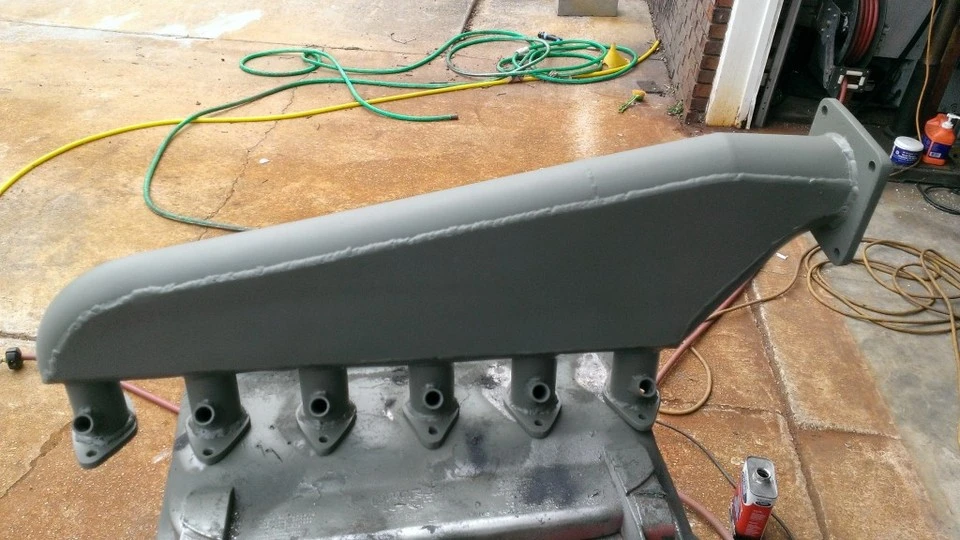

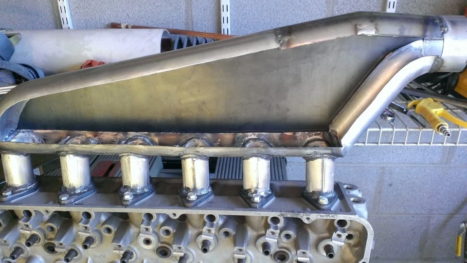

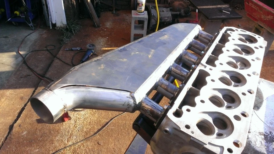

firstly, I wanna know why you are building an elbow w/ a carb plate adapter so that you can bolt another TB adapter to that?
Let me help you here.
* If,.......(Big if here)
The flange plate that bolts to the blower.........Can it be made of steel?
The plate that goes to you TB,.......................Can it be made of steel?
Remember this big giant adapter made out of steel?
All of this is made out of exhaust tubing and 16 ga plate....I bet that it doesn't weigh 20 pounds.
If I was doing your adapter, I'd do it the same way in your case...(why fck with aluminum welding when it's such a pain in the ass?) I'd plate that blower w/ 3/8" plate, then use (2) 2-2.5" mandrel bends (so you can accommodate the oval opening) to get it turned and merged into the 3" piece that I plated off as a TB mounting flange...
Then you simply "doll that btch up" w/ some wrinkle paint..
Ultimately, I had to add another 3" elbow and turn the TB 90* because it wouldn't work where I originally planned for it to go,..but it was as easy as adding another piece of STEEL exhaust tubing.
This concept is begging for you to take a version and make it work for you (provided that you can weld steel better than you can weld aluminum)...I believe that you can, so I think this is the path you should take.

Mike when I did the m90 the adapters I made were done with steel. Heck I even have a dc tig I used to do them with. I went with aluminum this time because I have never been able to use the material in my fabrication projects, the part I made will be functional and pretty as soon as I doll it up. My welding skills are not as bad as they seem, I'm using a mig that is not meant for aluminum it's proving difficult but I will manage.
The reason for the adapter having the carb flange.... I may change things up and use one of these.that's a 4150 throttle body. Pretty neat I think.
Also the need for the adapter to have so much volume stems from the m90 having an intake restriction. I made that adapter fairly large and it had a provision for 75mmtb... thing made 5inhg at wot. To avoid that same issue I am going with a large (very large) adapter this time. This is not like a turbo the m112 will want 800+cfm at full tilt, the gt500 had a massive inlet and throttlebody.
