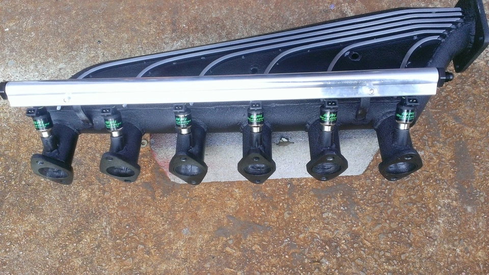

Today was fruitful, I realized that using the stock rails is going to suck. That said aftermarket rails with lines and a regulator will cost a large some of money that I don't have for the build..... this is problematic as once the injector bungs are welded in you can't change the angle... stock rails 15* aftermarket 0*.

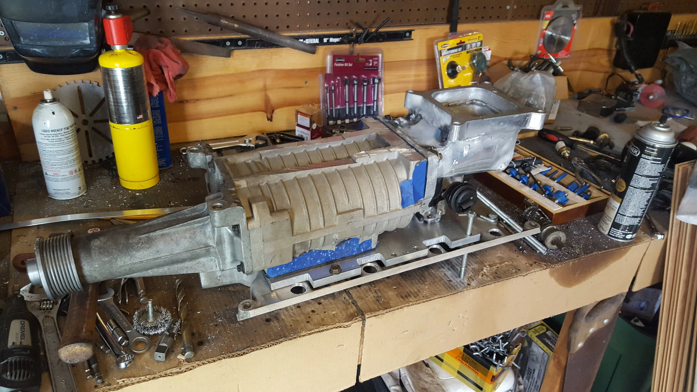

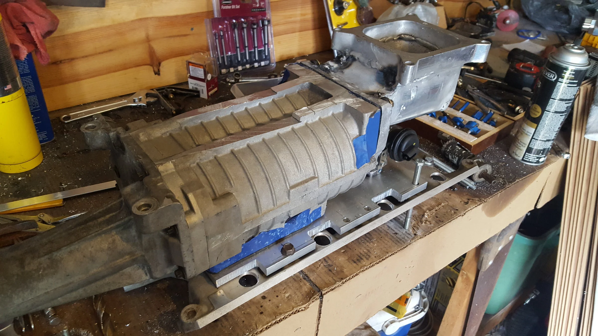

I did get this much done.
gonna need a cover plate of some kind.... almost lost the blower when the clamp on the bandsaw came loose. :doh:
don't mind the clutter believe it or not I used all those tools to work on this project so far....

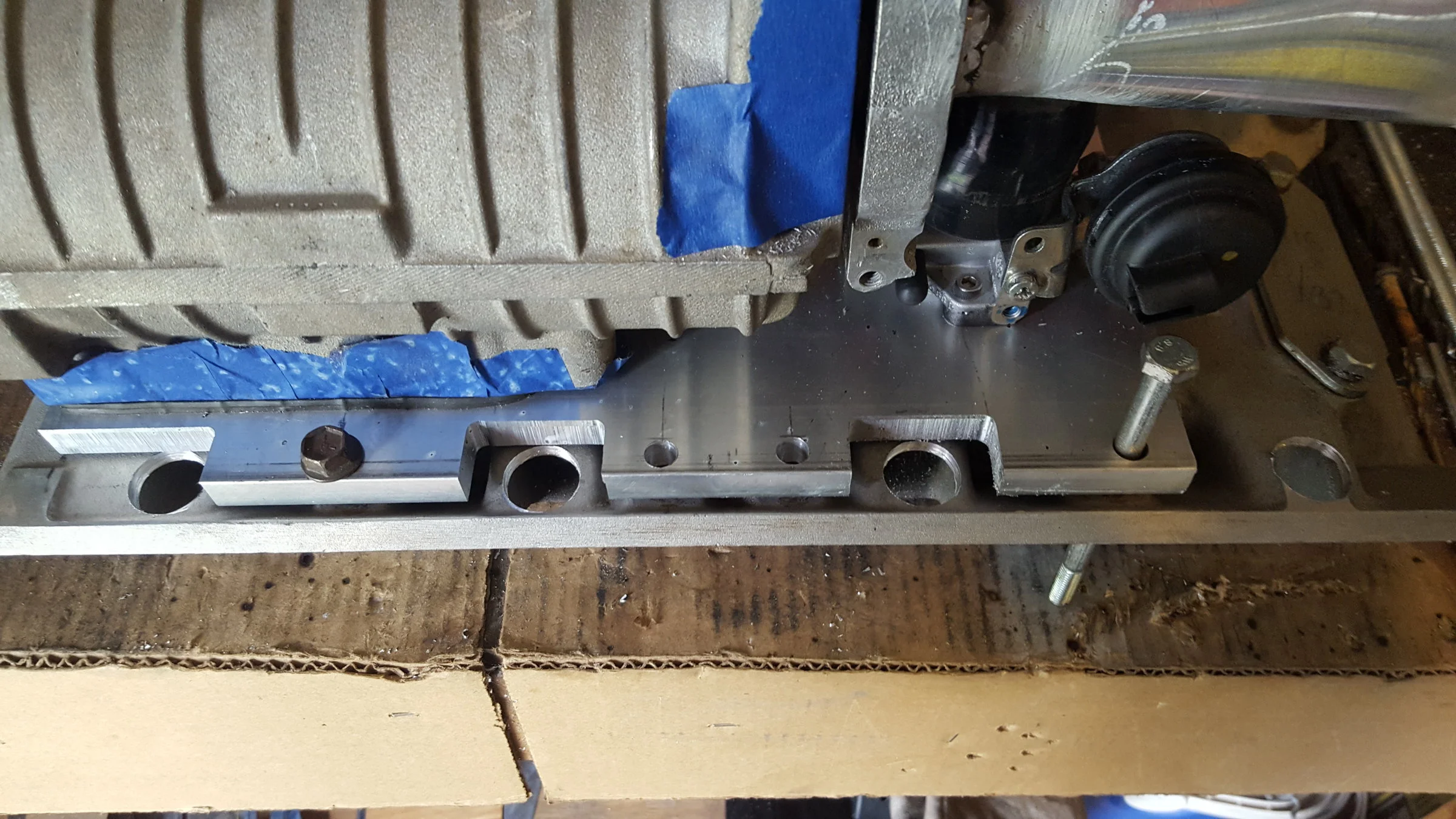

close up on the holes for the injector bungs.

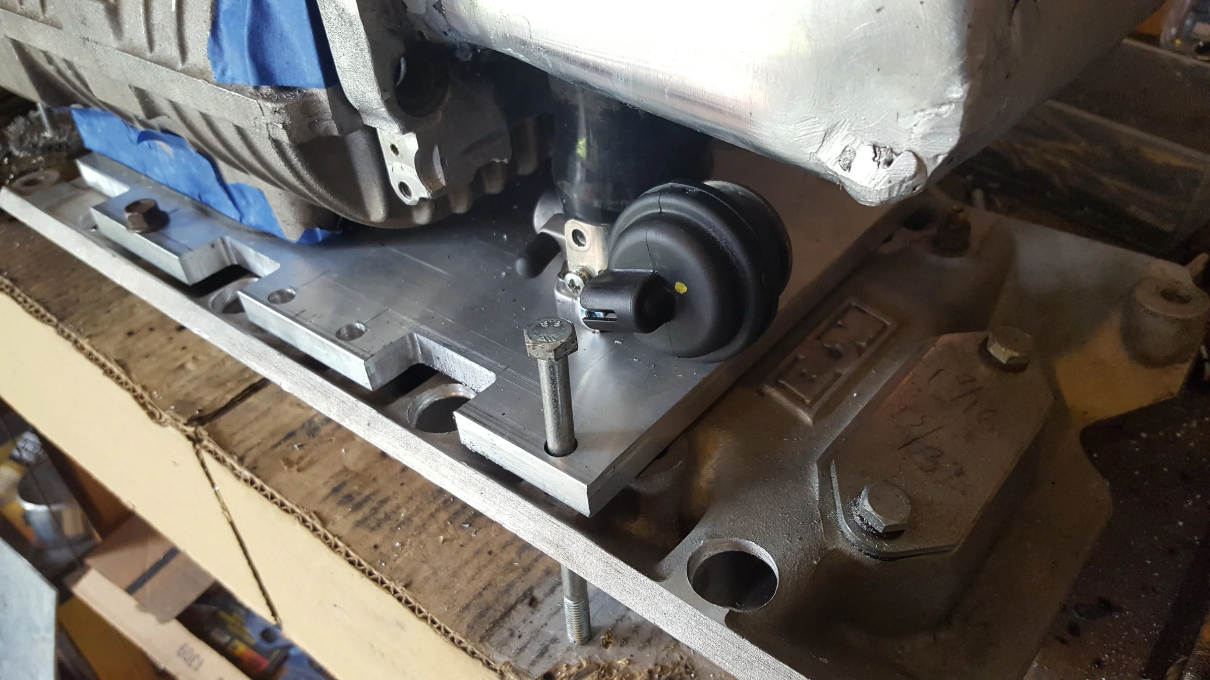

bypass installed it lines up well

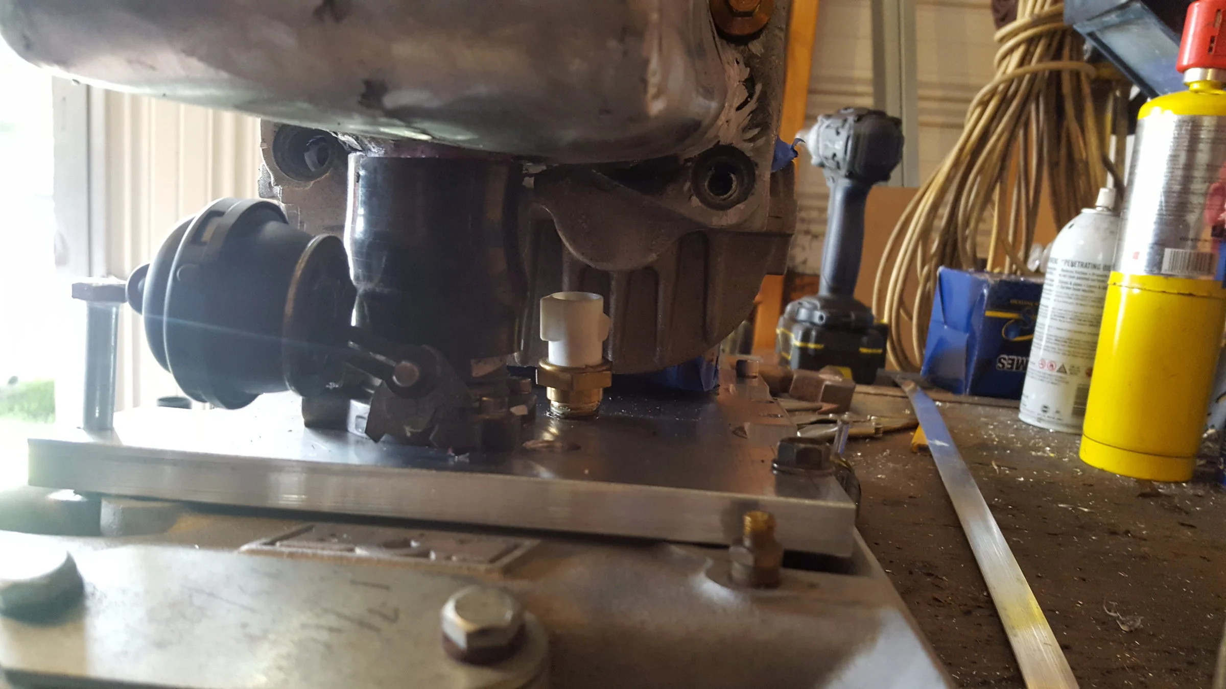

I drilled two 3/8 npt holes and tapped em out one is for the sensor in the pic the other will be a barb to feed the vacuum block.

If they are aftermarket (rails),...drill a hole clear through the solid portion of the rail and run a bolt through it. Then make a bracket that you can attach that bolt to, that is either attached to the manifold, or the head/ valve cover..
like.....this.
