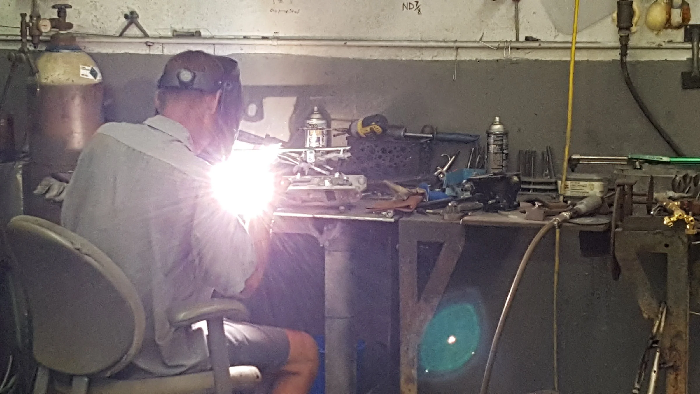

I found a place to help me out, all the machine shops in the area could not weld aluminum.... how the **** can you run a machine shop without being able to fix aluminum?
Anyway the last place I called told me there welder was down for repair but referred me to a airboat shop, Monday I will go down there and meet the guy so he can see what I've got going on.
the holes are already drilled...too big. He has to have them welded in.If you have a drill press and aren't just doing this with a hand drill, measure the od of the bungs, dill the intake 1/64 under, then ream the holes with a .001 under reamer, then press them in with some epoxy on them.

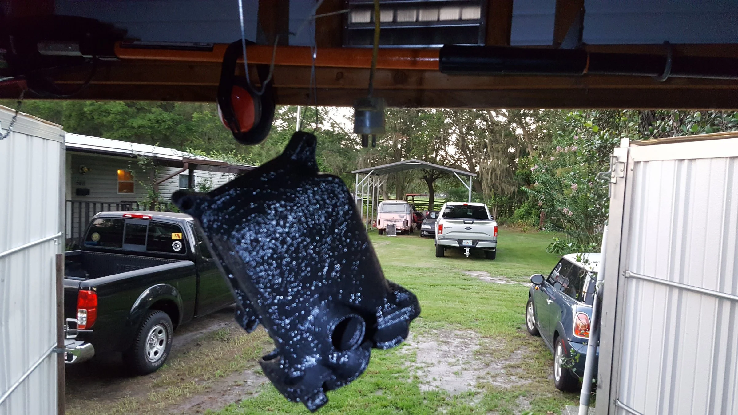

Intake is done, need a cleaned and painted. Waiting for the other machine shop to call me and let me know if they can cut the center out of my crank trigger wheel. I don't understand what is so difficult about what I need done, just get out of my way and let me use the equipment I'll be out of here in 10 friggin minuets ....![]()
