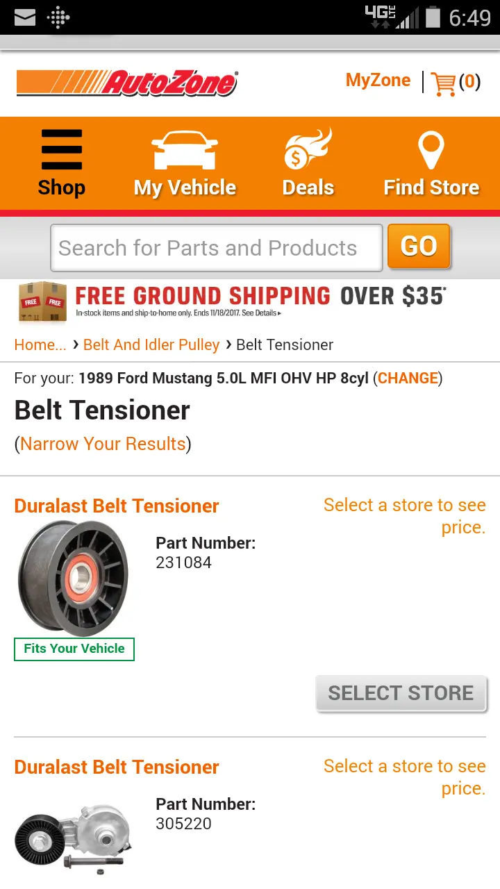

If you go to Autozone and ask for an idler pulley they'll sell you one that's smooth with edges on it like the original
Whenever I buy a tensioner I get them to let me swap the edged pulley for the smooth one. They don't sell a tensioner with the proper pulley.
This pulley is the reason a bunch of folks loose belts at high rpm. The belt tightens and walks off at the tensioner.

I kinda like that pully with the shoulders, manly.

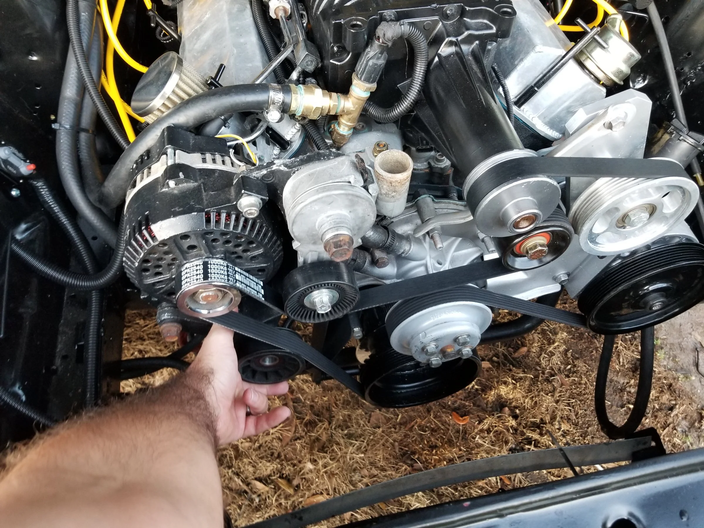

Soo for the next few days I am in class with EPRI to get my cert to teach instrumentation.... what a first day....
Anywho this morning I snapped this pic, opinions please.there's lots of room between the belt and water pump pulley so no issues there. I'm holding an idler pulley, my thought is adding it there. Possibly setup as a manual tension.
Will the belt contact the ac pulley enough in this configuration once I have it back on the car?

I’m not for sure-but it looks like (in the pic.) when the ac clutch engages-the belt would slip.
I can always add another idler if needed between the ac and ps pump.
I think I'm gonna run with it to get her up and going.

The a/c does not have enough load to cause belt slip. There will always be a bit of slip on gear changes as the mass of the blower rotors wants to keep going at peak rpm when the engine drops down in rpm due to the gear change. The slip is very momentary, a fraction of a second or so.

Thank you sir. Going with it then.

Ditch the spring tensioner completely and put a manual tensioner wherebyour hand is and fire it up

I like that belt path better BTW, and I'd try to put that idler as far inboard and as low as I could get it to create the tightest wrap around the crank possible.
