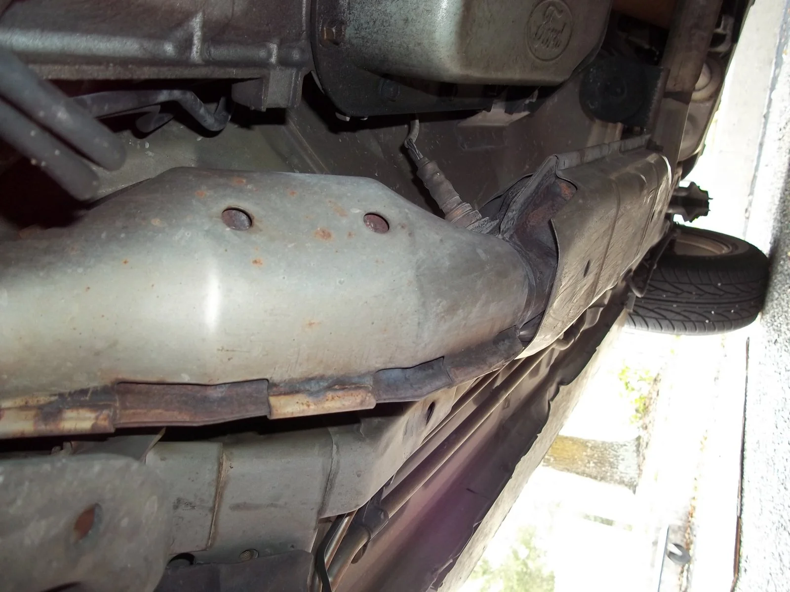

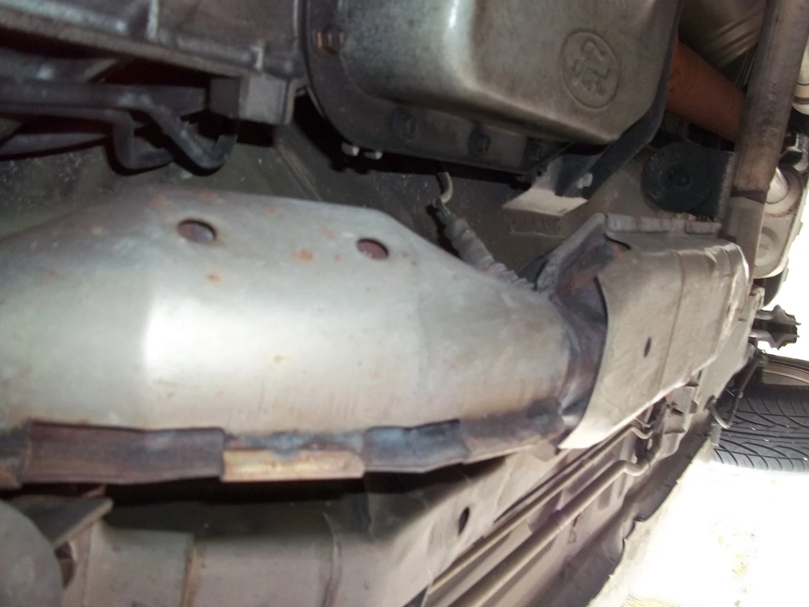

I was driving near home one night when I heard a bang and the car got a lot louder. After jacking my car up, I saw that the weld failed on the connecting pipe from the passenger side header to the catalytic converter. The car seems to run fine, it's just loud due to the open pipe from the engine. And no error codes are being displayed when I plug in the diagnostic scanner. Is it safe to drive as-is? Also, if I use the exhaust tape on it to temporarily quiet it until I get it fixed, will that damage the catalytic converter? I've attached a photo indicating where the weld break is.

Exhaust tape and some carefully placed clamps could hold it together until you can get to it.
Don't let that be very long though. What's more is that you should be prepared to have to replace one or more sections of exhaust if it looks like it's rusted through.
If it's not rusted, it should be a quick and cheap fix at any Midas or Meineke.
Looking at it when I jacked it up, it looks like just surface rust. I don't think I can clamp it because of where the break is. It's right up against the and of the cat. Also, is it safe to drive as is?

They will remove the broken piece from the cat, insert a new one, and clamp or weld to the rest of the exhaust.
The well placed clamp BTW, is just to give your tape something to grip to.
^^^^^^^^^^^^^^^ On the fly this is the best bet. Keeps you good until you can replace this part SOOOOON
Price will vary per shop. If it was me, I would do as suggested above to get by, but its only a patch and not meant to be a permanent fix.
No it is not good to run the car like this. It is important to get this fixed as soon as you can.

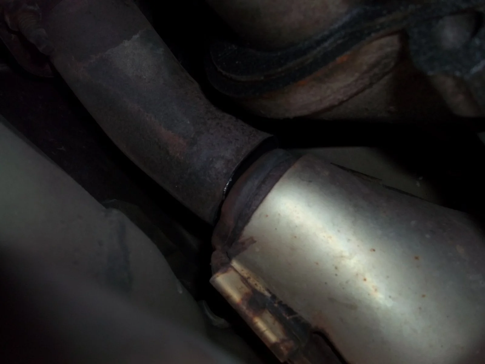

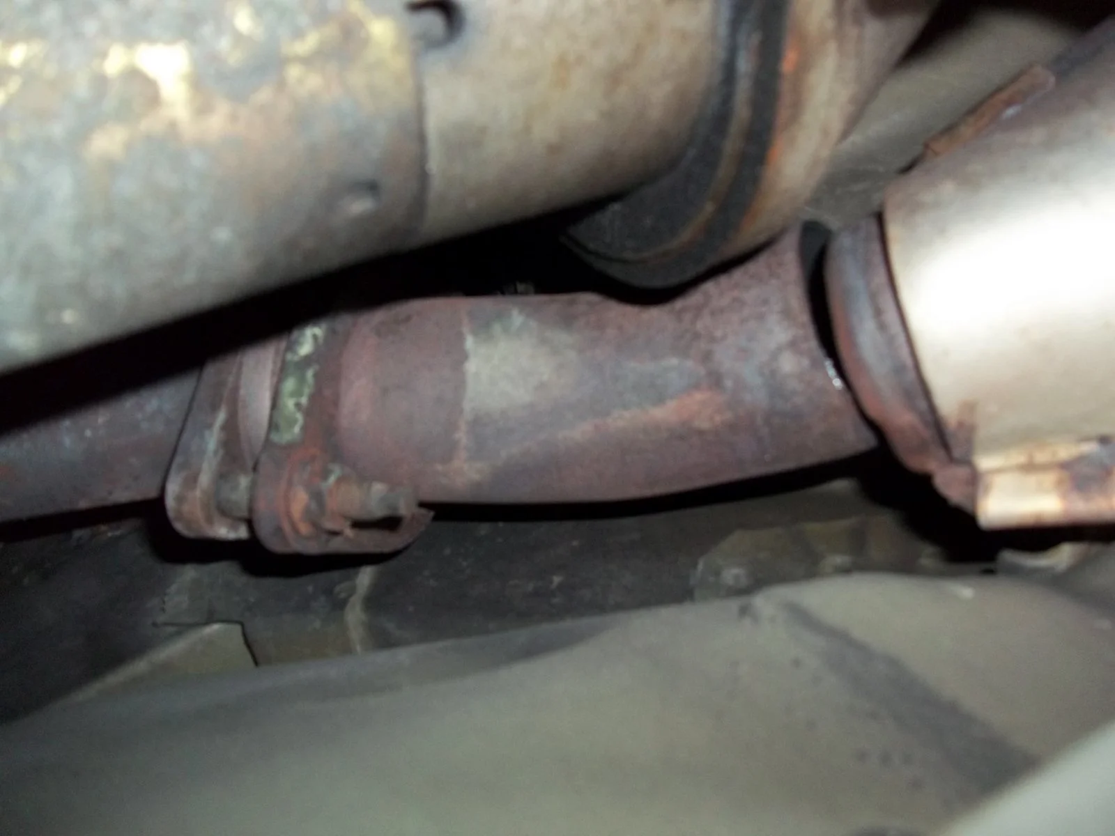

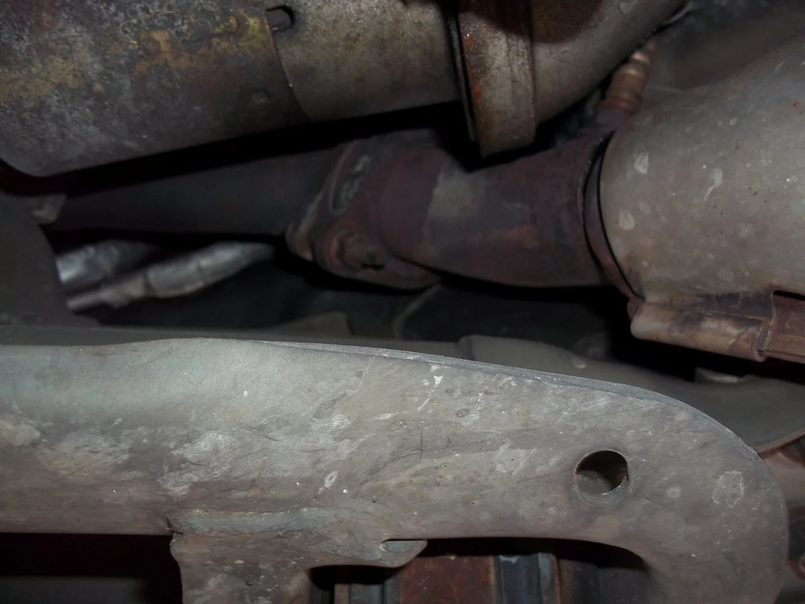

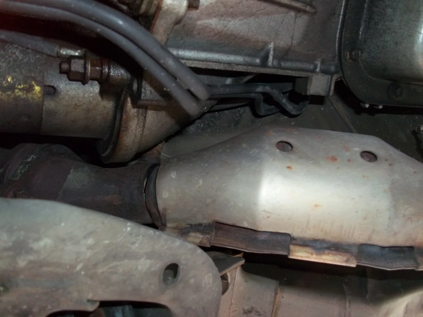

I'm going to jack it up this weekend and see if I can get the part off and weld it myself, as I have a flux core welder. if nothing else, just to tack it in place and wrap it until I can get it someone to be fully welded or replaced. The thing is, when I bought the car it had an aftermarket exhaust on it, so I'm not sure if what's on there is a stock part or an aftermarket part.
supply picture of actual part. One of us will know if that is what we removed from ours

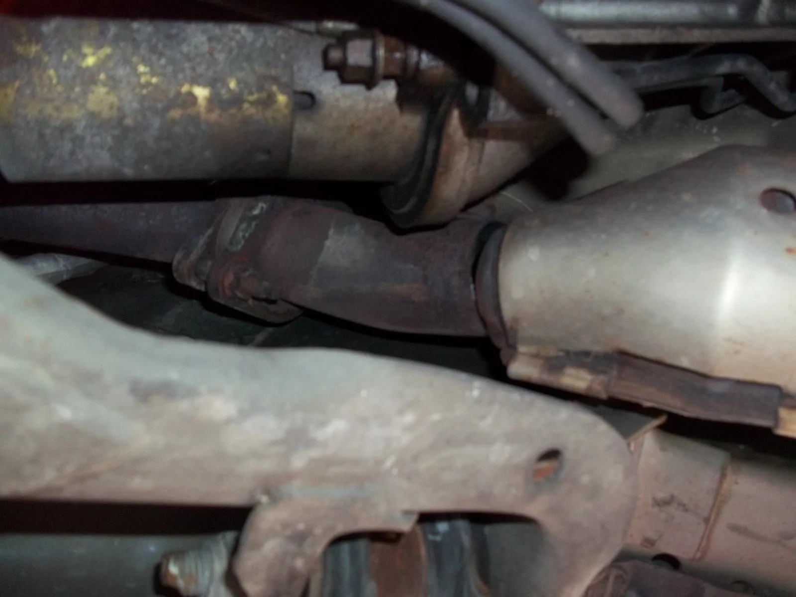

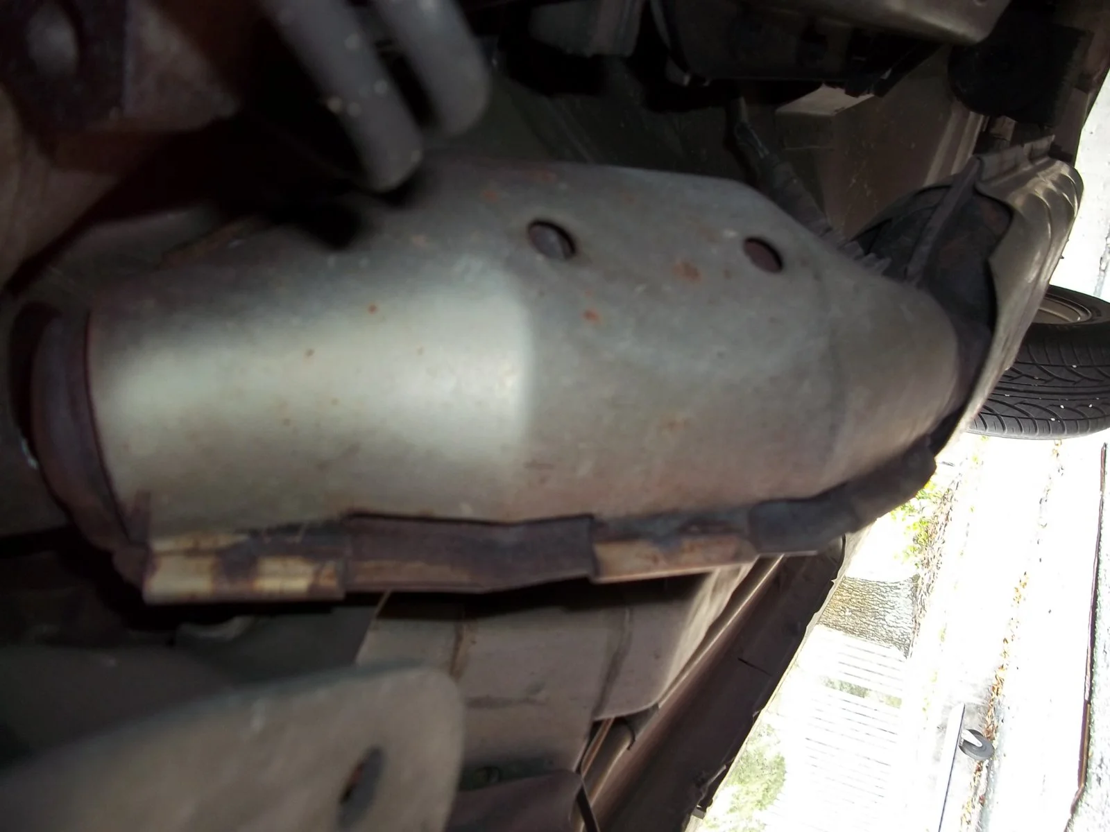

Sorry it took so long. The first 2 days it was raining (I live in apartment complex) and the next 2 I wasn't feeling well. This is all of the same part, I took a bunch of pics in case the detail in 1 or 2 wasn't good.

PB blaster on those bolts there and it looks like a break straight across. It is weldable if you can get it off.
Tack Weld it in place before you take it off if possible or make black lines where it needs to meet up. It would be a shame if you had to re-cut and weld because of the angle.
Clean out the insides on both ends, jamb a a ring in there that's about an inch or so wide and weld all the way around.
You could also run a ring on the outside of those two pieces (come to think of it) and that patch should hold until you more prepared to address the entirety of your aging exhaust system.
