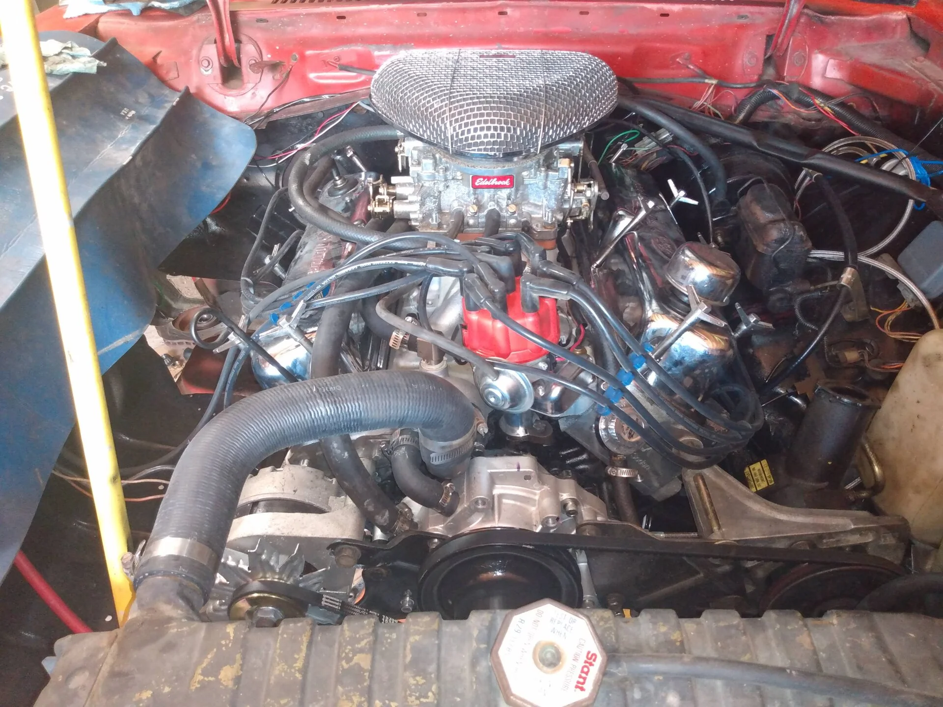

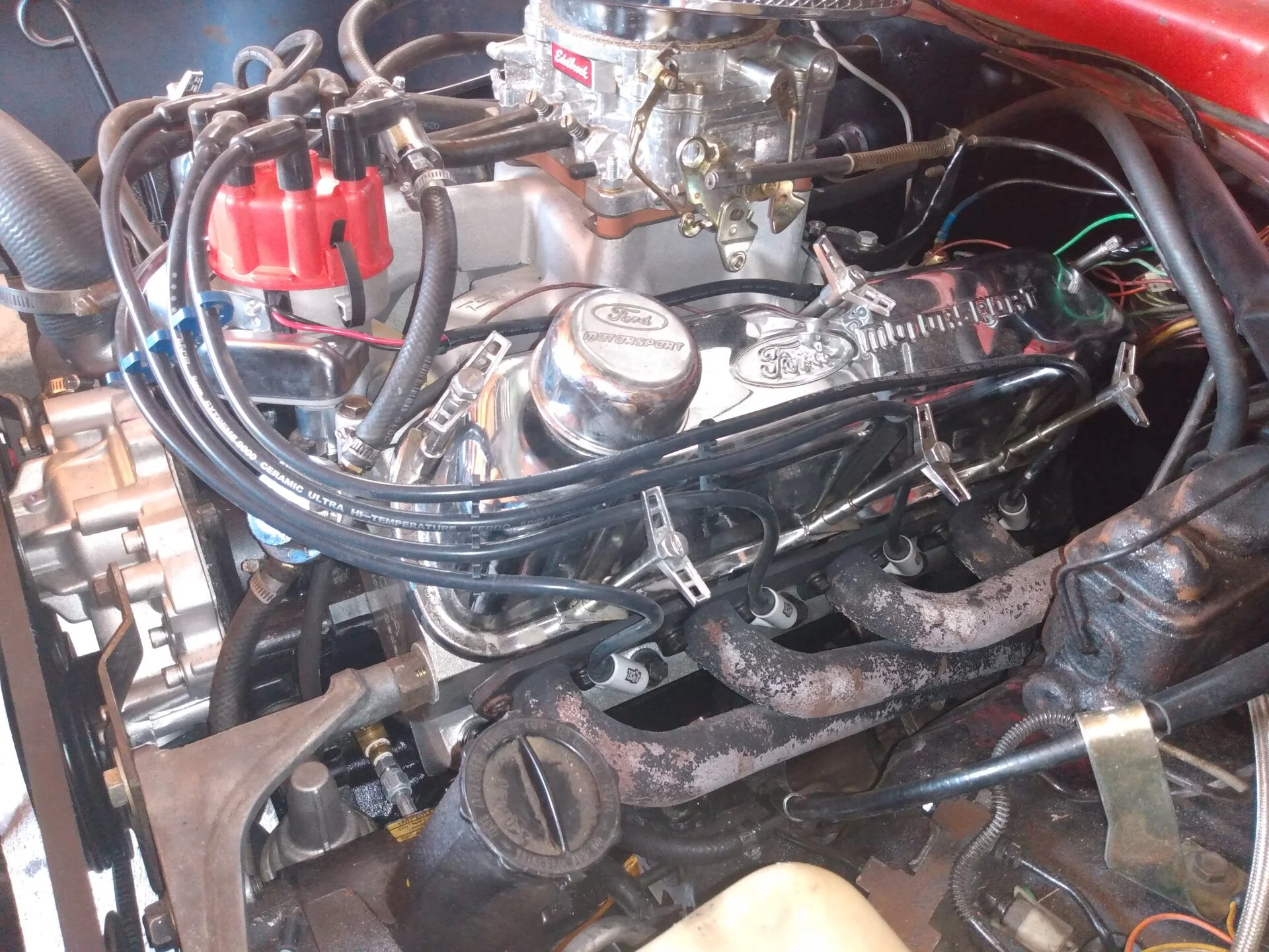

A good timing light makes all the damn difference. Playing it by ear was better than the "new" timing light. A properly functioning timing light is where it's at though. She fires up so easily. Cold or hot doesn't matter. Check your tools boys and girls. NEW really stands for Never Ever Worked.
Here it is just after a cold start from inside the barn, then a walk around.Towards the end I crawled under to give a look at the exhaust. The pressure from the exhaust outlets is identical. It has to be open enough to equalize. My old II with seperate cherry bombs had a noticable difference between left and right. The "pressure waves" are matched with this muffler.

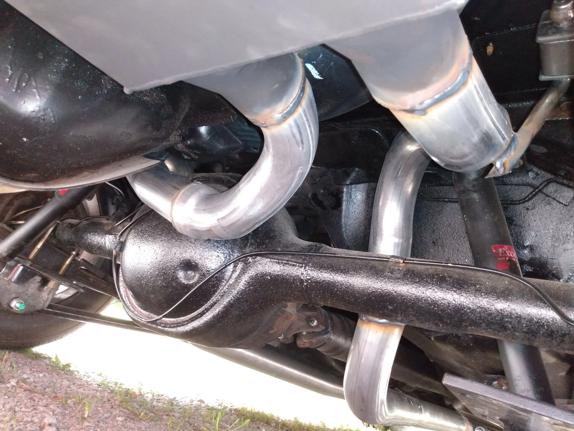

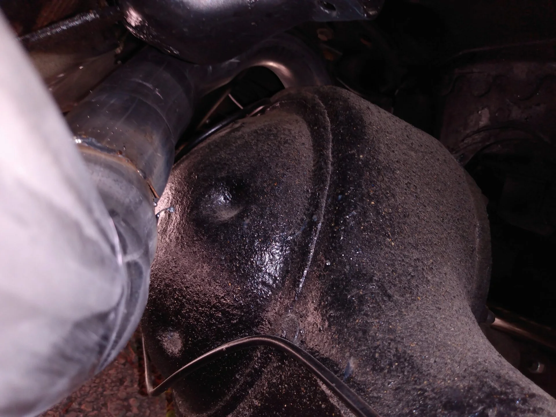

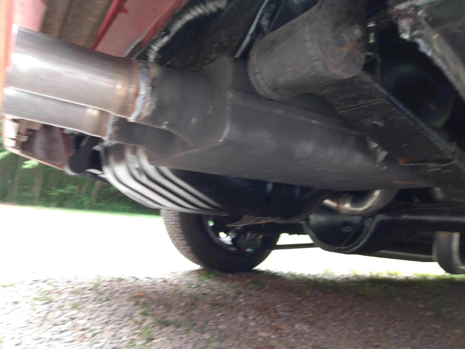

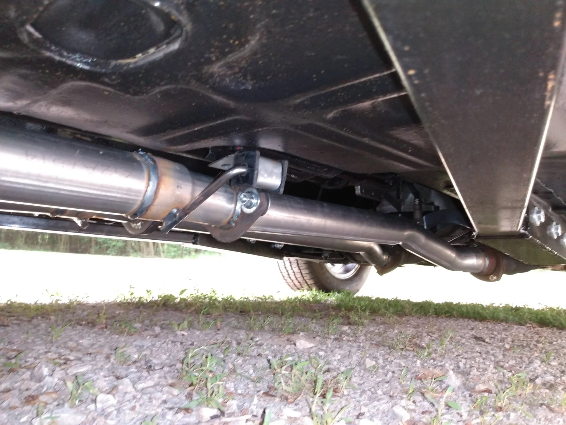

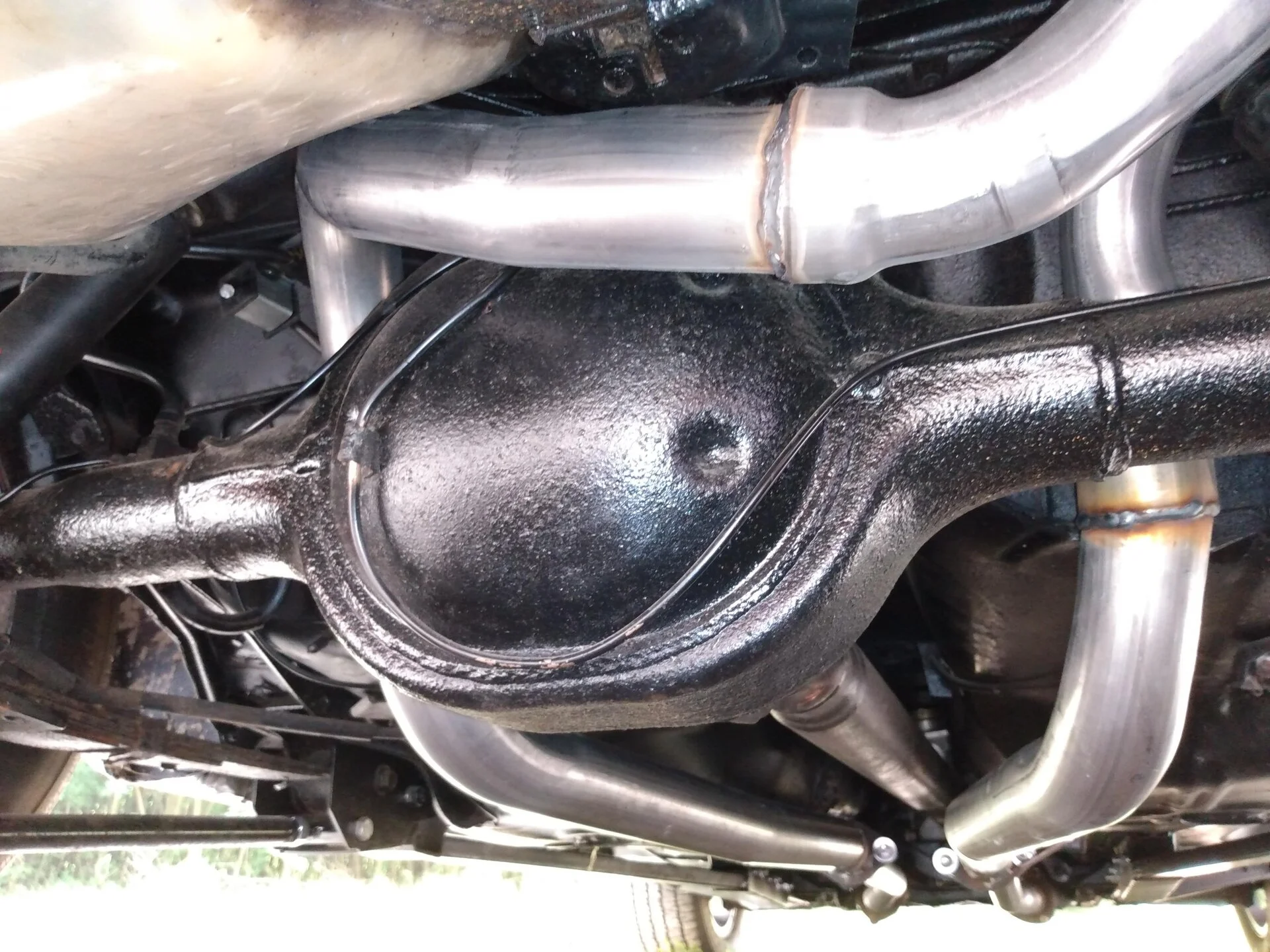

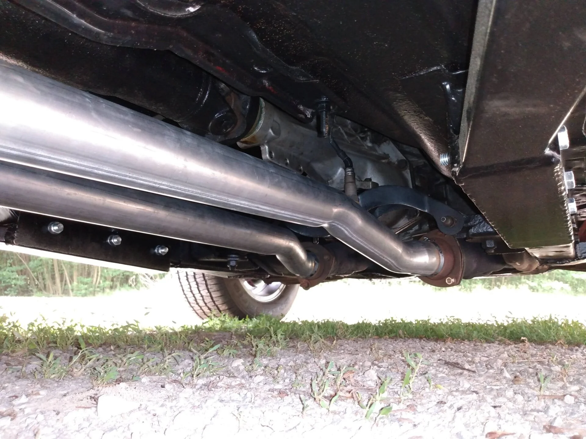

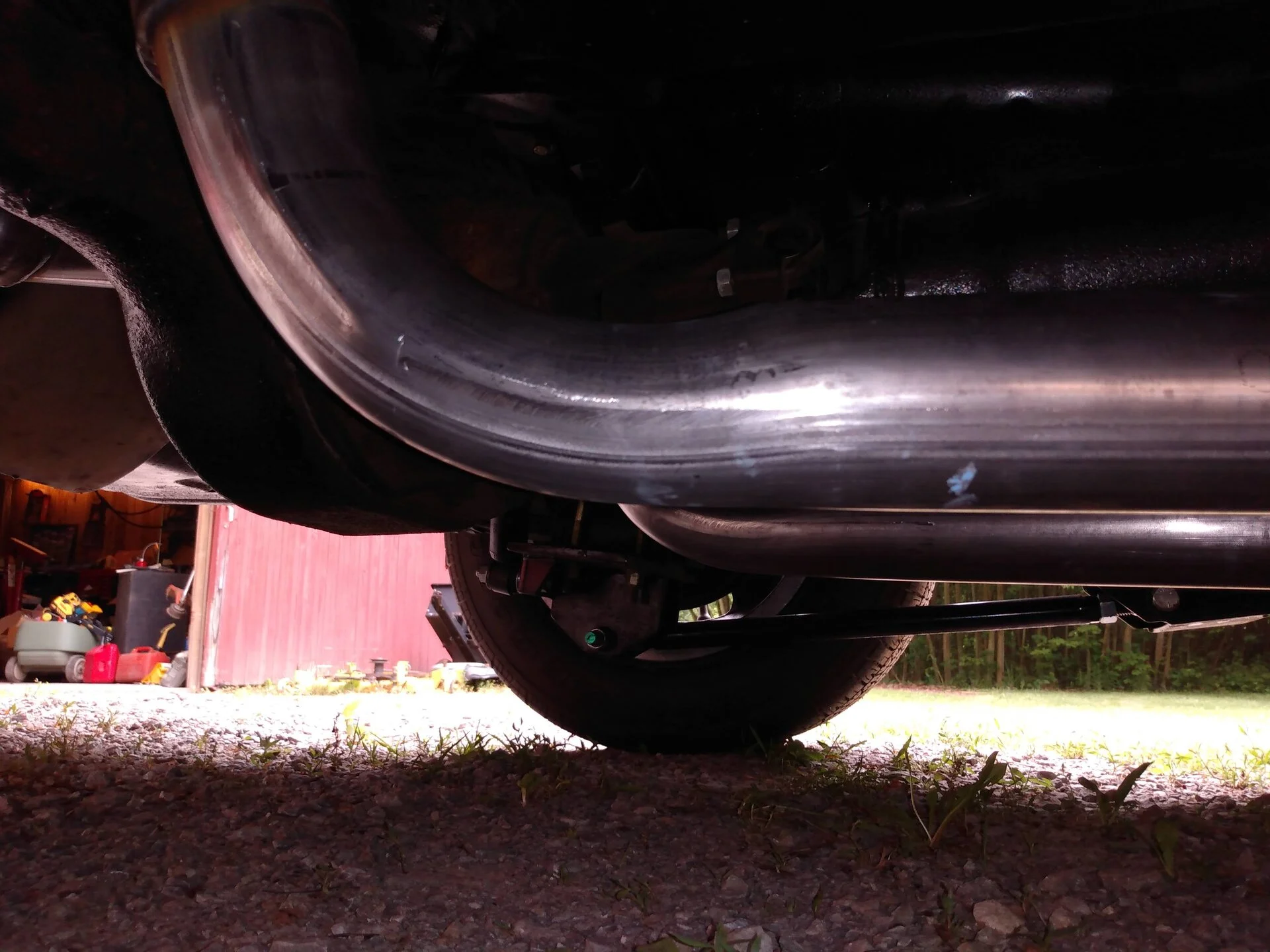

Following the video are some pics. Still on the ground but you can see enough to make it out. It's 2.5 through the bend upwards then 2 1/4 over and into muffler. I really like the way they did the center section for me. The back half over the axle doesn't move at all to access transmission. Just the 2 center sections come out. The rear brake line needs shortened now buts that's no big deal. It's tight when the axle goes up but I drove 20 miles or so of back roads yesterday and it seems to clear everything fine.
The owner said his first set of duals was one of these as a rookie back in the day and he has never done a harder car. Liked the car but not the gas tank offset. Not at all. lol

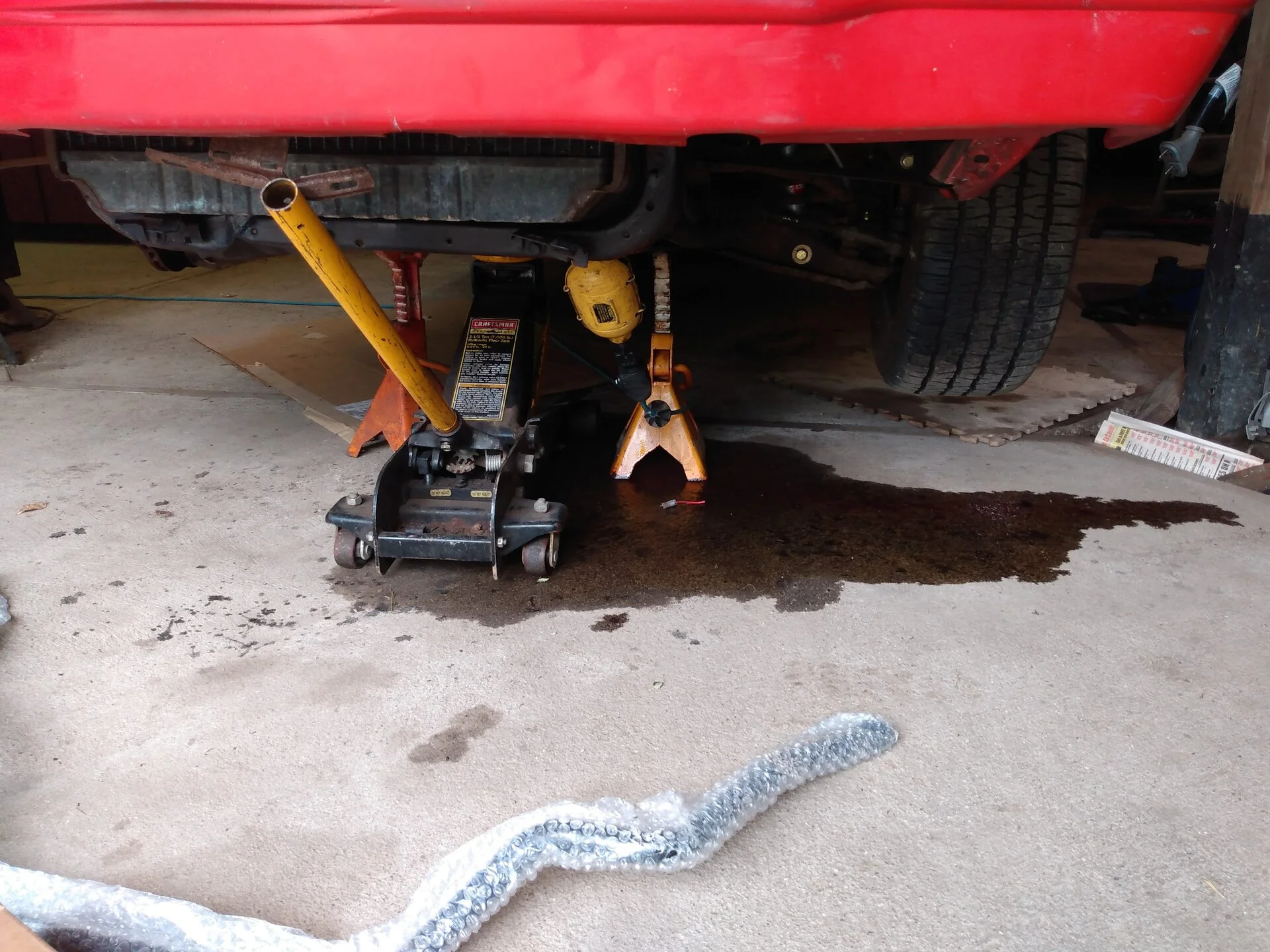

When getting exhaust I found the power steering pump leaking and ordered a remaned pump. The following pic is 3 days of sitting. It looks like the rack took a dump as well now. Both are original and I pretty much expected it but was hoping to get it drivable and get these things replaced over time. I guess thats still true except the drivable part but the timeline has been dramatically sped up. lol

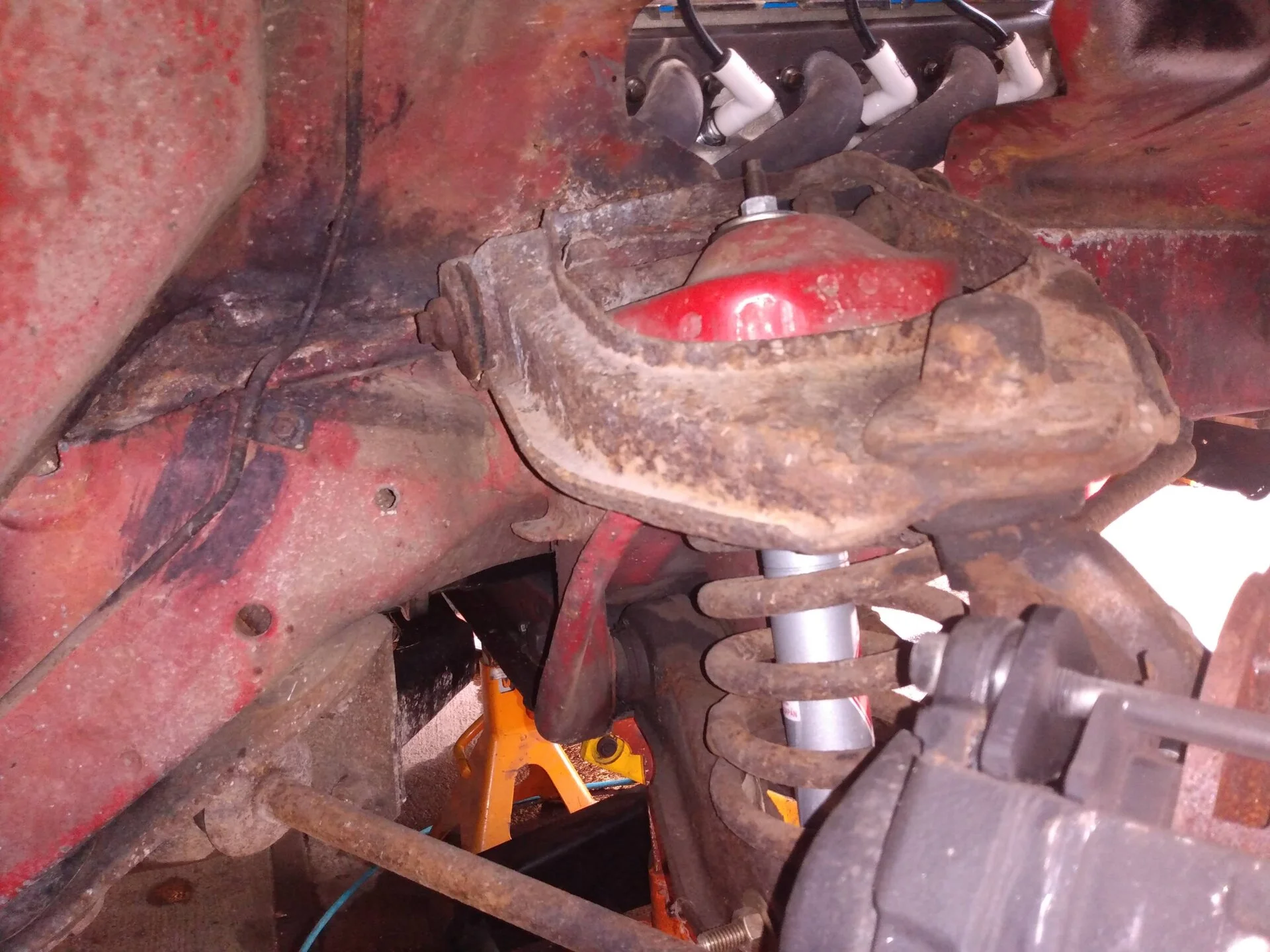

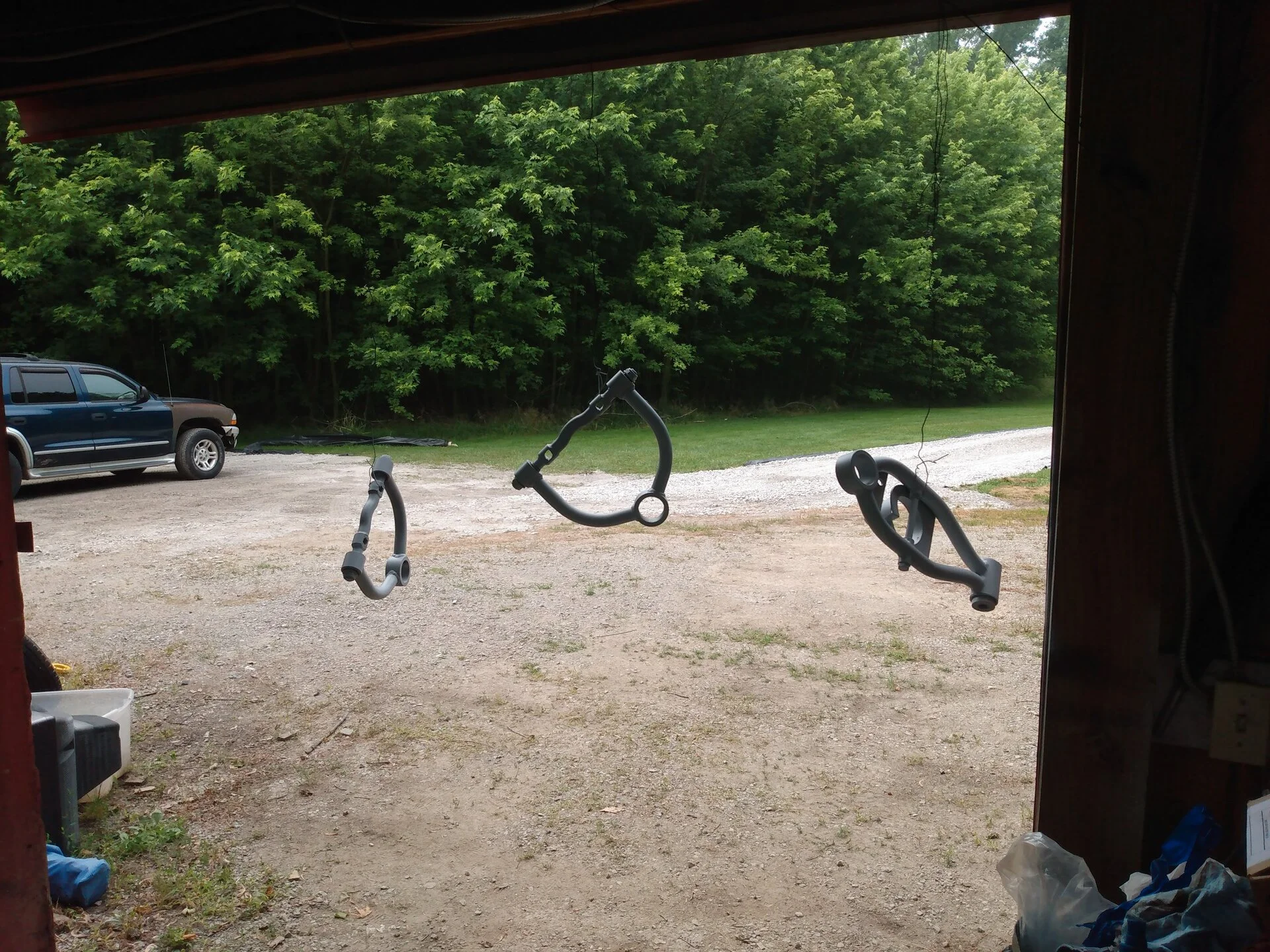

Now that that is done I tore the right front suspension off this morning and ready to tackle the left side the next chance I get. We will be changing from this.
To these.
Wait. 1..2..3.. Bummer. I am missing left lower one for now. Hopefullly it makes it sometime mid July. Gives me time to save up and get a new PS rack before it all goes back together.
For now the right spring and strut rod are cooking in my electrolysis vat and hopefully look like new in a day or two

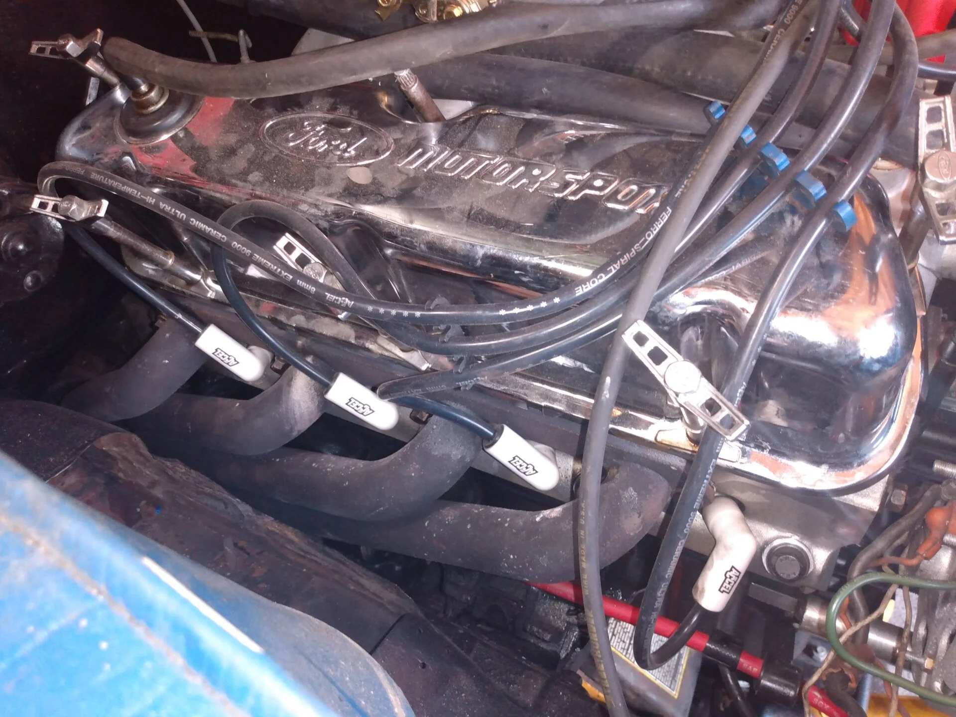

They are Accel ceramic. I melted my first set of Taylor wires having the timing too far off during breakin. I don't remember the model but they are from Summit. 45 degree boots would have been better but don't know if they make them.

Car is up on jack stands waiting on a back ordered lower control arm. It became scary to drive with the strut rod/ control arm bushings disintegrating. I tried to save a few bucks and now have to wait till 2nd week of july for an out of stock left lower arm. I have everything but that and spring isolators which should be on their way to rebuild the front end.

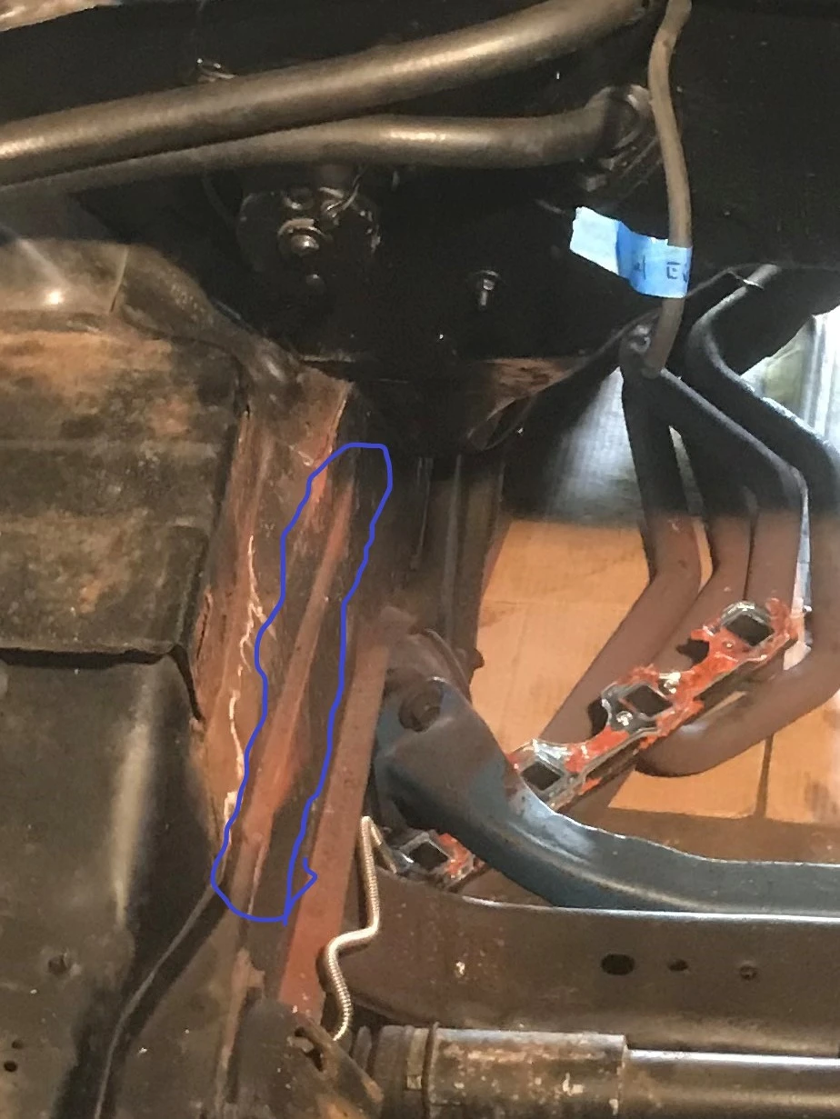

Speaking of vibrations. Where does the tailshaft sit in the trans tunnel on your guys builds. Is it centered in the tunnel left to right or offset to one side? In order to get my headers even with the frame rails on both sides the tail sits close to the passenger side of the tunnel. When centered in the tunnel the left header is closer to the frame rail at the rear of the engine and the passenger side is closer in front. It appears the engine is crooked. I know they sit offset towards the passenger side but it appears the trans is centered. That will cause pinion angle issues if the rear end is centered and engine is slanted to one side.
I have to say that I haven't paid any attention to where the tail shaft sat in relation to the tunnel. And, because I do not have the car or the engine at the moment I can't help you on that. @LILCBRA has been deep into the vibration issue with a T5 and when he gets back from vacation he may be able to help.
My headers are the old blackjack style unlike yours but they are so close on the passenger side that when I took them out for the rebuild I heated up the pipe and smashed it down with a hammer to give it more clearance. Under heavy acceleration they would hit just below the battery. (Outlined in blue)
