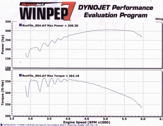

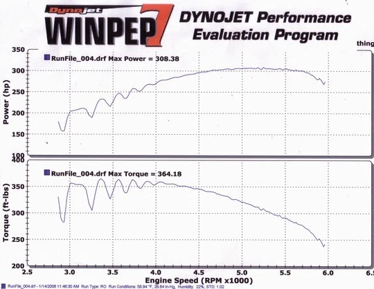

I'M RUNNING THE F CAM WITH STOCK 95 GT HEADS AND NO ISSUES FOR 4 YRS. EVEN GOT STOCK ROCKERS TOO.
ONLY THING I'M LACKING IS A SET OF GOOD HEADS AND 1.6 ROLLER ROCKERS.
I LOVE THE TOP END IT HAS WITH THIS CAM. FROM 2800 TO 6000 IT PULLS NICE.:D

60k mile valve springs, stock rockers. Granted it aint out to 6000 but it didn't float . . . yet.
I am not saying you shouldn't run better springs but it can be done. Just like you can run a multitude of different things on a car . . . You know you shouldn't but sometimes you don't care or are not worried about the consequences.
12.2 @ 112 grannyshifting a t5.
Now has a TKO . . . and subsequently haven't been to the track.
