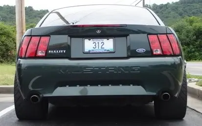

Theres a guy in our car club with 295s and they look pretty sweet. Maybe a 1/4 isnt enough, but I think it will still look badass, like this.....
That is flippin' SWEET. Please tell me EXACTLY how he achieved that look...are those only 295's?!

WOW. i am about to purchase the KDW2s 295/35/18 and I want that look so bad. my 285s arent cutting it. are those seriously 295s?
No, they are 315/30/18 BFG Drag Radials. The largest size (as of now) that BFG makes in a street tire for us is 295/35s. They look good, but not as good as the 315s :drool:

After looking at the picture, I think they are exactly the 295 KDW-2s!!! Look at the tread pattern!
I just wonder what kind of spacer he used!
nope, 315/30 BFG Drags. The outer tread pattern is similar, but they are DR's, not the KDW2's that kick ass in dry AND rain.
