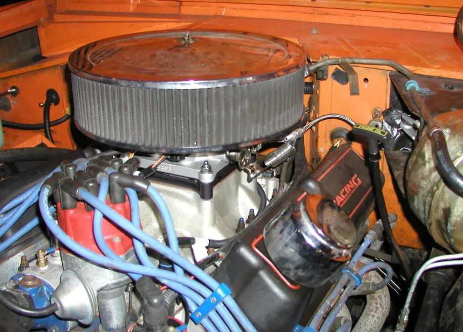

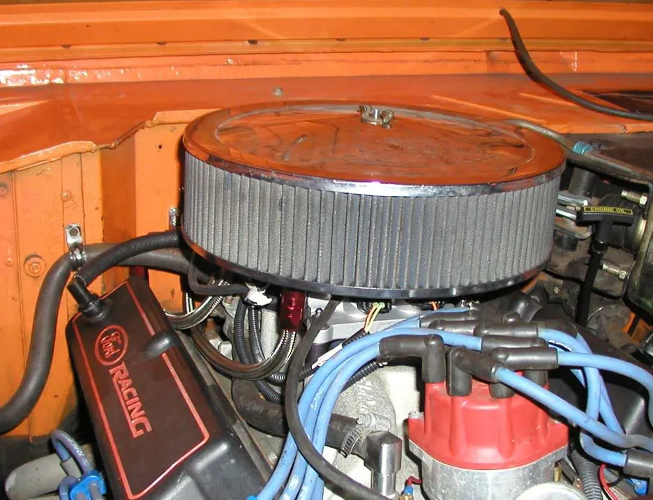

I just installed this system on a Classic Bronco
This system has a lot of potential, but I am having a few little issues.
1st issue) not getting the fuel milliage I got with my carb, close but still lower than with my carb
The techs at fast have been helpfull, and we have got the milliage to come up from 10 mpg to now close to 13 mpg, but I got close to 15 with my Holley Carb. I am going to lean out the cruise air fuel ratio a little bit more, and see if thatgets me where I need it to be.
2nd issue) a small little cold starting issue
It starts right up. but it has a slight stumble when you give it any throttle untill the collant reaches 140 degrees. To me it looks to be a over rich issue, untill the coolant temp reaches 140 degrees and the ECU goes into the learning mode. As soon as the adaptive learning kicks in, the stumble immediattly goes away. I think there may be a software download to solve this issue. If you just let it idle till it reaches that temp there is no stumble, but if you even tap the gas pedal you get that stuble. If you watch the hand held controler when it does that you can see it goes from 13.5 air fuel, to 10.0 airfuel when that happens. If you do the same thing after 140 degrees, the airfuel does jump so rich by just apping the gas pedal.
Other than those issues it runs awesome, but unless we can solve these issues it isn't going to stay on my truck
pics
I've been folowing the ez-efi for quite a while now, most users report huge TQ increase and a sizable increase in mileage, I was going to buy one but got a killer deal on a powerjection 1 (with ignition control).
I'd be looking at your ignition curve/timing as properly tuned the ez-efi should beat even the most finely tuned carb in mileage and throttle response, it does flow 1000 cfm though. How do your plugs look?
