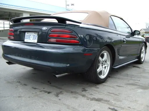

My buddies car with 315s on a 9 inch wheel. Looks just fine.
95 Cobra Wheels are the same as GT Wheels: 17x8.
I have 275/40's on 2003 Cobra wheels. When I get new tires, I'm going with at least 285/40's. A bit bigger, but still will fit without bulging.
I would really like to see a CLOSE -UP shot of some 315's on 17x9's. I'm sure it bulges out. If it doesn't, you can be sure a pair will be out back on my car. My buddy has 275's on his 17x8's, and it bulges big time.

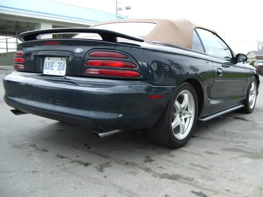

It all depends on brand and how the sidewalls are made. My sig says which ones I've got, but those are essentially a no-warranty cheaper version of the Fireston Firehawk Wide Ovals, and they don't seem to bulge at all on my 17x8 Cobras. IIRC Nitto's also fit quite well in this size. I can't remember which ones you should stay clear of if you want 275's, but a knowledgable salesman should be able to point you in the right direction. I'm very happy with the fit and the added traction of mine, no problems whatsoever.
