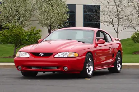

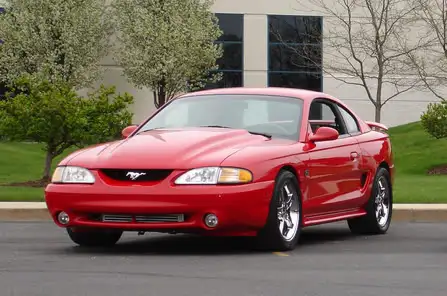

That looks perfect...does he have spacers on the back?
315/35-17 on a 9" rim = :nono: :nonono:
315/35-17 on a 10.5" rim = :nice:
275/40-17 on 9" = :nice:
275/40-17 on 8" = :nono:
255/45-17 on 8" = :nice:

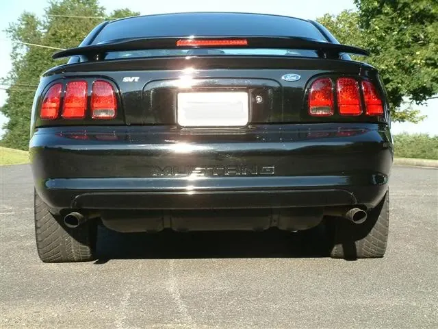

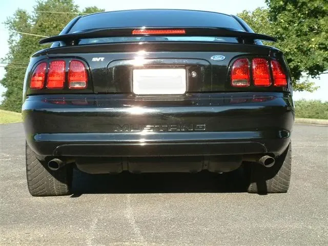

Here is an old picture of 275/40/17 Goodyear GS-C tires. I dont have a good picture of the rearend of the new tires.
:hail2: That stance is just about what I am looking for, I'd love to tub the rear and put a spool in, but for a regular, street driver, the 275s will have to do...
Funny, the a$$ of your car looks like mine! (except taillights), and fatter rear tires, and different lic plate, and exhaust, but identical I tell ya! LOL.:hail2:

I already posted a pic. It looks fine and he's gone through a few sets of tires all of which wore fine.
you say it looks fine, but my eyes see a very different story. even in those pictures you can tell the rear tires are bulged way too much.
i would bet that if your buddy switched to a more proper sized tire his car would handle a lot better.

Don't get me wrong, it clearly bulges some, but I personally have never looked at it and said, wow that looks like crap. It's just really not that much of a standout. And yes, Im sure its not providing optimal handling, its just something he sacrificed for the look without having to buy new wheels.
whatever chokes his chicken
i'm just sayin that he could have bought a smaller tire(less $$$) and had the same contact patch. oversized or stretched tires are kind of a pet peave of mine. :cheers:
