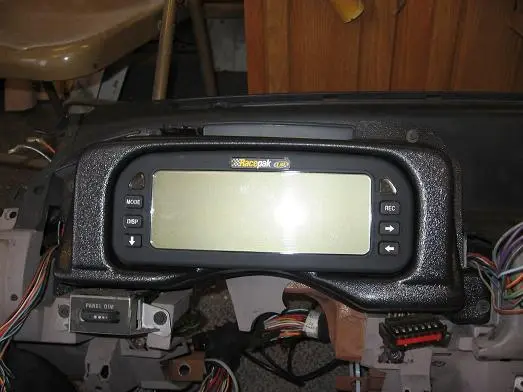

- Racepak dash backlight has fizzled out again. Bad design apparently. This is the 2nd time it's gone out. Paid $70 for Racepak's repair last time.
I have heard of this issue before with their dashes. You may want to look into something different and also more features for that beast you have there.

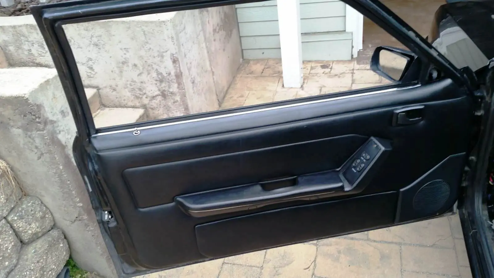

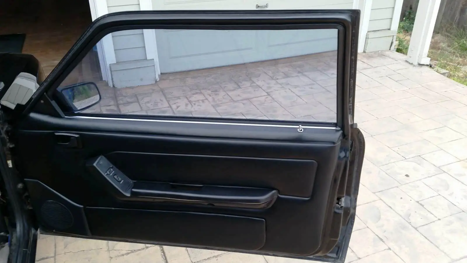

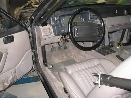

After years and years of letting other shops have my fun, either because I was out of the country, didn't have the tools/ability (welding), or because I didn't have the time, my beautiful grey interior and original electronics both became complete cluster :leghump:s!
630866
When "professionals" do electrical work, they do it in a hurry, and usually leave every existing wire in place. Over time, this can lead to a rat's nest of unnecessary BS behind the scenes. The gross interior panels can usually be cleaned, but long ago, I decided to swap to black. I've had a hell of a time tracking down genuinely nice original black interior pieces, but something hit me a couple days back when I realized that the driver's side speaker didn't work. The last shop to do any major work (HPP Performance in Dallas) actually returned my car with the stereo upside-down! The problematic wires were not in the door. So, I decided to track them down, and meanwhile, to get the old door panels that I've had for years installed.

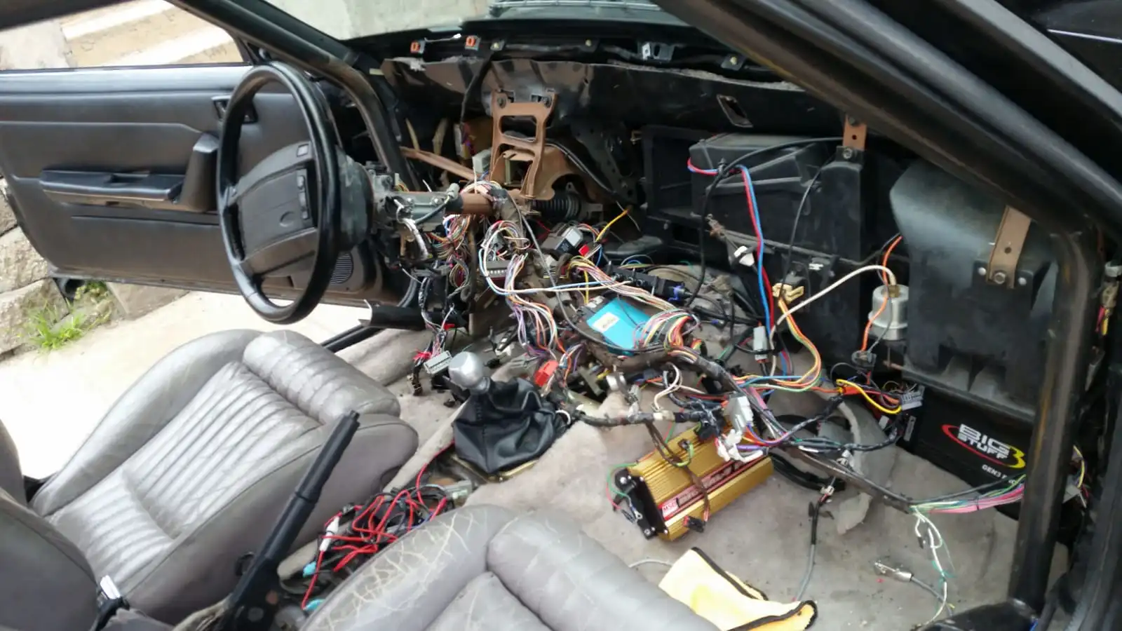

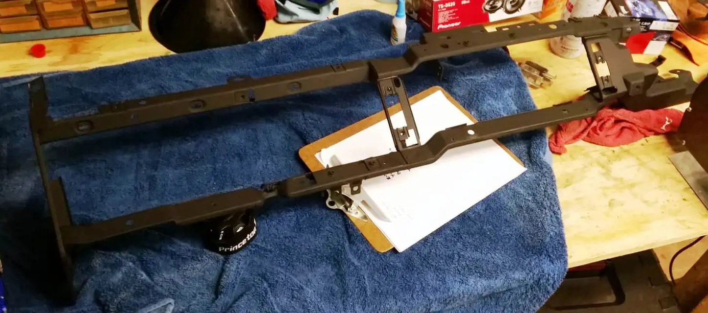

But before I could put them together, I had to track down the wiring behind the dash that caused my issues, and that led to:
630871
and the surface rust on the metal dash bracing bothered me, so:
630872
Now -- and this might take me a while -- I plan to
- go through every damn wire behind the dash and remove anything that is no longer in use.
- remove air bag electronics (with a 5-point belt, and the violence I expect on launches, perhaps even wheel stands, I don't want it blowing up in my face)
- examine the a/c and heater core for replacement if necessary
- install a new head-unit, and a small amp, sub, and sound bar.
- new black carpet
- refurbish and install an old black dash I already have.
- refurbish a black console base, and install a new black cup-holder console
- new 5-point harness & streetable seats
- new billet switches and panels for the doors
- wire line lock to hurst shifter handle thumb switch
- wire rear defrost into the GT fog lamp position & update marking. (This is an LX, but I've ordered a GT switch)
- wire my electric exhaust cut-out switch to a the 3-way convertible top switch & update marking.
- update dash switch markings to account for their new assignments (still haven't figured out how to make this look nice.
- Add a fuel level gauge to the a-pillar roll-cage bar
- Move ECU & ignition boxes to behind the seats somewhere.
- install sound deadening as necessary behind the dash
630866

Now it's a snake pit...I'm glad that's in front of you and not me...I'd just cut all of that sht out and rewire the whole car..the wiring IS 25 years old after all..
Not talented enough, I'm afraid.
That -- the engine bay's clutter of hoses and wires -- is exactly where the name came from. So, it's fitting.
When I called them, the fella said they'd solved the issue with it, and if I sent it back he'd fix it under warranty, free of charge. Sounds pretty good to me. He's got it, now.
