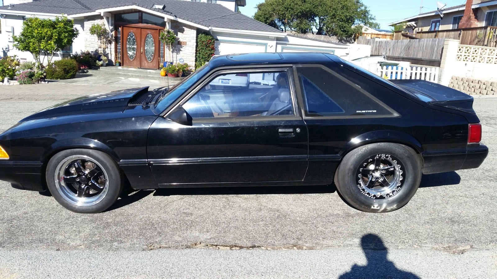

New shoes!
Took a little work to get the 15" rears to work with the 12" brakes, but they fit!
Finally you can get some traction... with the 13psi or so your making the car should be down into the 9's by now right??
Probably. It's all new territory for me. I'm going to need a little seat time. Also, this car has been tuned on Torco + 93 Octane to 880 rwhp without enough spring in the wastegate to keep it closed. I was hoping for 4 digits when I pieced everything together, and the turbo should be good for more than the one in the blue car, which made 954. I'll take a trip out to Sacremento after I get the new ARB in. The old one broke because I was driving it on the street. I'm replacing it with a bolt-in style ARB so that if it happens again, I can do it without any welding.
Slicks on the street ?
No. I had just pulled it off of the trailer. It might find its way to an occasional street race on them, but for normal driving it gets the 17" wheels and tires in post 102. Racemaster 325/45/17 & 245/45/17 Michelin PSS tires up front.
