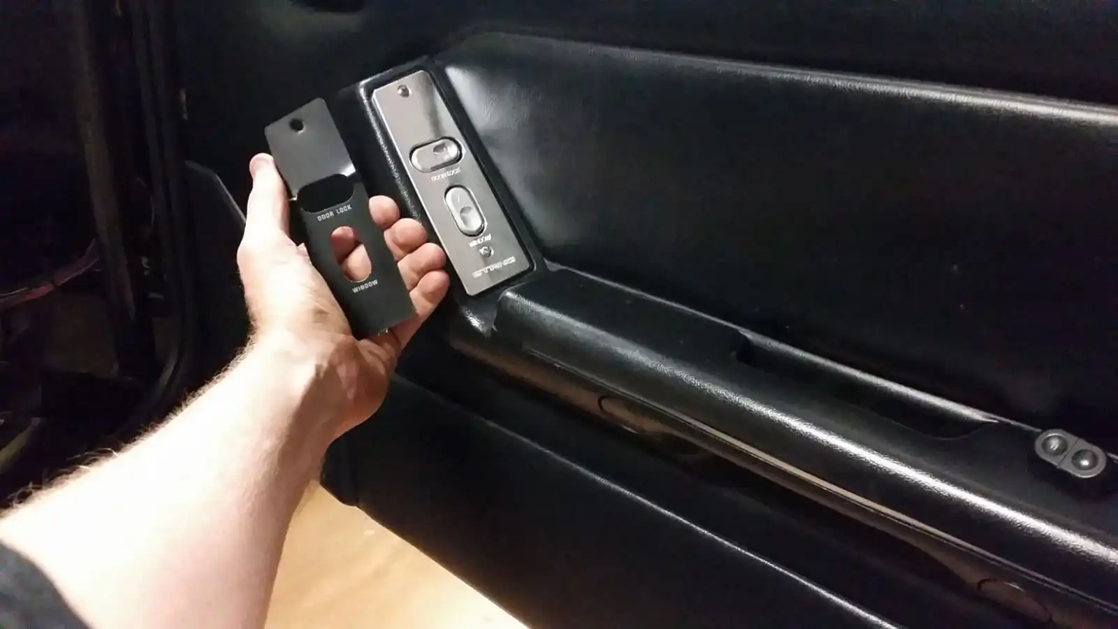

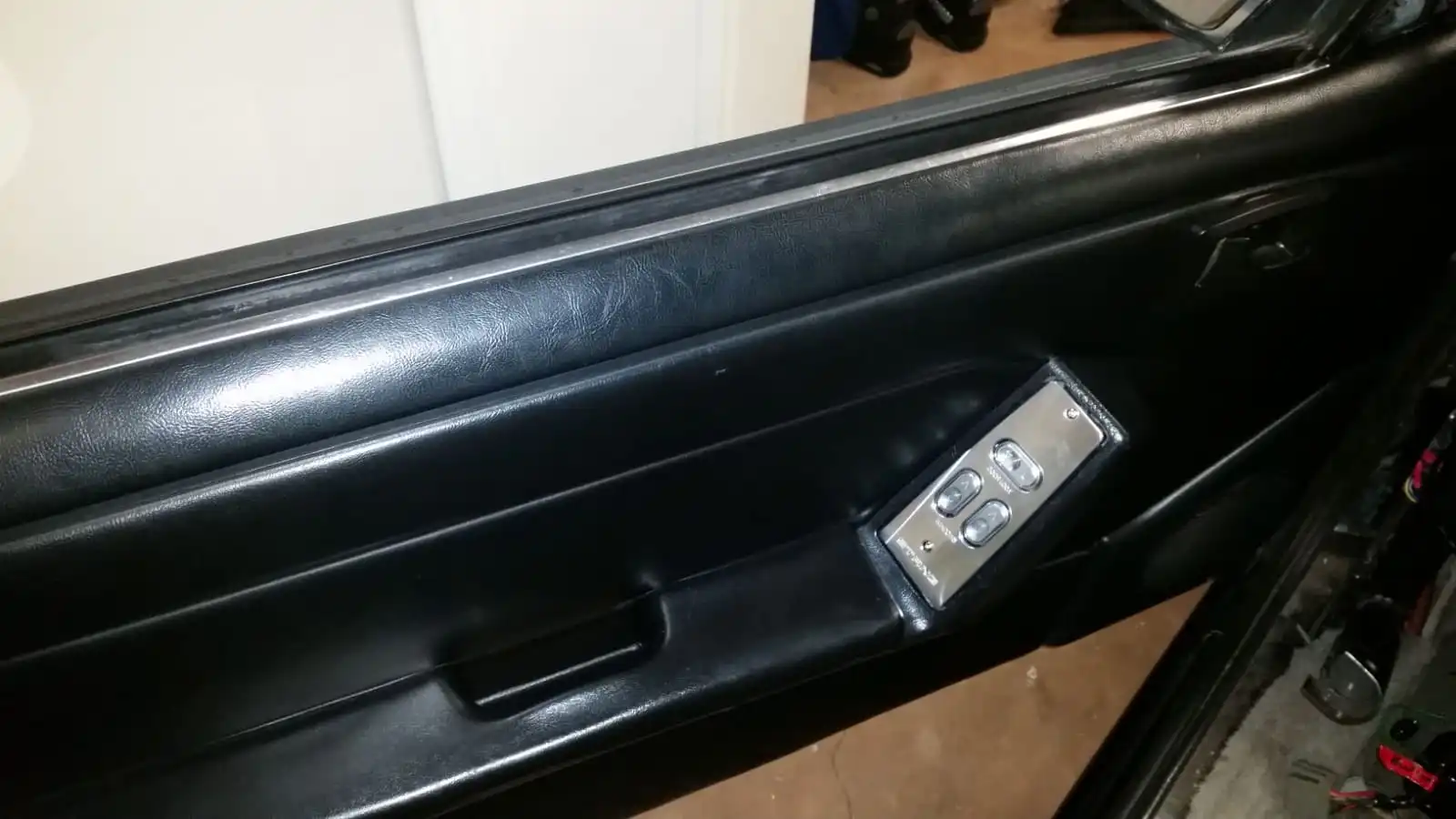

New billet door switches and panels. Not sure I like them, yet. I'm considering painting the panels mat black. I think I'd prefer it if the panels weren't screaming for attention. But, I like that they're thicker and won't wrinkle like the stockers:

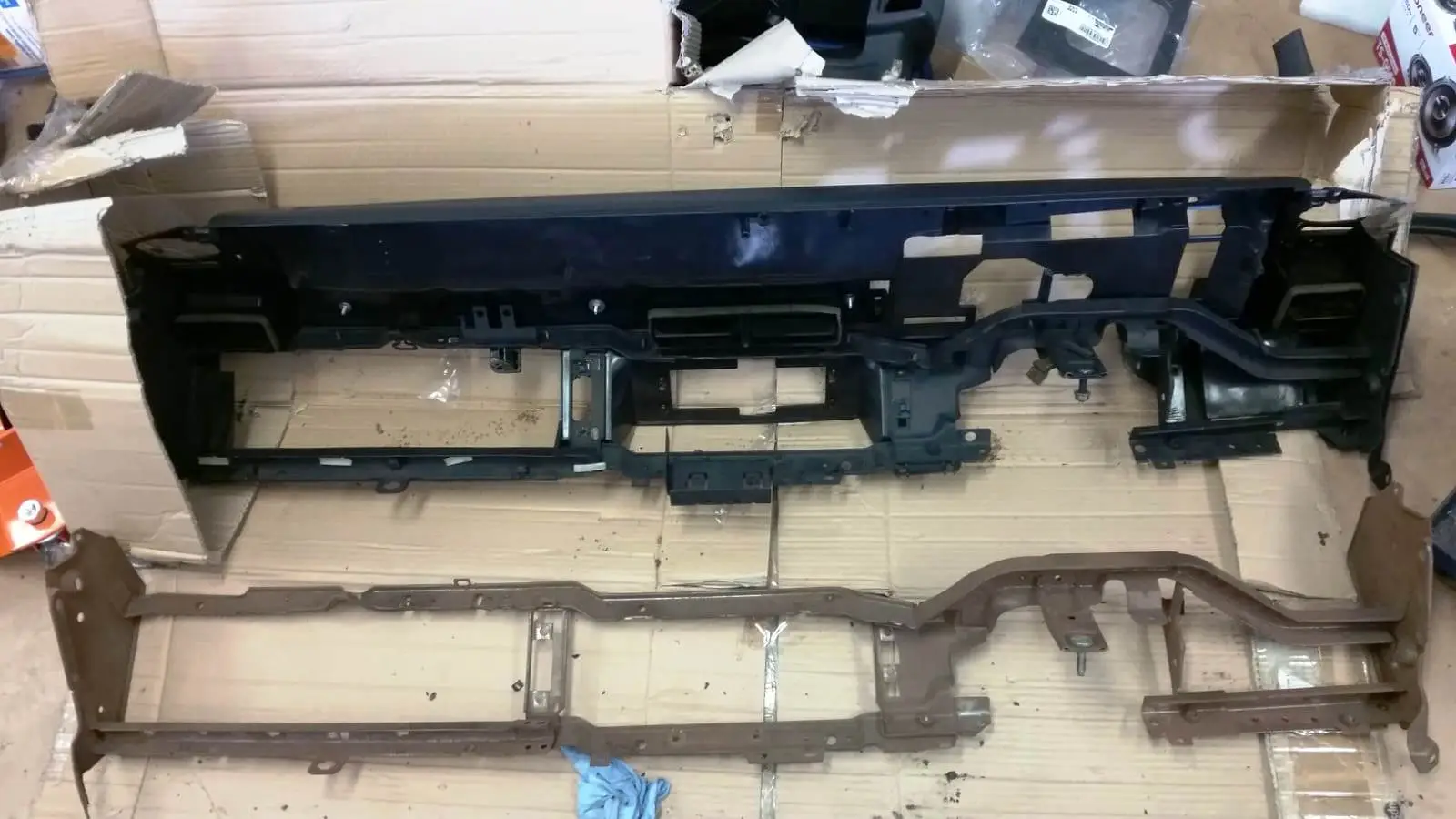

I reassembled the dash, but I think I need to put the painted brace back in the car first so I can route all of the wiring more neatly before the plastic follows it. The contrast here was a nice sight. It really looks a lot cleaner painted:
632146

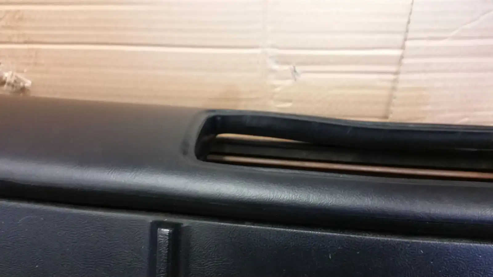

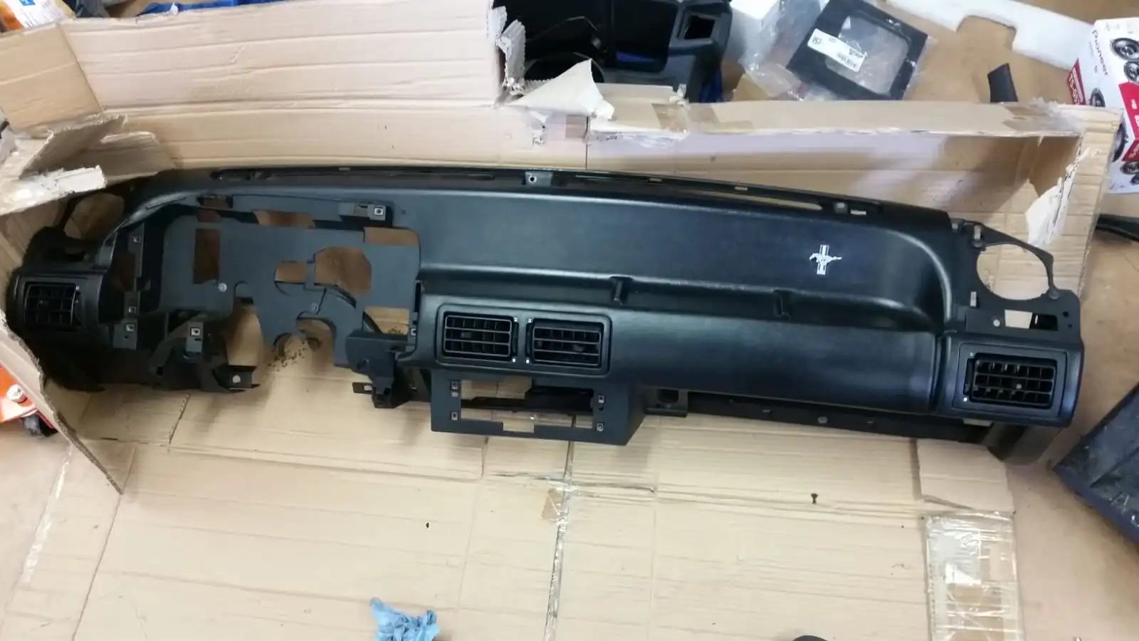

The LMR Dash pad leaves a bit to be desired. You can see the fit isn't perfect, and I didn't get a close up picture, but in the full dash pic you can see the gap on the right-hand side is also too wide. But... It still looks clean, and it's still better than most originals, now. This gap cinched down more when I tightened it, and then the vents covered it well.
632144
It's ready for install, now.

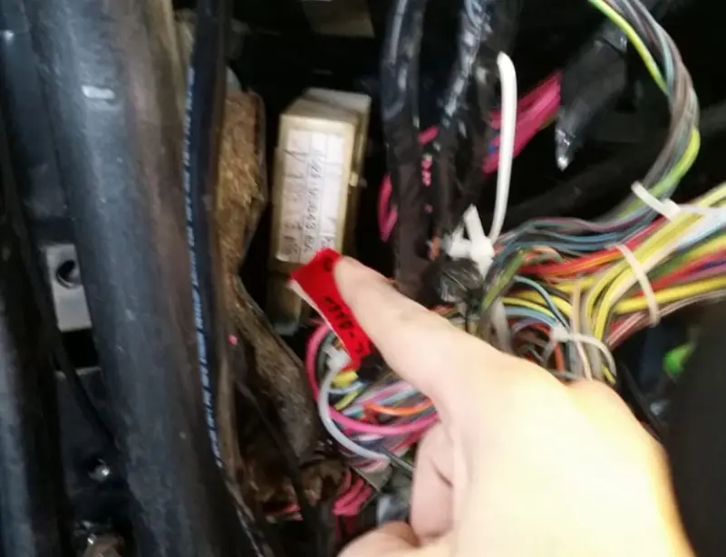

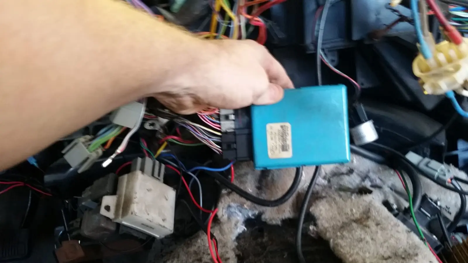

Guys, gotta admit, as an electrical Noob, I feel overwhelmed with tackling the dash electrical cluster f*&%.
Anyway, I'm just trying to work a little at a time. My goal is to identify the wires and electrical components behind the dash, and to eliminate anything I no longer use. With that in mind, I'd appreciate it if anyone can help me ID these boxes to start off with:

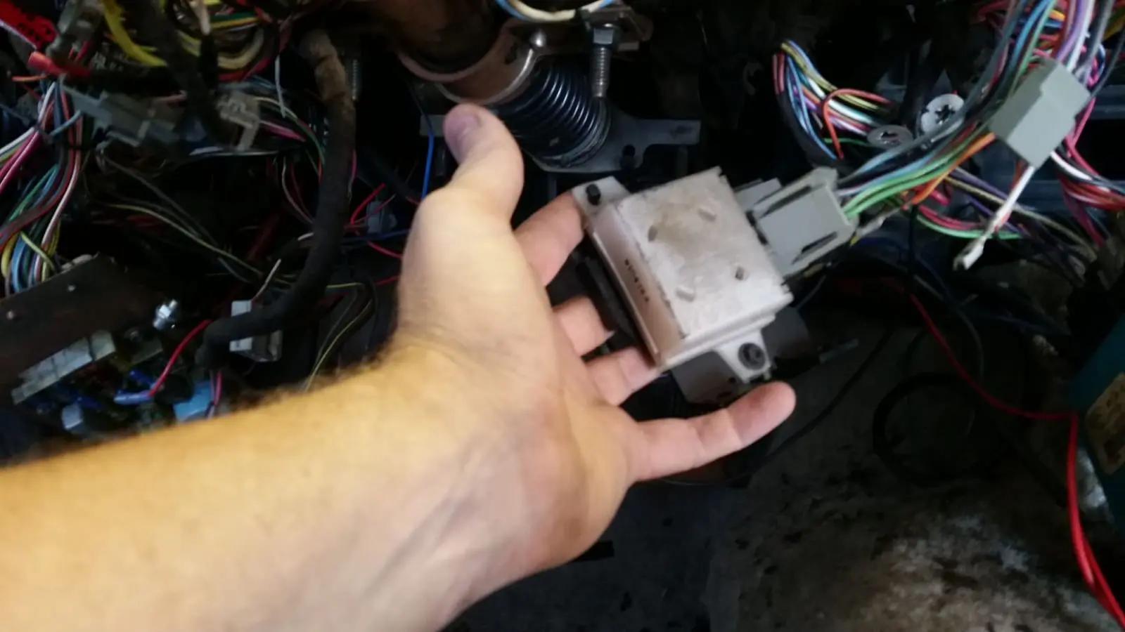

Driver's side door-well above the kick panel area:
632921

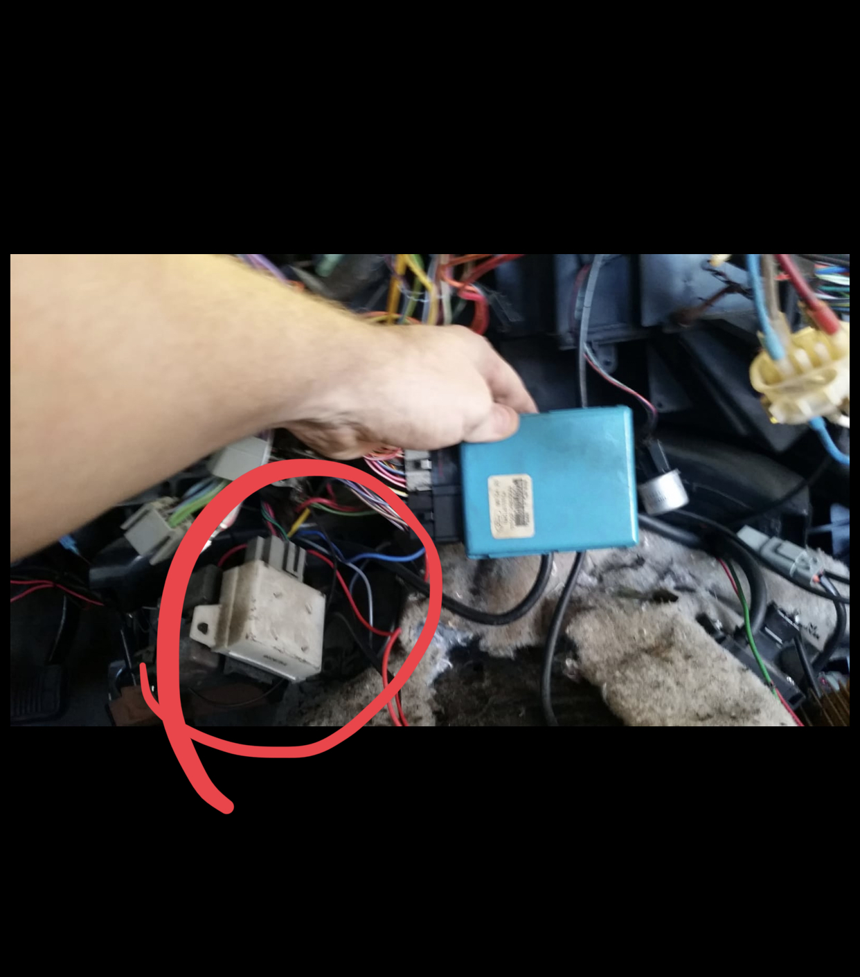

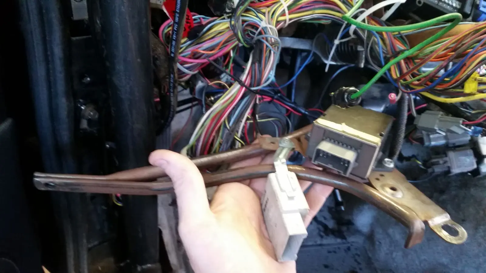

A box hanging loose above the pedals:
632922

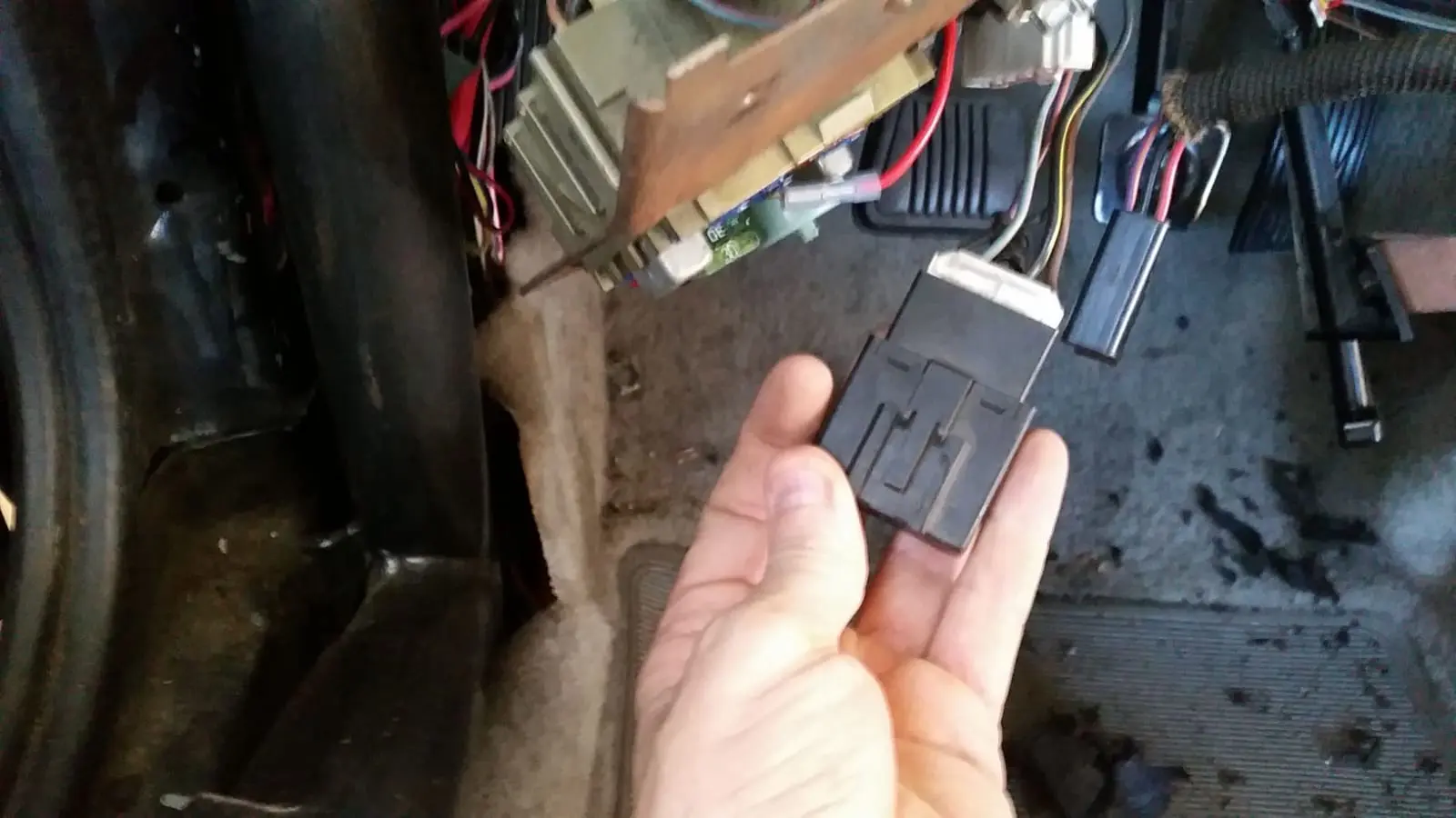

More towards the center console:
632923
Behind/ maybe above the stereo-ish area:
632925

Blue is deff air bag module my friend !! I’ve unplugged quite a few to get that beeping to stop and no more light on dash lol
Should be door chime circled in red

Awesome! I kinda thought that's what it was. It's weak as hell anyways - I can barely hear it, and I don't need a chime to tell me if my door is open, :cool: Do you know if unplugging and completely removing the wiring for either of those will cause any secondary issues? i.e. are any of the circuits run together with other circuits? I'll try and trace them on my wiring diagrams, and I'll definitely do a functions check on everything before I start removing stuff and retesting one at a time.
No sir . My buddy who I helped with his 2j fox stripped his to the bare essentials . No issues

"Driver's side door-well above the kick panel area" - 9D843 - Cruise Control Module
"A box hanging loose above the pedals" - Rear Window Defrost Control Relay - Should have 18C641 on it somewhere.

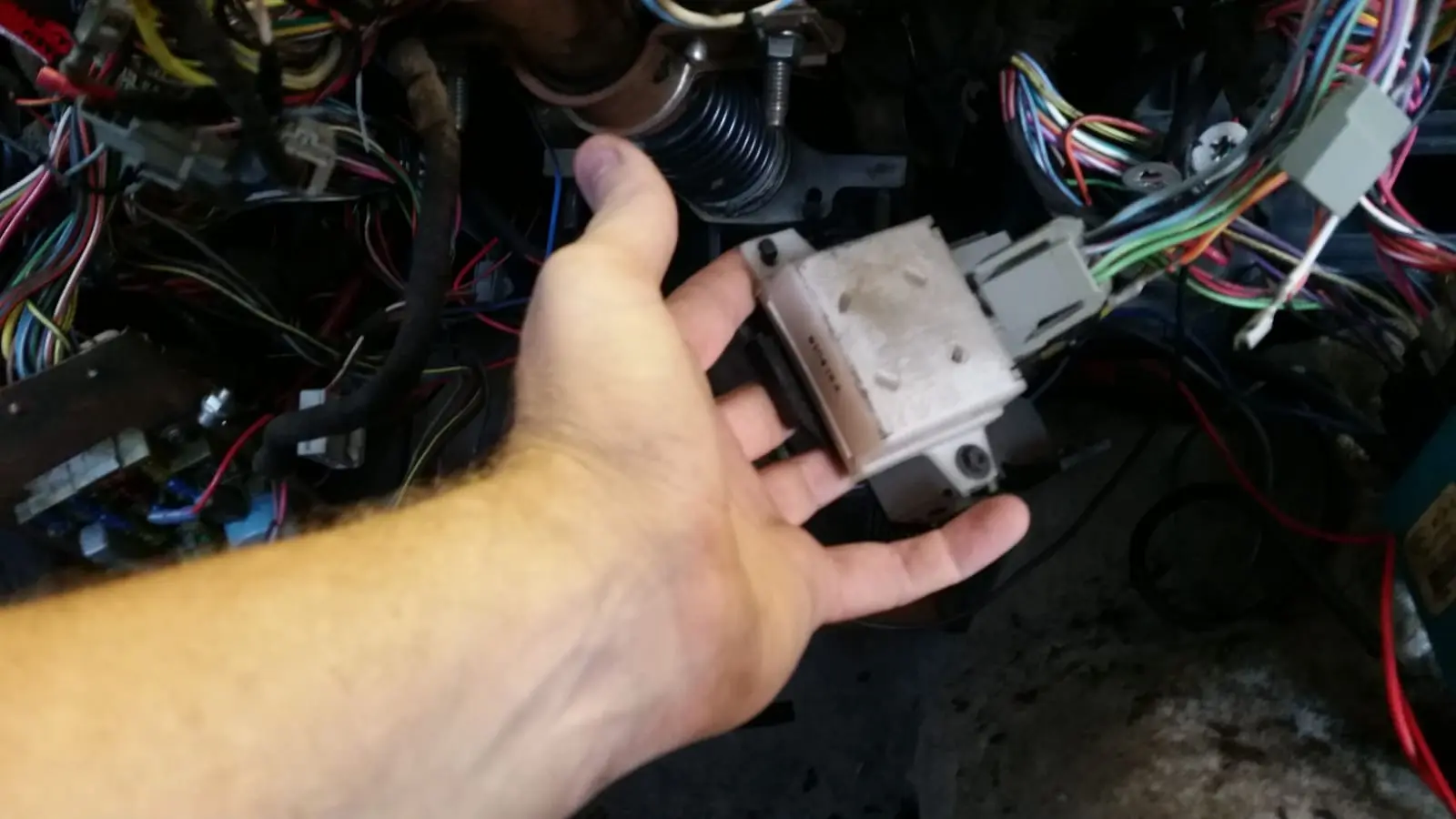

"These mount on the brace between the door frame and the steering column bolts" - The olive box with ears is the Wiper Interval Governor. The white box should be 6c625 - Low Oil Warning Relay.
For easier response/reference you should number the pics and/or put down any numbers you see on the components.
Badass! Thanks so much!
I'm going to get rid of rear defrost... so that's gone. I don't drive the car in those conditions anymore.
I'm going back and forth on the cruise control. I think I'll keep the electronics and decide on that later.
Gotta keep the wiper controller.
The low oil warning can't even do anything, anymore. I don't have the stock gauge cluster. So that's gone.
Wilco on the pic numbering in the future. Thanks again for the help.
