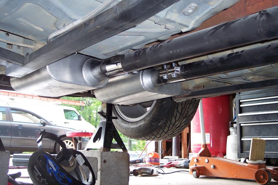

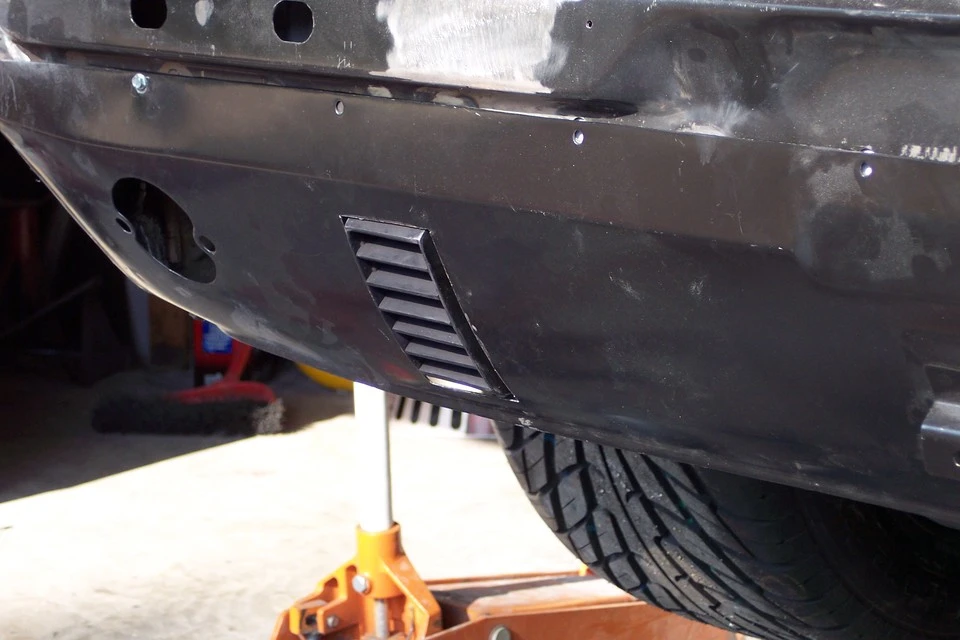

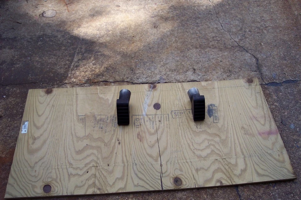

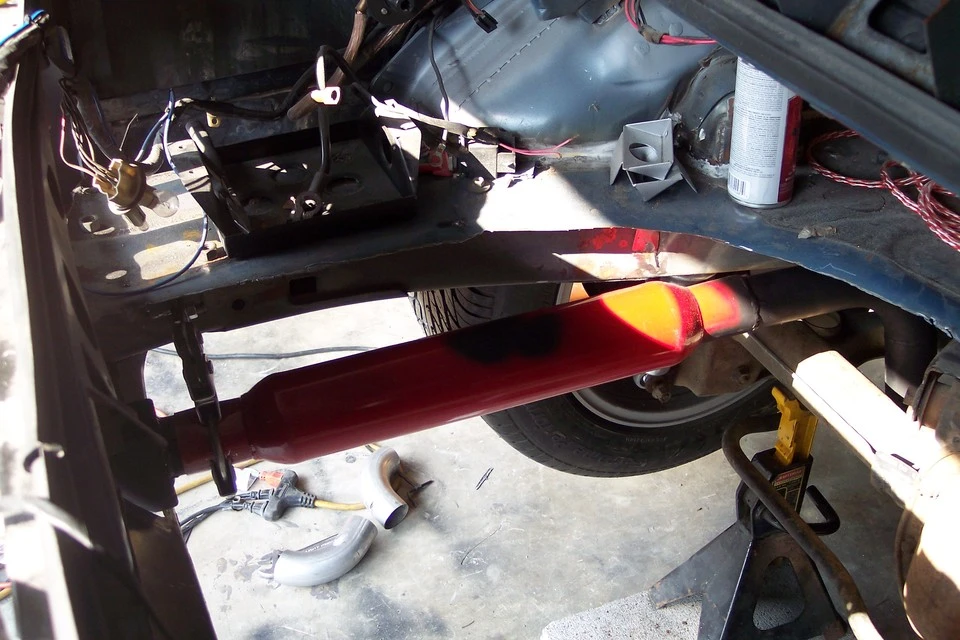

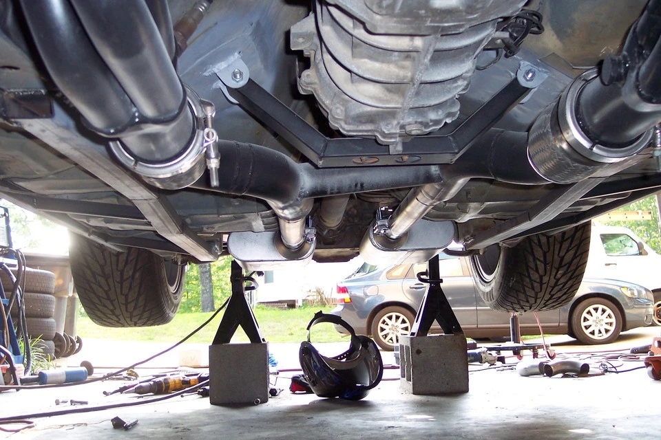

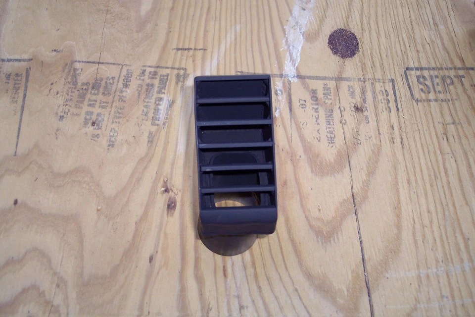

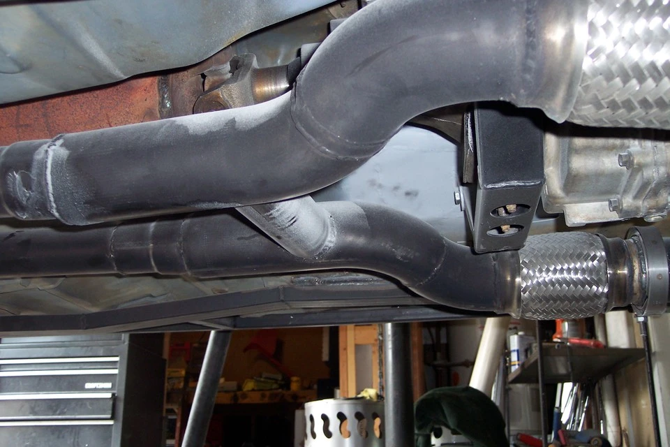

The Exhaust
It's cool having steel instead of Urethane. W/ steel you can do stuff that in urethane might crack, warp, or just plain look like hell.
W/ steel you can do crazy *****.
No, they're not drier vents.
See I saw these exhaust tips in my head. Kind of keeping w/ a F117 vectored Exhaust, And while I'm not worried about trying to disguise my heat signature like the stealth fighter does, You wont be able to see the hole that the exhaust comes out of because of the 45 degree slats that obscure the view angle. So disguised from view despite the fact that they're in plain sight = ( STEALTH)
And while I would never even attempt cutting a urethane bumper cover, W/ steel, I got no problem.
Then are you ready for......
GLASSPACKS!
Yeah I know, but before everybody goes ape***** on how stupid that is, There is a reason for them.
I want to quiet the exhaust down, not make it louder.
See there's already welded chambered mufflers on there. I am done w/ the days of loud assed exhaust and drone. I could've just put a turbo muffler on there, but the chambered mufflers, and the glasspacks work together as a muffler and resonator.
I know, there are 4 mufflers, but I don't have cats and I think another been there done that part of owning a V-8 mustang is the fact that they all sound the same,.....except this one.
Obviously there is no trunk floor. I'm gonna put in a fuel cell so that I can use the rear fuel fill. I also wanted to do the exhaust tips where I did, and the stock tank was in the way.
So that part is done. I can move along, and not have to worry about laying on my back and getting the piss burned out of me welding and grinding like what happened today.

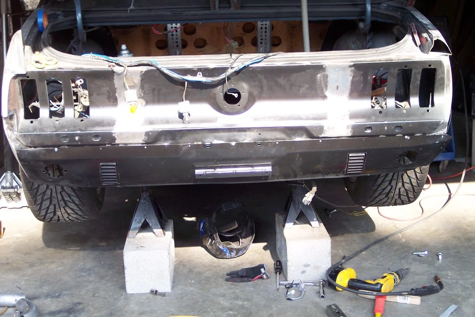

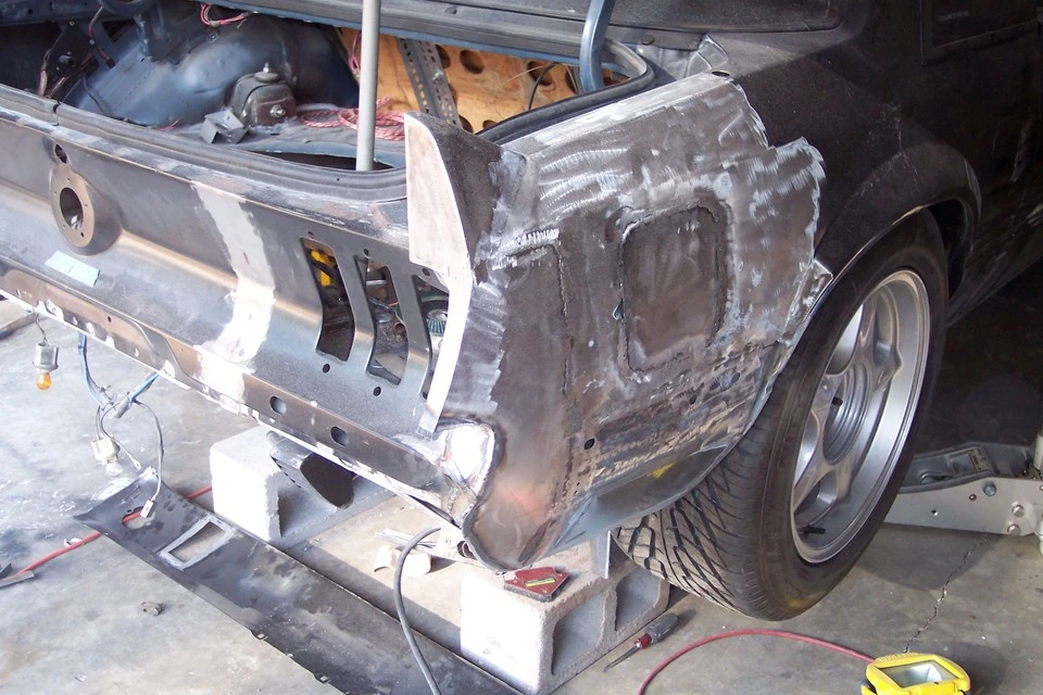

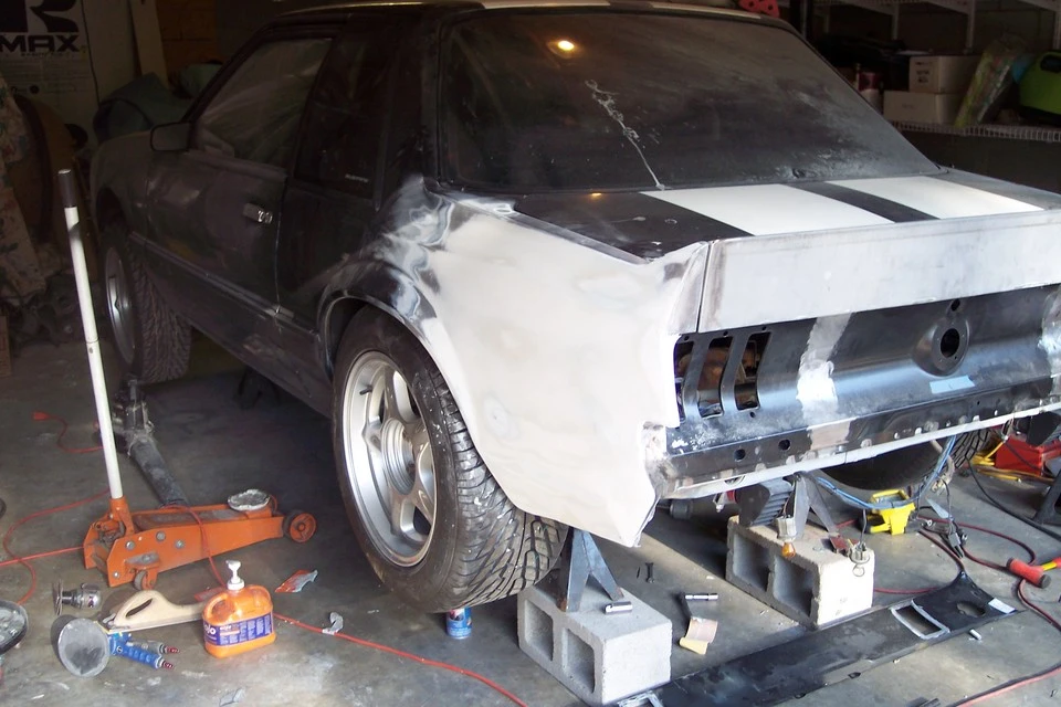

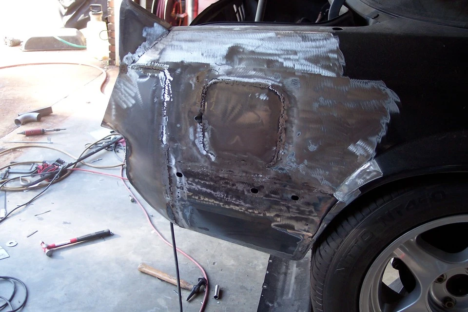

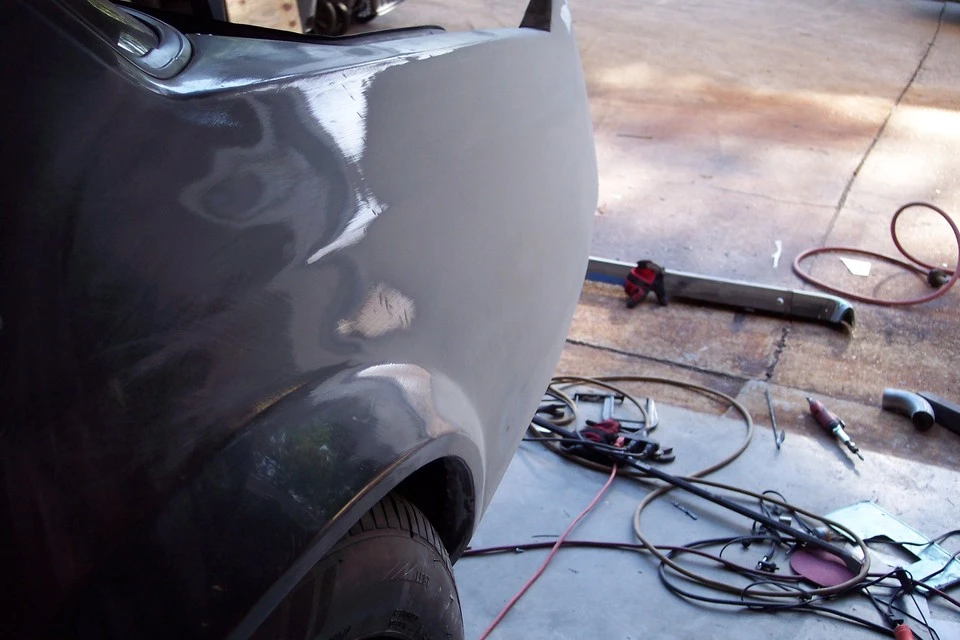

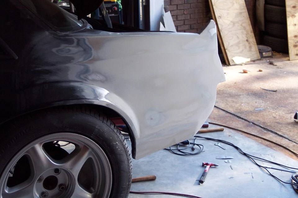

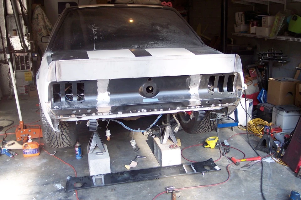

More Body work/ The Tail
Well today I decided to start on the other quarter, determined to get it to a "roughed in" status. I also slathered some bondo on the finished drivers quarter.
Obviously the gas filler is gone, I'm gonna use the rear fill and install a fuel cell below the trunk floor.
The pics never show enough detail but the quarter is pretty damn straight. I got one more smear, and it should be ready for primer.
I do have a question though Can I prime the bondo after its been sanded w/ 80 grit, or do I need to smooth it out w/ a finer grit first?
The Damn sun is always reflecting off the metal in the garage but what can you do ?
