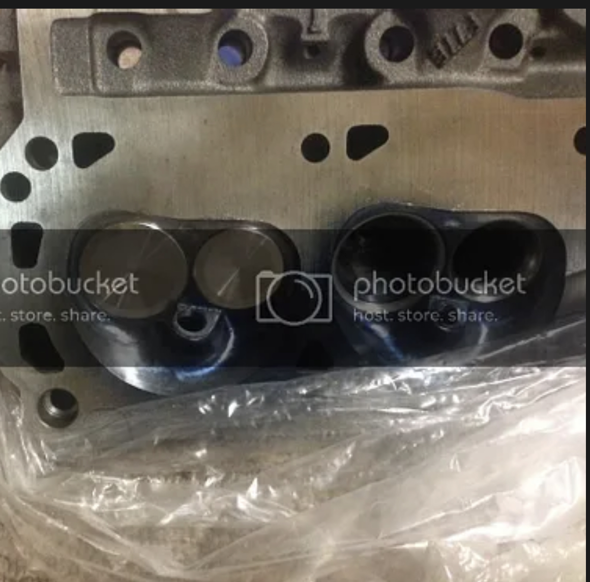

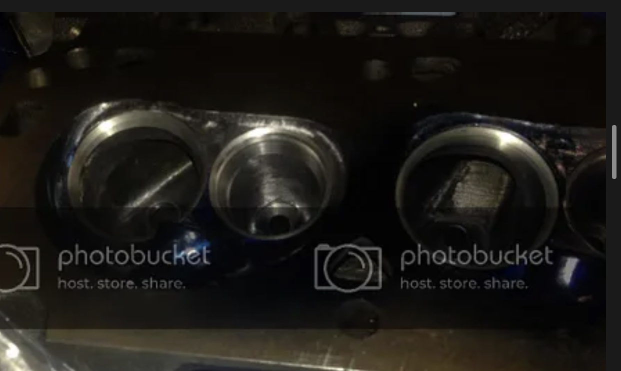

I have seen personally GT40ps make over 300
Little fuzzy memory from our cruise in group.
Local guy made 305hp to the wheel with:
Ported GT40ps, angled valve job. portrd
Explorer intake, Tlower
Matched 75mm throttle body and 75mm MAF
30lbs injectors
Anderson PowerPipe
Anderson cam N-41
Roller rockers
Taylor wires, screaming demon coil.
255lph pump
Tuned on 93
I made in the 270s with
GT40ps, smoothed but basically untouched
Crane 1.7 roller rockers on beehives,
Cobra intake,
75mm maf and 70mm Tb with
24lbs injectors
255lph pump
14 degrees timing
SVE CAI
No tune, just fun dyno rollers at a meet.
Just to give you a reference

Its a very budget friendly setup, just know you can possibly pick up aluminum used heads after paying for port work.
Also the GT40ps heads that cracked over 300hp
As you can see they were worked

I have no issues with my promaxx heads. My head guy said they looked great and he could improve them with a little bit of porting but didn't think it would be a huge improvement. I thought the springs were a bit light so i swapped em out. @a91what also runs them and i think he's happy with them.

They charged me 260 ported to a 1262 flowed before an after and returned . He got it back fast too .
