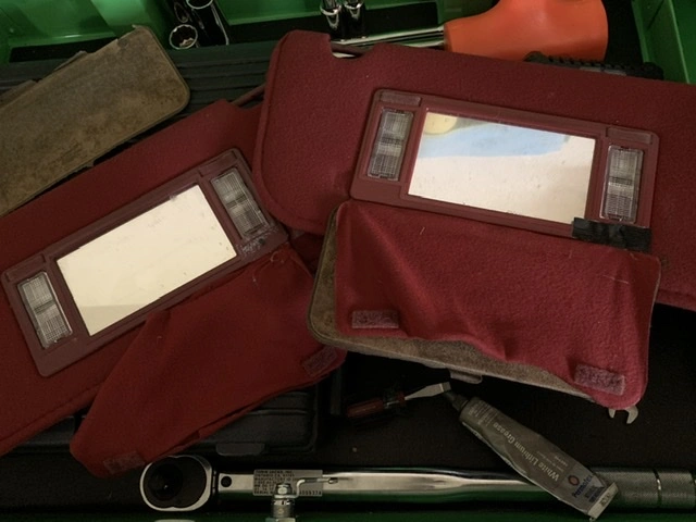

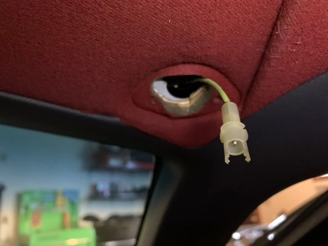

If you are talking about the vanity light in the sun visor yes, remove the three screws, take the visor down a little and there is a wire with a connector, just be careful when you put the visor back you don't pinch the wires.

Took the sun visors out. My wife is going to attempt to sew them back together.
Reactions: 90sickfox and Olivethefet

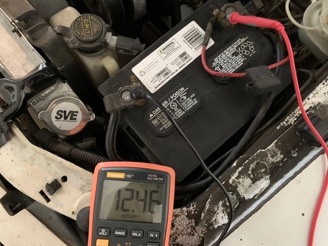

Have you checked voltage across the battery terminals? Start with checking it now, and then see where you are in the morning. You’ll know if it’s holding steady after getting it charged up.
Voltage is varying between 11.xx and 12.xx a little less than two hours since we drove it. Started it again after checking voltage...cranked right up.

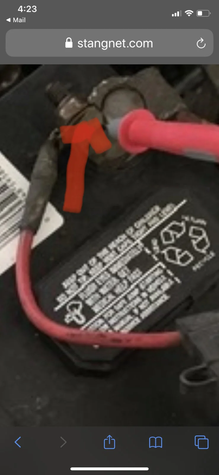

is that positive battery terminal cracked?
Reactions: DudeStang
Indeed. Just realized that. I think I forgot to mention, I ordered the PA performance premium battery cable kit. It should be here tomorrow.
Reactions: Rdub6

Is that the static battery voltage (engine not running)?
What does it read with the engine running?
Yeah, you need new cables.
That was without the engine running...need to do it with engine running too and report back.
