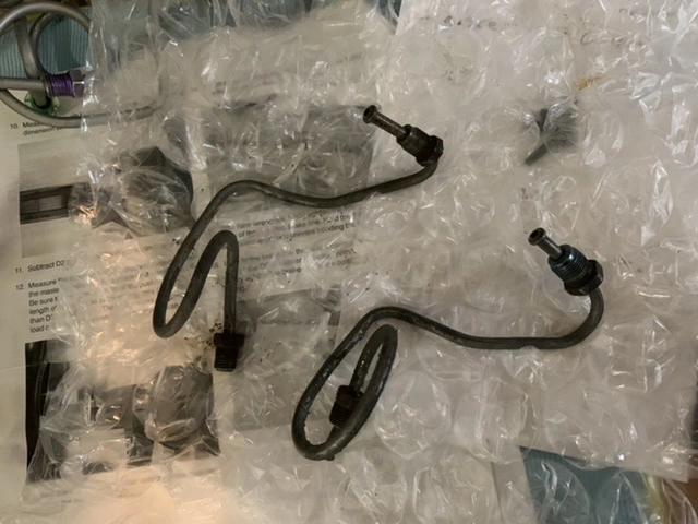

I believe those lines are arriving today.
I should have cleaned them up for you before I sent it. A little scotch brite on the lines should clean them up nicely. I was just more concerned with sending them out to you ASAP.
No worries. I am just happy that you had them at all and were willing to send them my way.

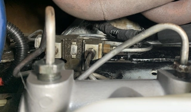

I see what you meant about one of the fittings being tight. I just took a quick look before eating my lunch but it seems they will fit. I probably just need to loosen the PV mounting bracket nut to have more flexibility getting that line into the PV. Thanks again!
Maybe if you soak it in penetrating fluid overnight, and gentyly work it it might come loose. Maybe a little heat would help too?
Or just thread that one in first, and then you should be able to get the others on there.
I might try the penetrating fluid. I tried to thread the tight fitting in on the PV but because of the shape of the line and the PV bracket being secured, I couldn't turn the line at all to get past the first thread.

Don't be afraid to adjust (bend) those lines a little so they go straight in the block. Kinda push the line all the way into the block when you start threading in the fitting, maybe start the lines (loosely) in the block on the bench, bolt the block to the frame rail then start the lines in the master cylinder, then tighten them up.

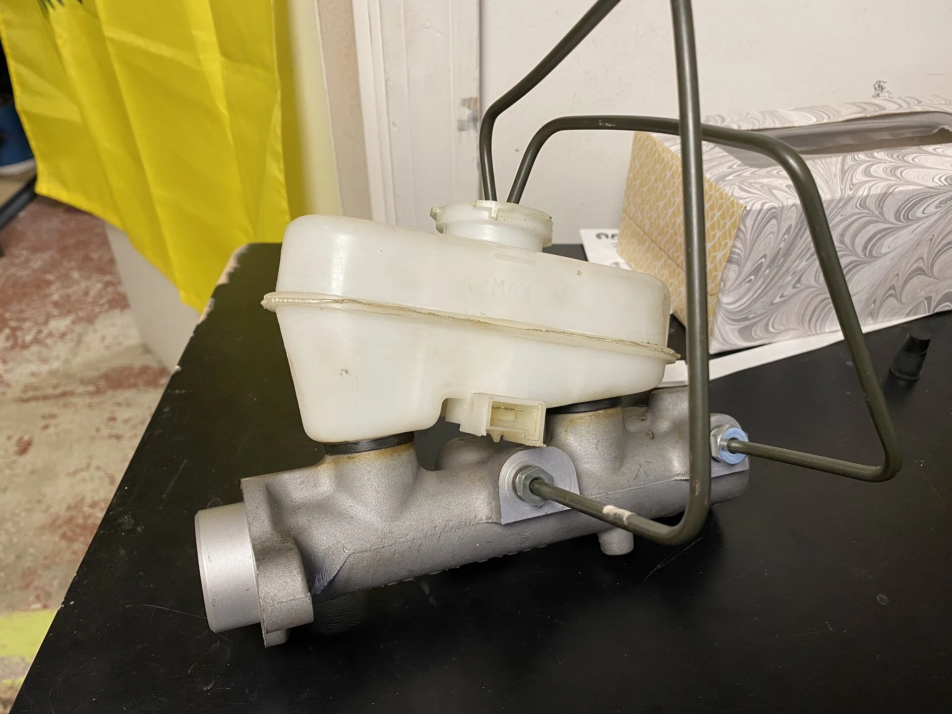

Ok so I did the bench bleeding (correctly I believe), but it took a while because I had a little bit of a leak in one of the plastic pieces on the front port and didn’t notice it at first.
I tightened the plastic piece a bit more and it stopped leaking fluid, then I pumped it another 10 times or so and stopped seeing bubbles come up. Unfortunately, when I moved the MC to put it on the brake booster, it took me FOREVER to thread the rear port brake line into the MC. The front one went in fairly quickly.
I’m assuming the long time it took for me to hook up the rear port line let some more air back in the system. Do I need to redo the bench bleeding or will I be able to fix this when I actually bleed the brakes?
Did fluid drip out while you were fiddling with it?
Should not be an issue if you uncapped one line, installed the line then uncapped the other and installed the line.
I put vacuum caps on both ports to move the MC to the car after bench bleeding. I left the vacuum cap on the front while I fought with the rear line...then gave up on the rear for a bit and focused on the front, but I forgot to put the vacuum cap back on the rear. A little bit of fluid did drop out.
Your fine. Bleed the rest of the system and then pump the pedal with the engine off. Should be hard as a rock.
if there is a little air, one way to “cheat” is to Jack the rear of the car up high enough that the MC is level and then bleed the brakes. This is an alternative to bench bleeding as it’s the angle of the MC that tends to trap air in the front of it.

When you bench bled the MC, was it perfectly level?
here’s how I typically did mine.
I then hold the nose up against the wall, hold the MC perfectly level and push with screwdriver. Few time until no more bubbles. I then install the MC like this, and the remove the lines one at a time and install the vehicle brake lines.
if you don’t want to pull it apart, Jack the rear of the car up high enough to level the master cylinder. Needs to be completely level across, then bleed the brakes normally.

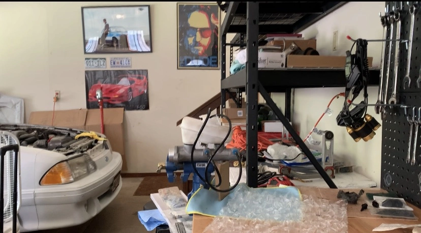

For the bench bleed - I had the MC in my bench vise. I think it was pretty even. I had a pretty sturdy piece corner shaped piece of cardboard to give it a little more support on the front end. I didn't take any pics but here's a screenshot from recording for my next video.
I did the bench bleeding as described by folks in this thread and according to a few videos I watched (seemed to be pretty much the same process described in the few resources I pulled together/read/watched.

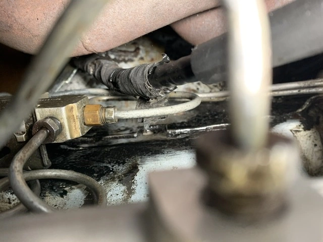

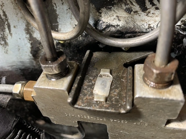

Another concern I have - the brake lines that run from the MC to the proportioning valve, on the PV end, there is a little bit of fluid showing so it seems they aren’t screwed down/tight enough. I used flare wrenches but they could only get them so far in and I don't want to strip or break anything.
Yeah, I think you need to go a little tighter.
