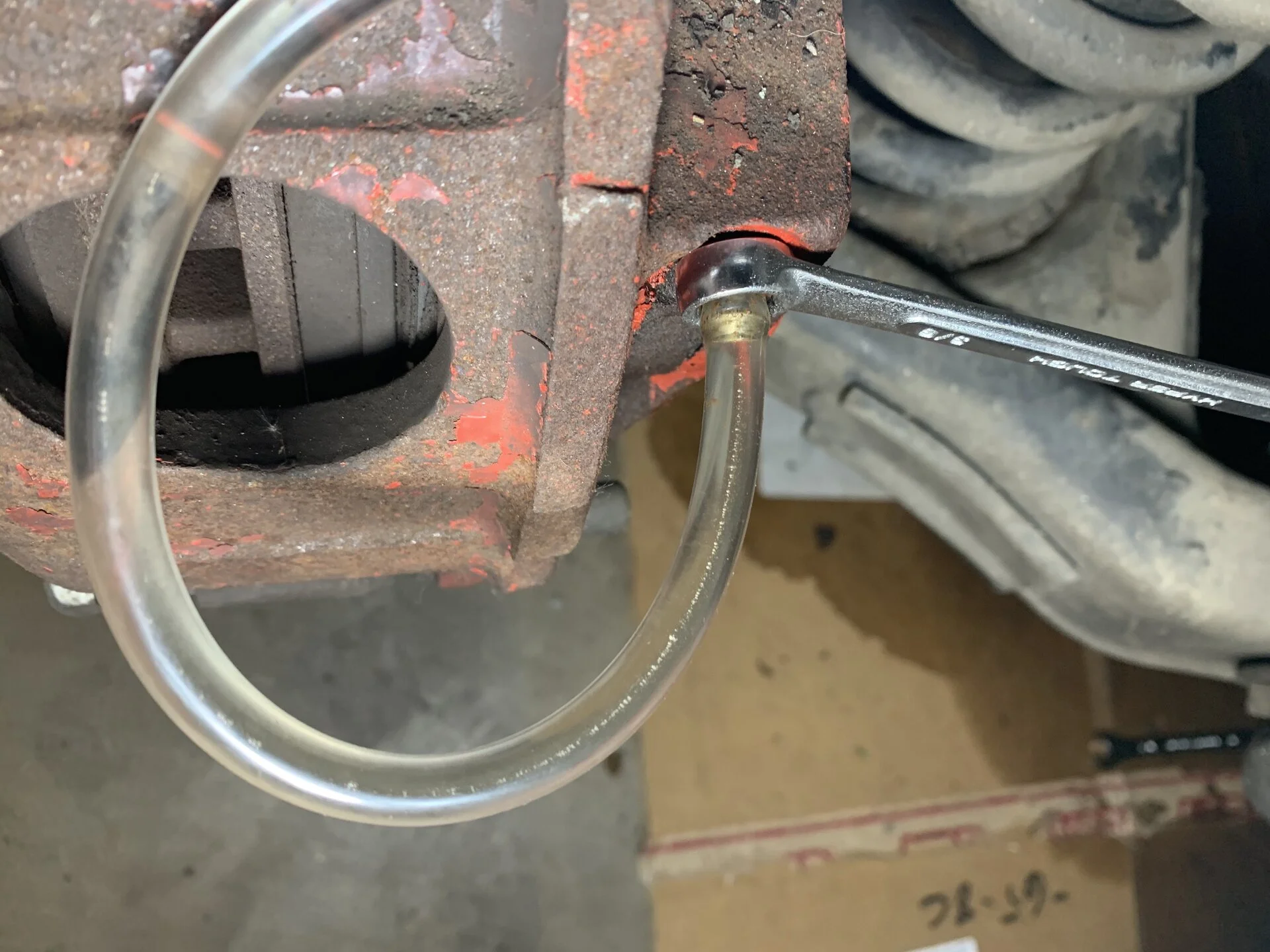

I did the bleeding process again, exactly as you described. I had the aftermarket proportioning valve screwed all the way in (slightly over 5 turns to get it all the way in). Went from rear passenger side to driver rear side to front passenger side to front driver side. Waited until I saw clear/new fluid before stopping, seemed to get most of the bubbles out (though I still saw some really tiny bubbles in the tube on the front driver side - pic below) and eventually no matter how hard or fast my wife pumped the pedal, the fluid stopped moving.
I kept an eye on the MC and added fluid every time it started to get low.
No change in the pedal feel. Still very little resistance, sort of squishy feeling. I’m close to stumped.
At this point I’m wondering if the brake booster or MC is just not engaging the way it should and maybe I need to take everything back out and start over.

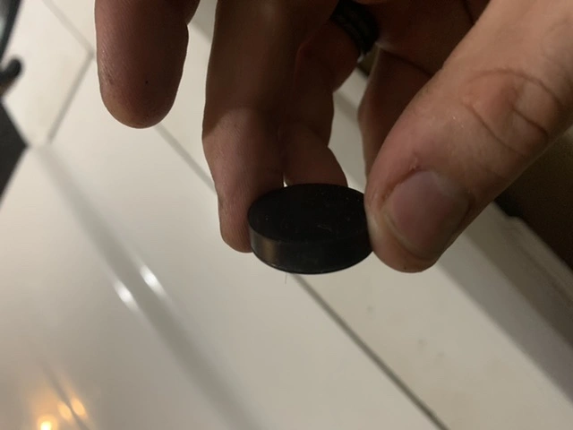

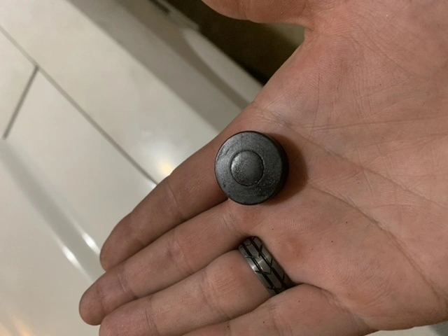

Just drove the Fox for the first time in two months. More details to come but this (or the lack of it I should say) appears to have been the source of my woes, lol.:O_o:

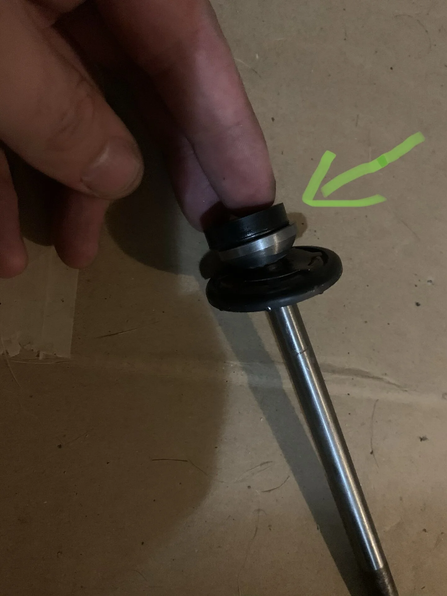

So I don’t know what that piece is exactly but the one in that pic is from the pedal end of the pushrod on the original brake booster. The reman brake booster had one as well but it wasn’t attached to anything...and there was nothing in the instructions about it so I didn’t do anything with it. I had not opened the original booster so I had no idea what it looked like.
At the suggestion of my mechanic neighbor, I ended up taking the pushrod out of my original brake booster and noticed that it had that plastic piece on the end of it. So it seems like the pushrod wasn’t engaging the master cylinder fully until I put that piece in (and did the measurements again).
