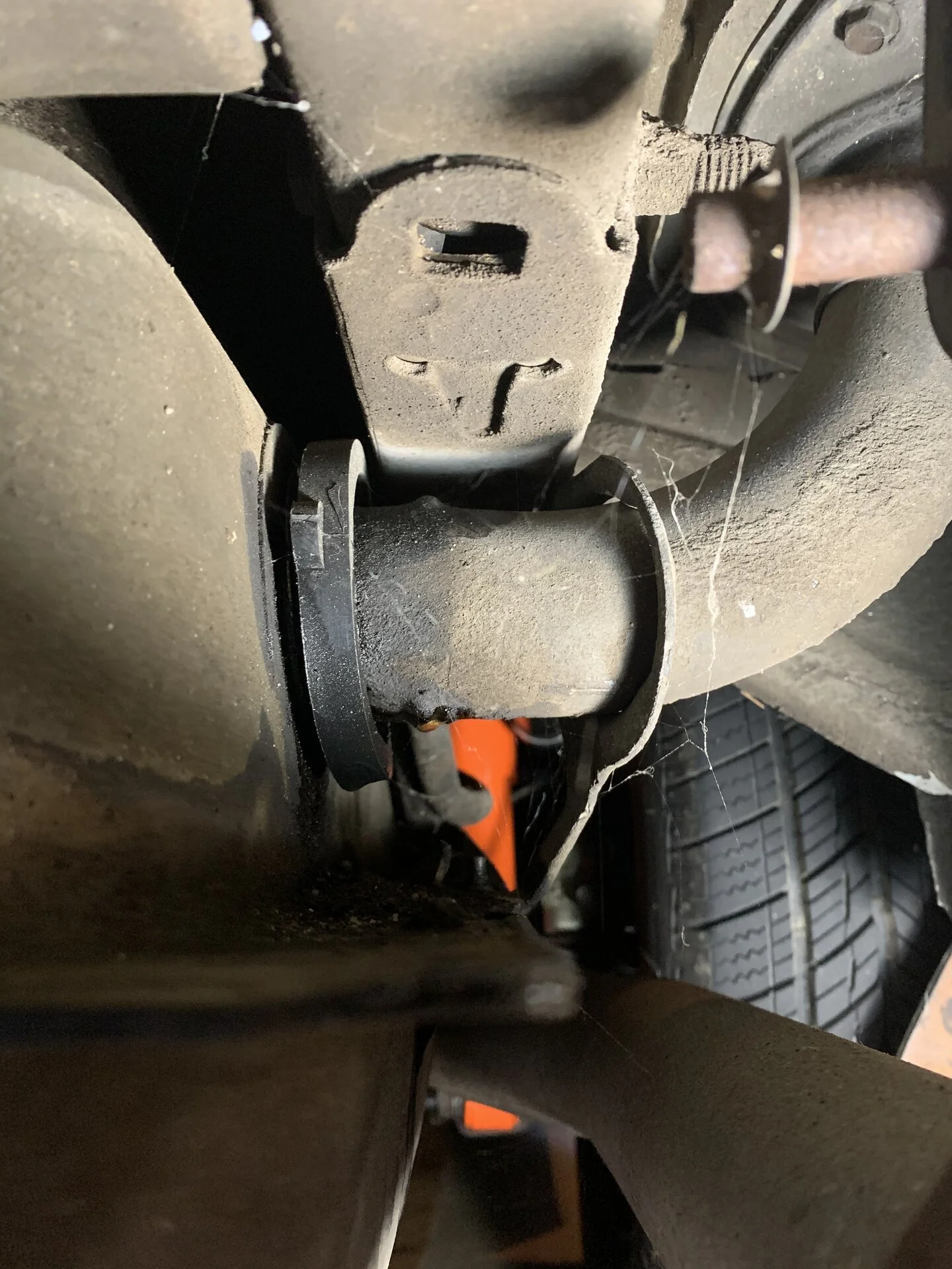

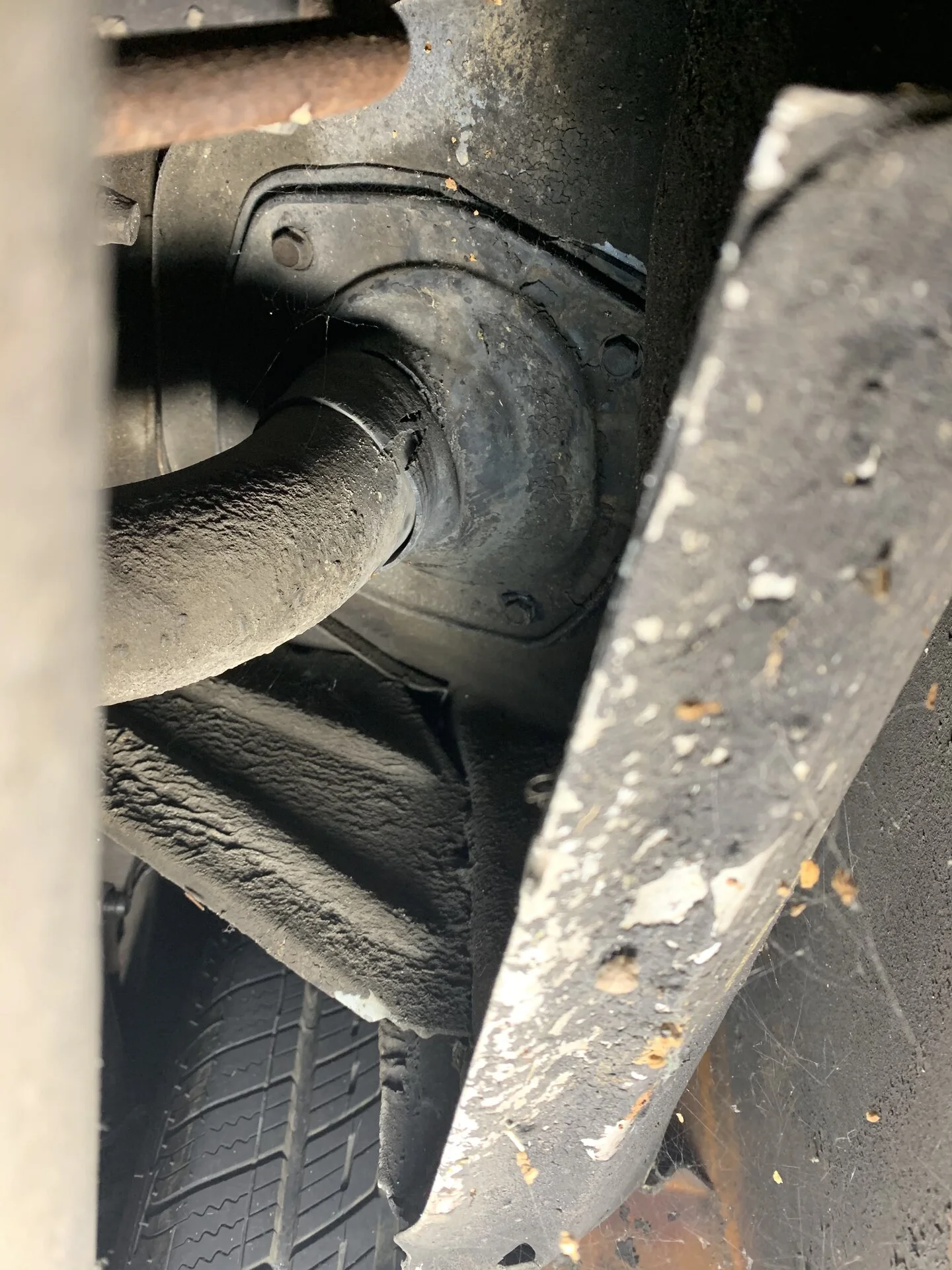

I filled the tank a couple of nights ago...not sure about the vent line but I can take a look when I can get the wheel off next.Did you recently fill the tank? Maybe you knocked the vent line loose when you were doing the shocks?
You think it makes sense to drop the tank and try to identify the source of the leaks, maybe see if any seals or lock rings need to be replaced, before buying a whole new replacement tank?Methinks your next project is to drop the tank
What all did you replace with your refurb?Thinking about it more, General is probably right, and it’s probably been going on for a while.
One leak (if you just knocked the vent loose the other day) would not have the rubber pads degrading like that.
Theres probably a slight leak that finally showed its face the last time you filled up, and has been wearing that rubber down for a while.

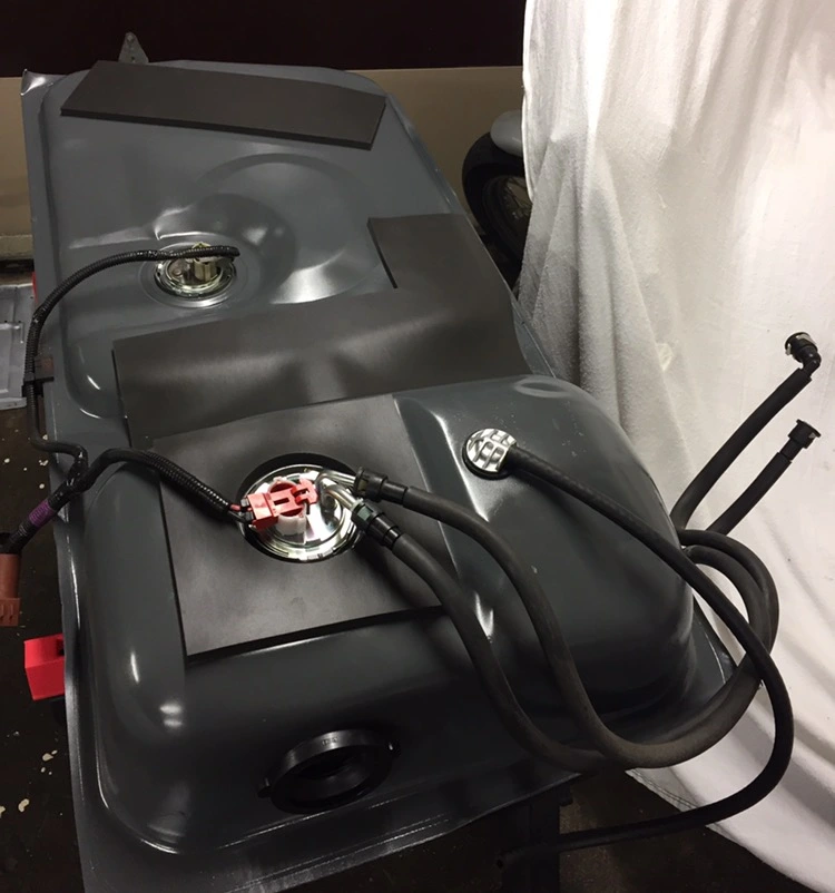

I just did a refurb on my tank, rather than replacing. Other than my bone head move of not fully tightening a lock ring at first, everything has been good! New fuel pump, new sender, new vent, and all seals and rings.
I think I'm going to need to pick one up soon...I think there is a thread about keeping a fire extinguisher in your car around here someplace.
Just realized you already partially answered this before I asked the question...since apparently I can't read. Thanks.Filler neck seal - vent and grommet - sender, seal, and ring - fuel pump, seal and ring. Also redid the seal at fuel fill and new gas cap.

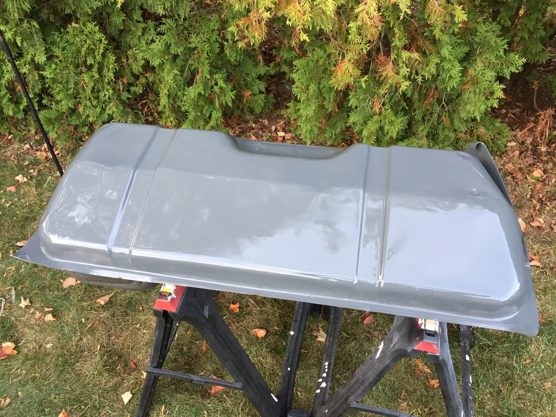

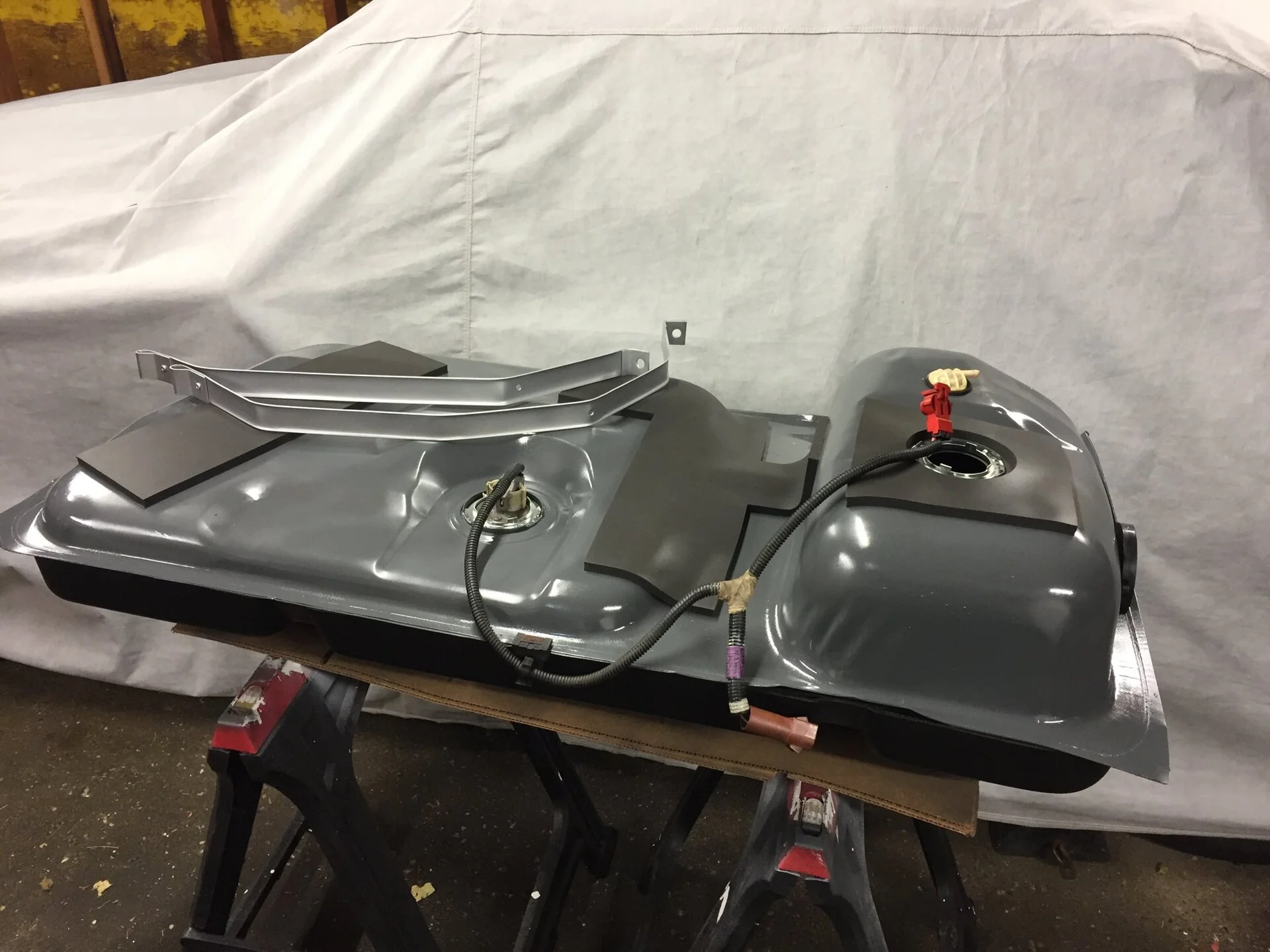

Sanded the tank and straps down, and repainted all. The pads up top were in decent shape so I kept them. I just masked them off when I painted.
I also had all my fuel lines out at the same time, while I was welding in my subframes, and replaced all the flexible nylon portions of the lines. The steel lines I just sanded down with scotchbrite to clean them up.

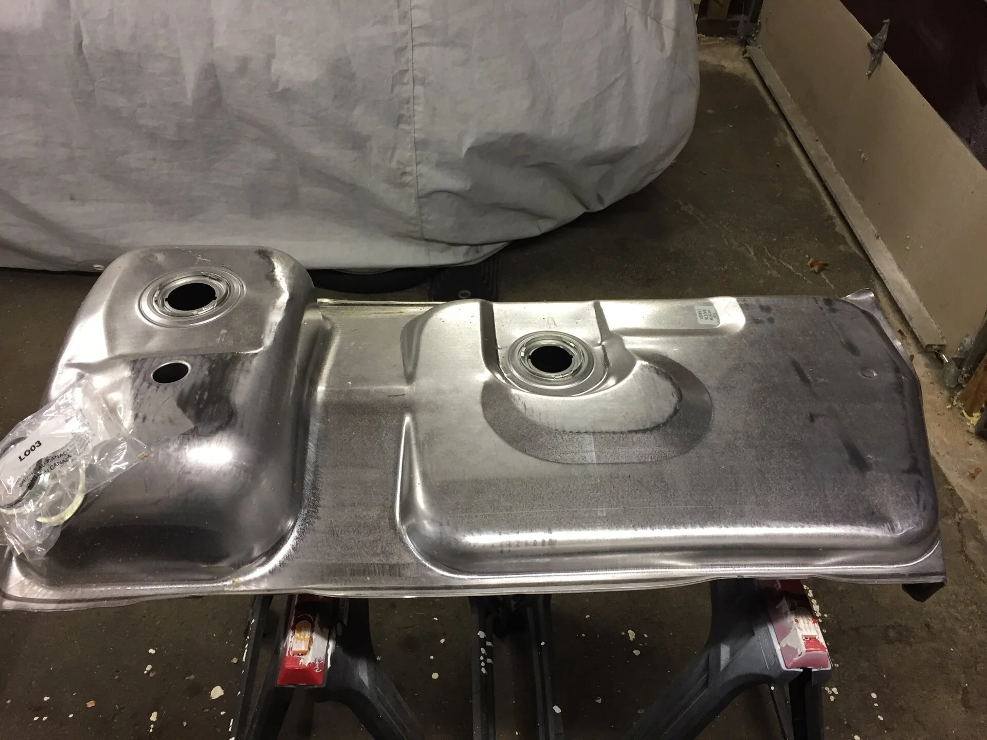

Thanks for sharing details with pics. Did you know the baffle was broken before you dropped the gas tank? I read that there's a lot of noise when the baffle breaks and is moving around.All the parts are available. How crazy you go in your refurb all depends on you level of anal-retentiveness.
When I did mine, I had to replace the tank due to a busted baffle. Since I got a new tank, it snowballed into getting most of the other components brand new, along with lots of paint, and elbow grease.

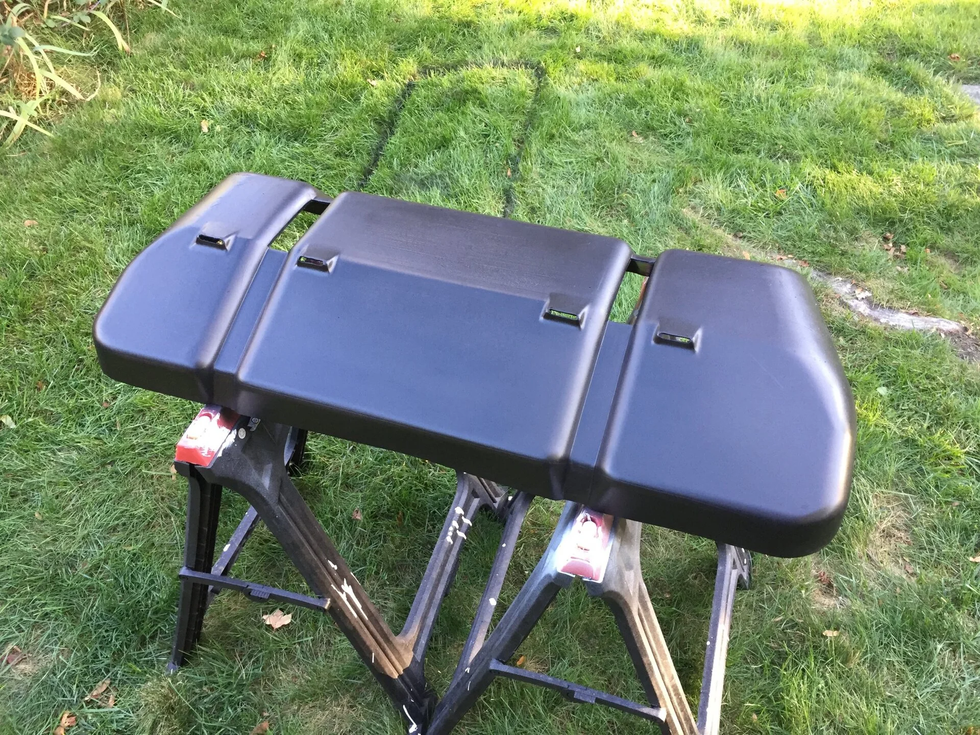

Also a few coats of SEM trim black on the tank cover make a huge difference
New tank, new tank padding, new fuel lines, new tank filler grommet, new fuel pump, new fuel pump hanger, painted everything, redid the wiring harness. Probably stangnets most detailed gas tank ever to grace the pages of the Forum
I just looked at the fuel filler and it looks like where the neck attaches to the gas cap area definitely needs to be replaced, and there looks to be more spillage/residue on the end that goes into the fuel tank itself so I am thinking I will just order the whole fuel filler neck kit and replace all those parts.

It looks like you upgraded the fuel tank straps along with everything else. Where did you get those? I looked at some on LMR but noticed a few comments saying there were fitment issues.
