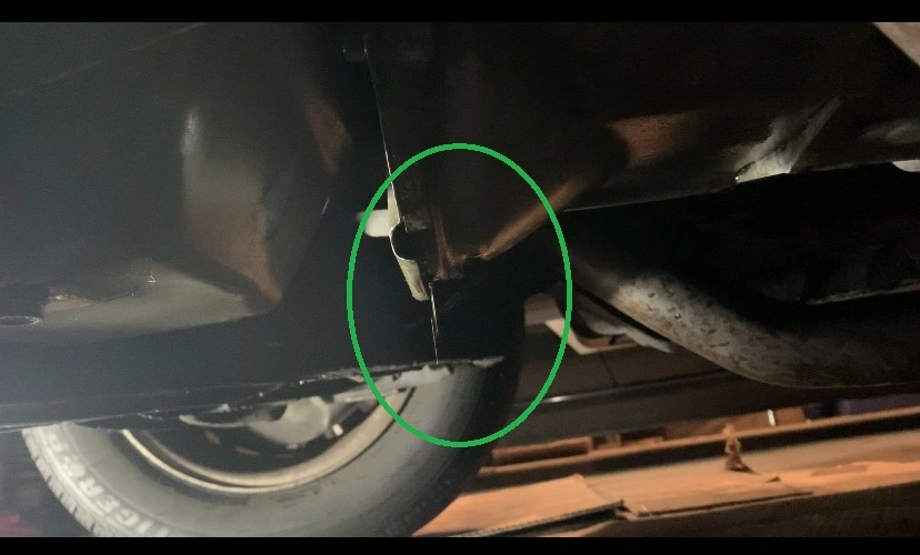

Last night, after driving the car for a bit, I recorded a little video under the car. This is just a screenshot from that recording but I think it is safe to assume that a steady leak coming from this area (the thin line coming down is the leak, mid-drip) is a rear main seal leak.
I'm not super confident in my ability to drop the transmission by myself and I don't have a trans jack yet. Also, given the colder temperatures, I'm not too keen on spending a lot of time on the garage floor over the next few months. I have read through a few threads where some folks say oil leaks aren't the end of the world and to just keep an eye on oil levels until it's time to do a few things that can all be done at once, while dropping the transmission (rear main seal, clutch/flywheel, pinion seal), BUT considering that I would like to try and use the car for some track days in the summer when *fingers crossed * things start opening up....I'd like to get the leaks addressed sooner than later. I have tried to contact a local shop that appears to do a lot of work on Mustangs to see about a quote for that work but haven't heard anything back yet.
A friend of mine is coming to visit this weekend and we're planning to try and replace the power steering pump on Saturday since the weather is supposed to be slightly warmer than it has been.
I think at this point, many fox bodies have some sort of rear main seal leak to some degree unless the motor's been freshly rebuilt.
When you do change it, grab a seal and the Felpro sleeve and install tool. You might not need the seal, but when you get the old one, inspect the crank for signs of a wear groove forming. If you see one, install a sleeve otherwise a seal without one will probably leak right away.

And thread sealant for the crank bolts, they go through to the inside of the engine

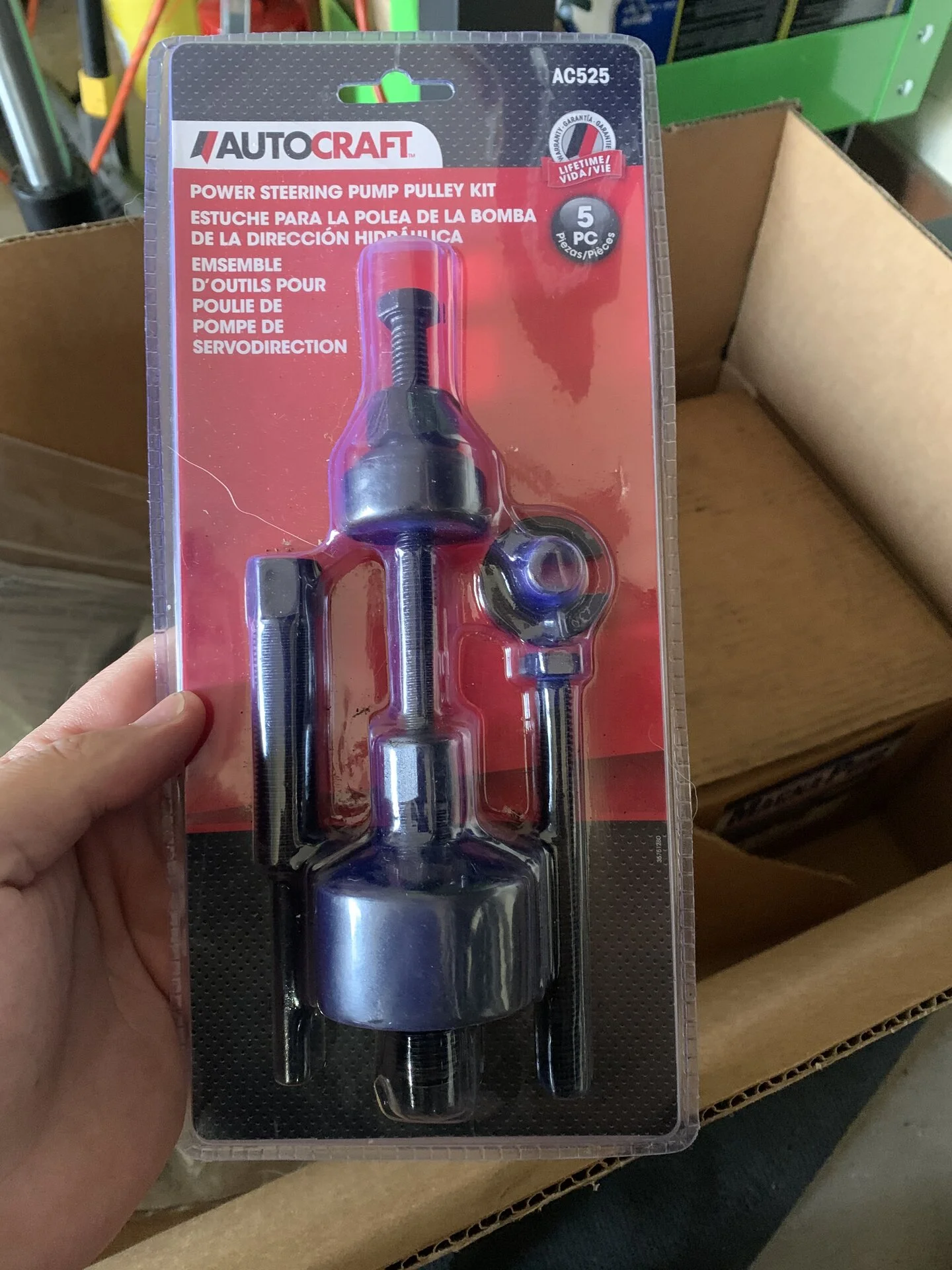

Do you have the tool to remove/install the ps pulley?

With everything you’ve done...... you can easily do the transmission removal/install.
Trans jack not needed. I balanced it on a regular floor jack, had my daughter operate the handle to raise it up and I got it in place to bolt back on. If the car was higher in the air, I could have lifted it in, but it was tough to maneuver. Don’t pay for labor on work you can do yourself!!
Reactions: General karthief and DudeStang

Dropping a trans by yourself with a floor jack the first time is a tough job, and putting it back in ain't no picnic. It can be done but it's tough don't kid yourself. I've done several times.
Get a driveshaft yoke or a plug for the trans to keep the mess to a minimum.

First time I did it myself, I used the floor jack method. The trans slipped, I went to catch it, and it fell to the ground and crushed my hand into the pavement. Ended up with an ER trip and 5 stitches. Still have the scar on my hand to remember that by.
Latest time, I went to harbor freight and bough the trans Jack. Did it alone and it was much easier and trouble free.
If oyu go with the first method, have someone help. Those trans weight 75lbs or so but it's awkward.
Also, make sure you rent the PS tool and have it handy before you attempt the PS pump swap.

I'm going to give this a try.

I appreciate the vote of confidence, haha. I am tempted to try it but I'd definitely prefer to have at least one other person around to help and to have a transmission jack.

Thanks. Yeah, I would be less intimidated if I had a lift and a transmission jack/pole jack.
Geeeeez...that sounds rough. Yeah, I saw some videos of people carrying them and I'm sure I could do it but I would prefer to play it safe and not crush any part of myself in the process.
I called a couple of shops yesterday. One shop that was more of a performance/tuning place - the guy seemed pretty familiar with Fox Mustangs and they quoted me minimum of $625 to drop trans and replace rear main seal. A clutch and flywheel would be another $400ish. The second shop, more of a general repair shop with a lot of good reviews - they told me just under $1,100 to replace the clutch and rear main seal, including the cost of an OEM clutch (they said they won't install an aftermarket clutch that I brought to them).
I spent a lot less on wheels than I was planning to so I could use that money to have the rear main seal and clutch replaced but it is tempting to try and do it in my garage and get the learning experience of removing the transmission. I'll have to think about it.

Yeah, like mentioned above, having a buddy to drop the trans is really helpful. I wouldn’t do that by myself.

It's not terribly hard to do. You figure you are probably saying $750-1K on labor if you do it yourself. A RMS is $25, a sleeve another $20, the install tool $10. Spring for some ARP flywheel bolts for $25ish and a clutch kit for whatever you want to spend.
Maybe add a few bucks for new driveshaft bolts, and the flywheel will need to be a decision you make when you inspect. Resurface, or replace. I believe a new cast flywheel from Ford is $170. Resurfacing might run you $75ish.
Plus, you can clean and degrease the underside and get an overall inspection of the car.

The old rubber glove and ty-wrap on the tail shaft trick works ok if you don't tilt the trans too much.
Last time I did it I used a cheap Harbor Freight trans jack and although I wouldn't want to use it for anything
much larger than a T5 it definitely made the job easier.

I say do it yourself. You'll save money, be able to buy some good tools to use later, and you'll learn something more about the car. It's not your primary ride and you've got all winter to get it done.

You could bring it to my house and I could help you with the transmission and rear main seal. No need to pay someone...you're Stangnet family now. We are in the same geographical area. I just put my tko back in. No jack...just slid it on my chest and benched it up...hit the clutch with my left foot...and shook the the transmission with both hands. Went right in no problem.

Hardest part honestly for me is getting the bolts loosened up on the driveshaft.. and if you have a factory mid pipe you'll enjoy dealing with the rusty exhaust bolts otherwise just take your time and drink beer.
