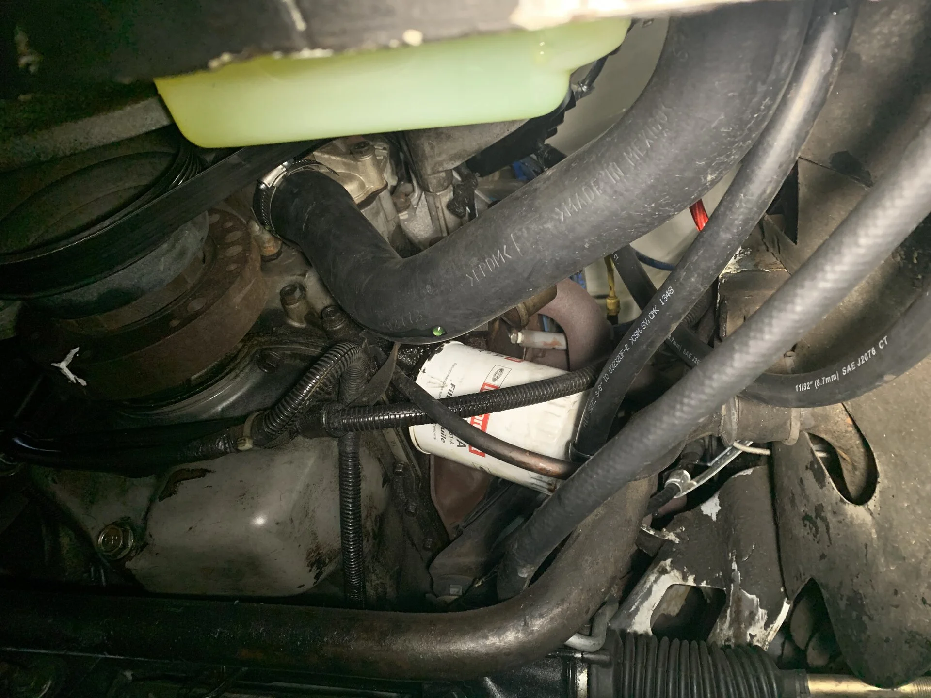

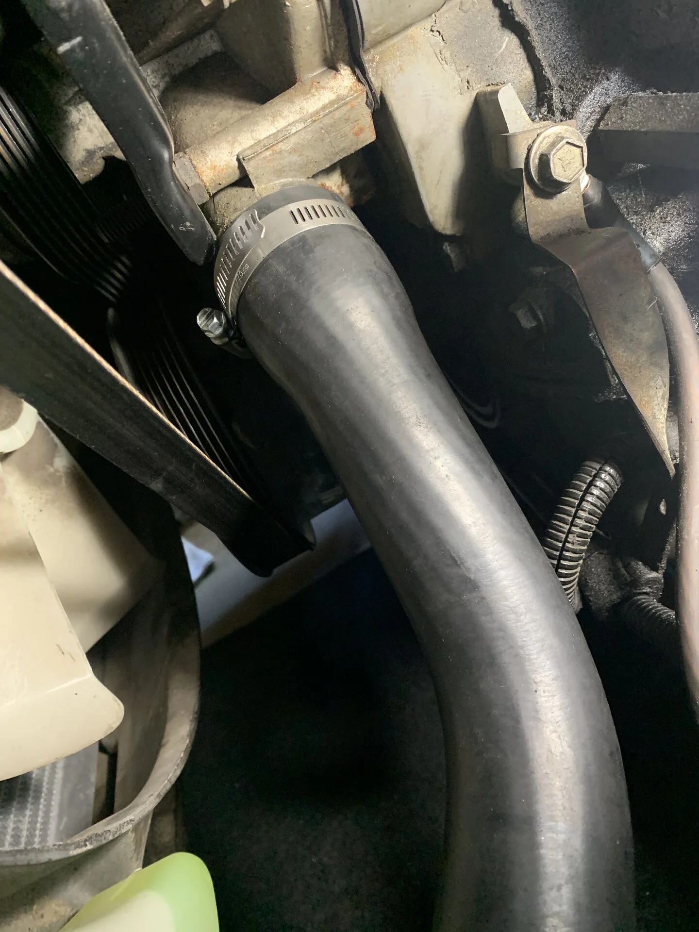

OK so I’m stuck again. I’ve got all the new hoses installed and I redid the thermostat housing. The housing appears to be fine as far as the seal goes now....but after I started the car up, I noticed a slow drip/leak coming from the top of the lower radiator hose. This is where I had a leak previously, which is what led me to want to replace the hoses in the first place. I checked the weep hole on the water pump and it looked fine...so I figured maybe I had the hose clamp aligned incorrectly and maybe it wasn’t sealing.
I drained some coolant, took the lower hose off, and reinstalled it. As soon as I added coolant back, it started leaking again...but this time more quickly. It’s dripping like once every 5 seconds and again it seems to be coming from the top side of the lower radiator hose, running down to the “elbow” and then falling into my drip pan.
9C05C14A-46FD-406B-81D2-CAF753B12E30.webp 8985C9C7-A68F-4711-8865-109876F1E068.webp
Any thoughts on what it could be? Maybe I still just don’t have the hose clamp on the right spot to seal the hose correctly?
9C05C14A-46FD-406B-81D2-CAF753B12E30.jpeg 8985C9C7-A68F-4711-8865-109876F1E068.jpeg
Did you clean the surface that the hose slips on to? Maybe a little scotch brite or sandpaper. Could be some corrosion causing it not to seal properly?
I did not but that seems like a good idea. Will try that when I can take a break from work or later when I’m done working. Thanks!
Just a couple of other ideas.... are you sure its coming from the hose connection point and not higher up ?
You may have mentioned it but did you replace the water pump, wondering if there could be a hairline crack just above hose outlet ?
Reactions: DudeStang
I didn’t end up replacing the water pump. It seems like it’s coming from the hose connection point but when I pull it off again, I will try to get a closer look at the hose outlet.

OK, so yesterday I drained the coolant again, removed the lower hose, and used a scotchbrite pad thing to clean up the surface on the water pump where the hose goes. I tried to get as close as I could with a light but didn't see any cracks. I put the hose back on, tightened both hose clamps, and added coolant again. I got a drip again immediately from the same area. I had only tightened the hose clamp with a flathead screwdriver so I figured I would try to tighten it with a little socket. I did that and it slowed the drip down considerably, but there was still a slow leak. I was tightening from the top so I couldn't see what the hose looked like at first but I could hear the dripping stop. Then when I got back under the car, I saw that the hose clamp was digging into the hose enough to cut into the rubber a tiny bit. As soon as I loosened it again, it start dripping like crazy. I tried adjusting the placement of the hose clamp a few different times but couldn't find a spot where it wouldn't drip.
Eventually I just got tired and came inside for dinner. Going to mess around with it again tonight or tomorrow. If I can get it to where it's just a really slow leak again, without digging too far into the hose, I might just live with that for a little bit and see if I can drive the car with no problems. Maybe when I get the car off the ground to focus on the leaks, I can revisit.
Somehow the lower radiator hose leak managed to fix itself. Last night I wiped down some coolant off the hose and then when I came out to check this morning, there was no sign of dripping or leaking. I still have a slow drip/leak at the bottom of the coolant overflow tank but I can live with that for now.
I refilled the coolant, let the car run for a bit, checked for any other leaks, and didn’t see anything. I checked the oil level, which seemed fine, then went for a drive. Drove for about 30 minutes with no problems. Checked hoses again when I came back and no leaks. Got a video of these shenanigans coming soon.

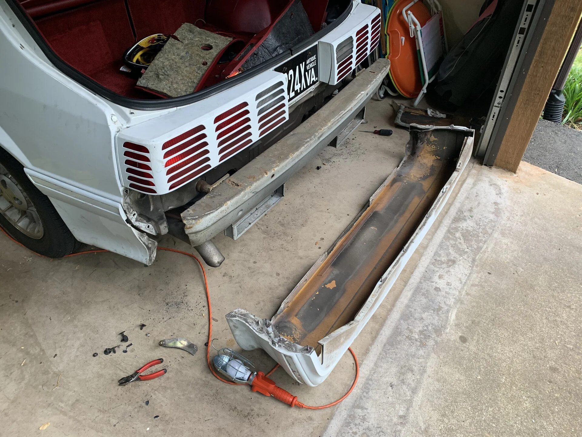

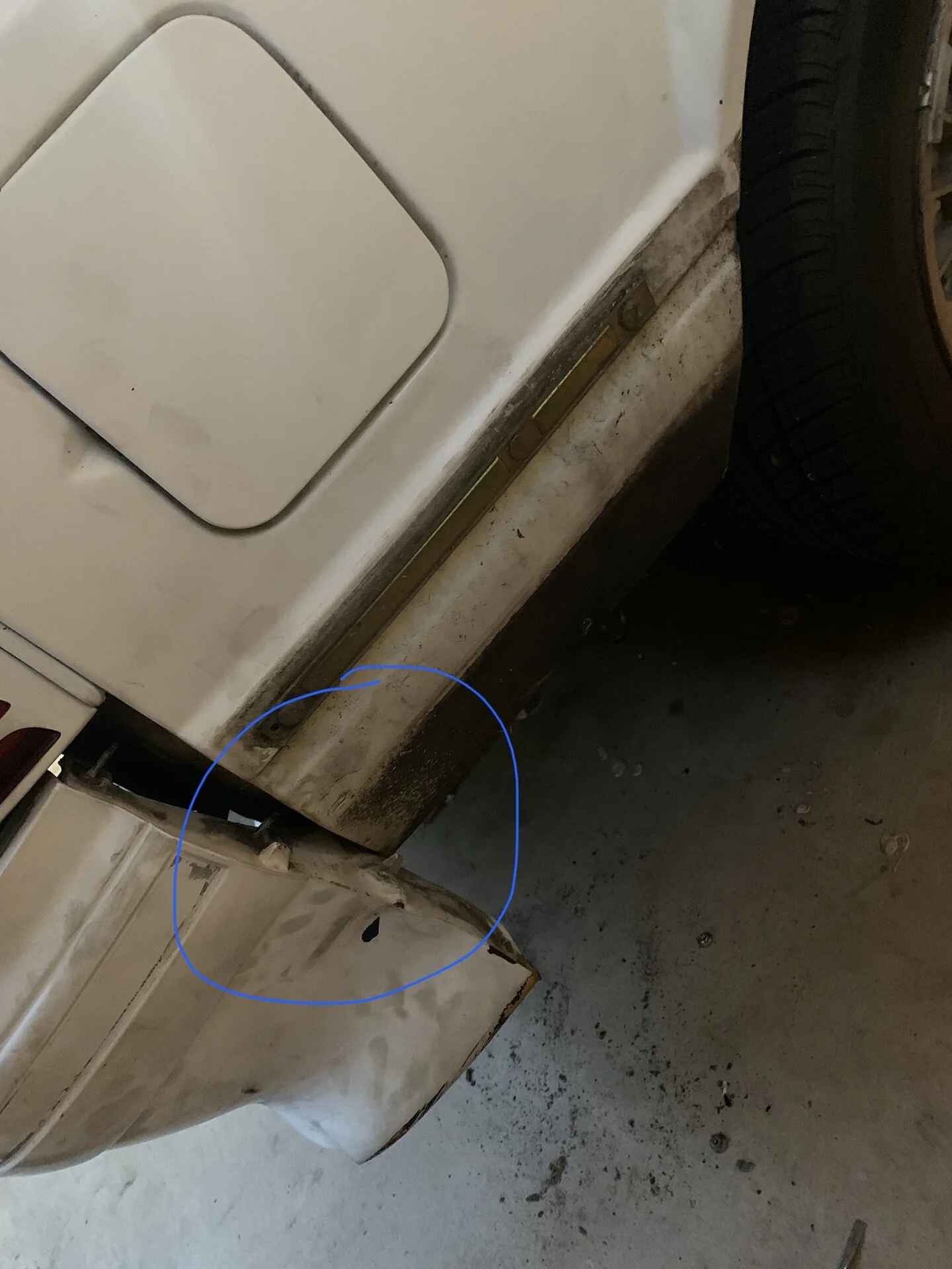

Anyone have any tips or tricks for removing the lowest nut on the passenger side holding the rear bumper cover on?
It seems impossible to get even my smallest ratchet in there and a wrench doesn’t have much wiggle room. Huge pain in the butt. :cautious:
I’ve dealt with that bolt. It’s pain in the ass. Just gotta work at it. I think it took me about 20 minutes to get that outta there. I mentioned it in my thread a few years back.

New video is up, taking forever to remove the damaged factory bumper cover and checking fitment on the new replacement bumper.
View: https://youtu.be/sJ6T8Sr6JH8

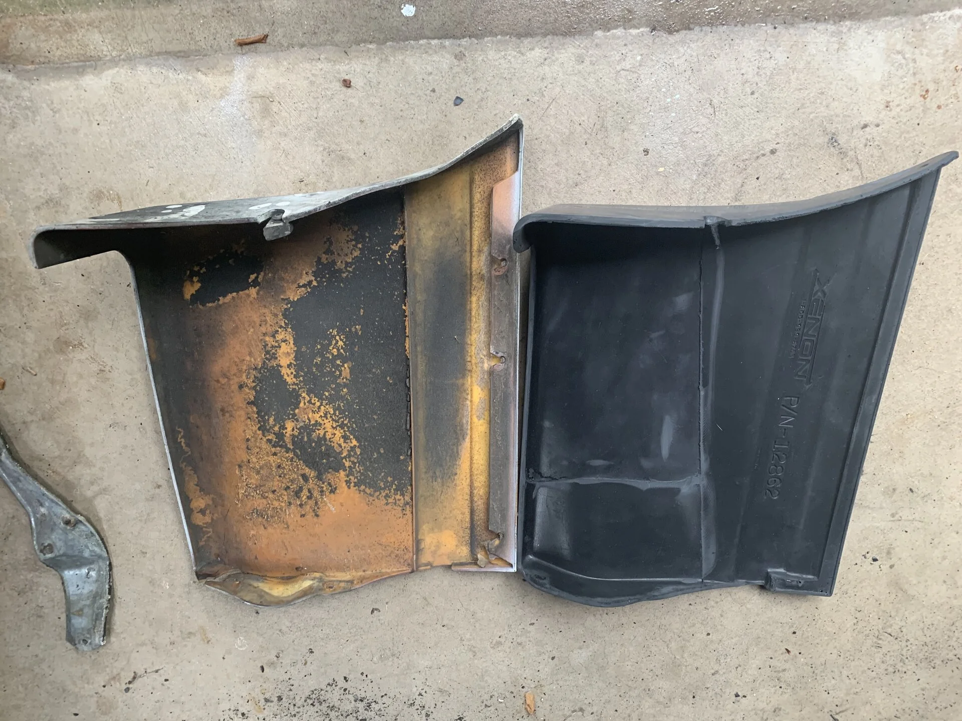

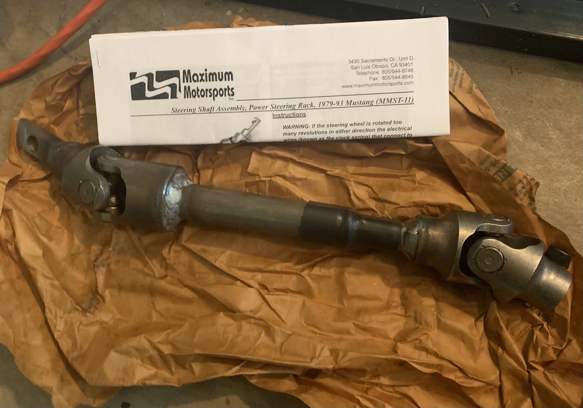

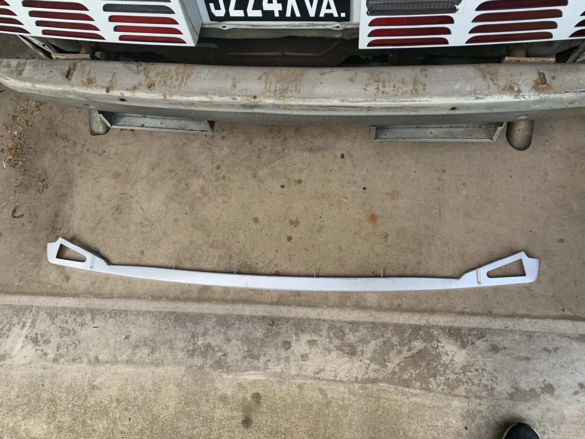

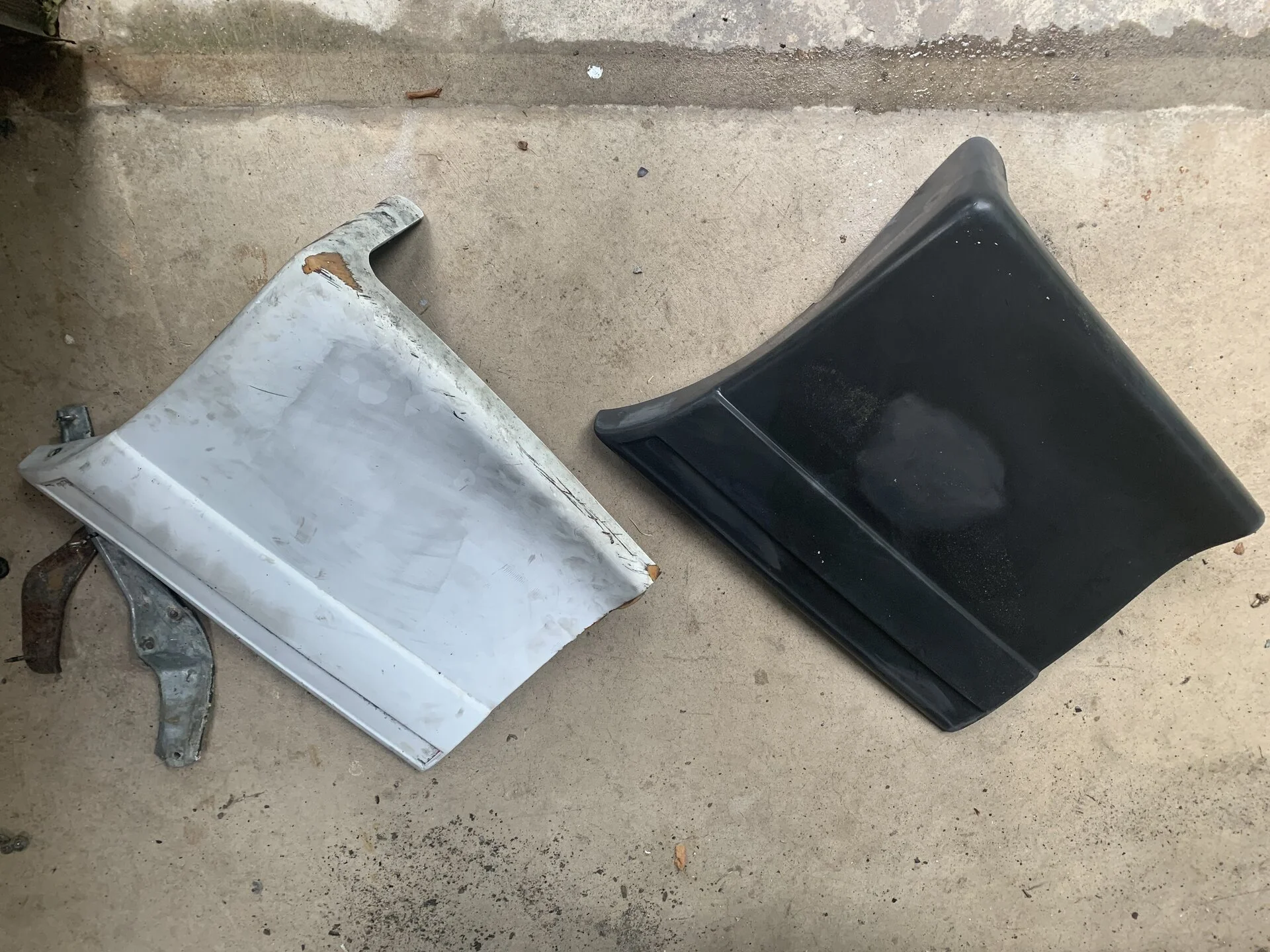

A few other things arrived yesterday
Passenger side rear ground effect replacement:
MM steering shaft:
I’m looking forward to having more precise steering on the Fox but I’m a little worried about the installation on this, lol.
I’ve got a few things I want to do on the Dudestang before I get to the steering shaft.

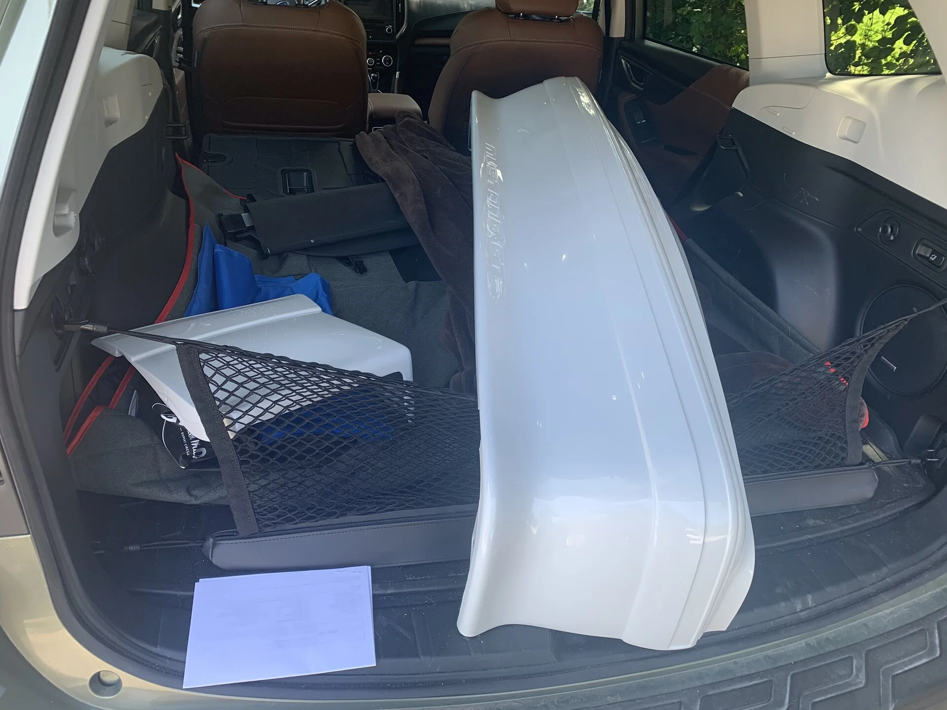

Picked up the newly painted bumper cover and ground effect piece this morning:
