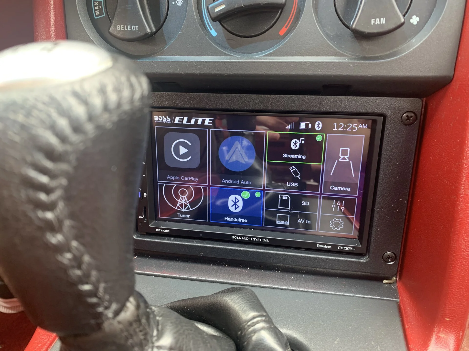

Took my Fox to a car audio shop with the intention of getting a quote - the guy wasn’t super busy that day and I ended up having him install this in about an hour:
Also found out that there is no speaker in the passenger side door, but the rest of the speakers are working fine. Nice to have music/Apple Car play in the Fox.
Forgot to post this when I uploaded it, but just a bit more on the new head unit in a video I finished last week:
View: https://youtu.be/d9Awe2CL9d4

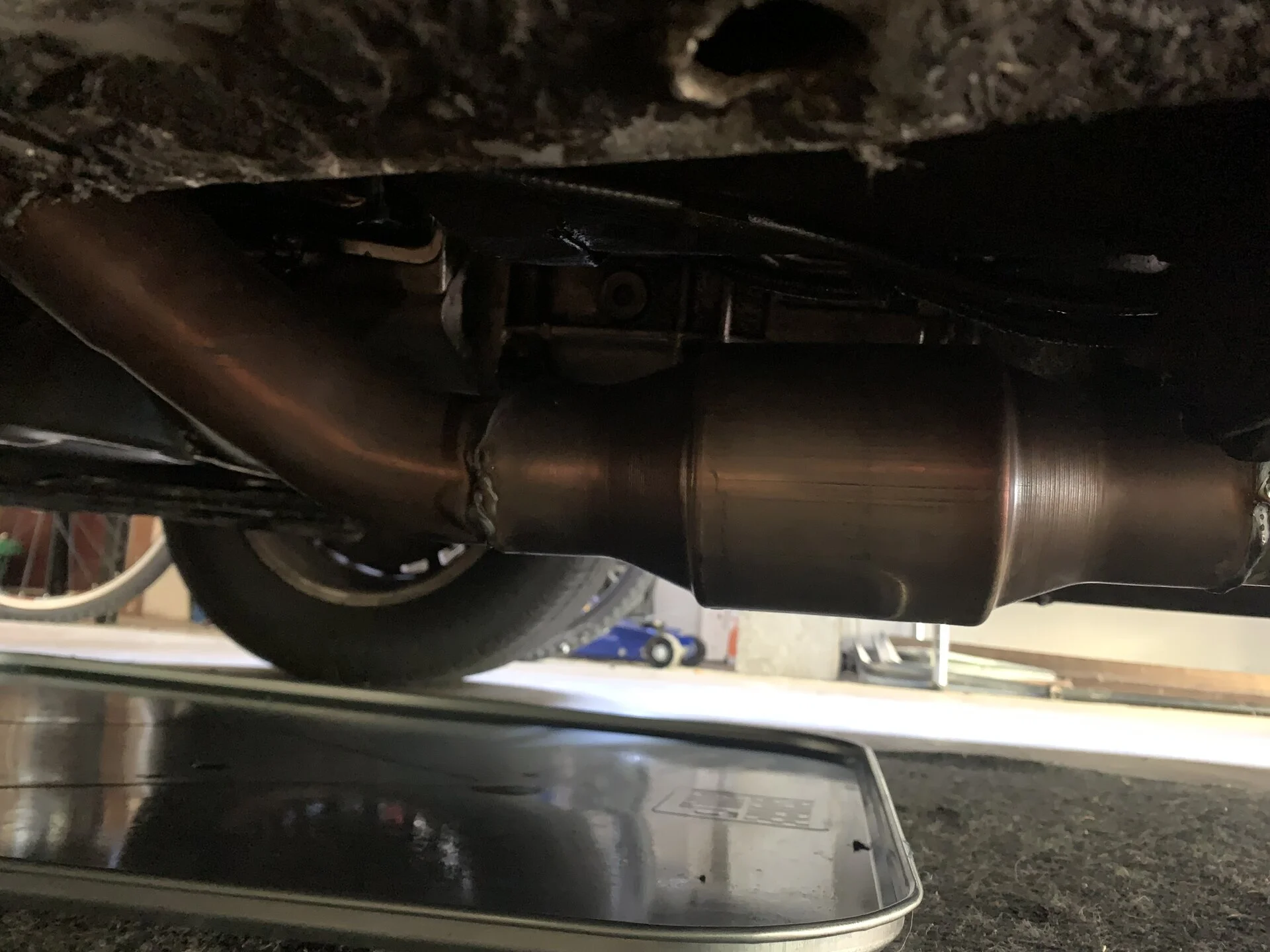

I had a shop weld in the Flowmaster high flow cats this morning. I’ve only driven it home from the shop but it seems like the exhaust is a LITTLE bit quieter and I didn’t notice as strong of a gas smell after driving the car.
I am happy that it’s a little bit quieter but of course I still have the drone of the Flowmaster mufflers. At some point I’m probably going to try a different muffler design but I’m not in a rush at the moment.
They were also supposed to weld the factory horn bracket back in but they said a different type of welding was required that they couldn’t do (something about the metal on the bracket being too thin I think). So I will need to find a different shop that can help with that.
