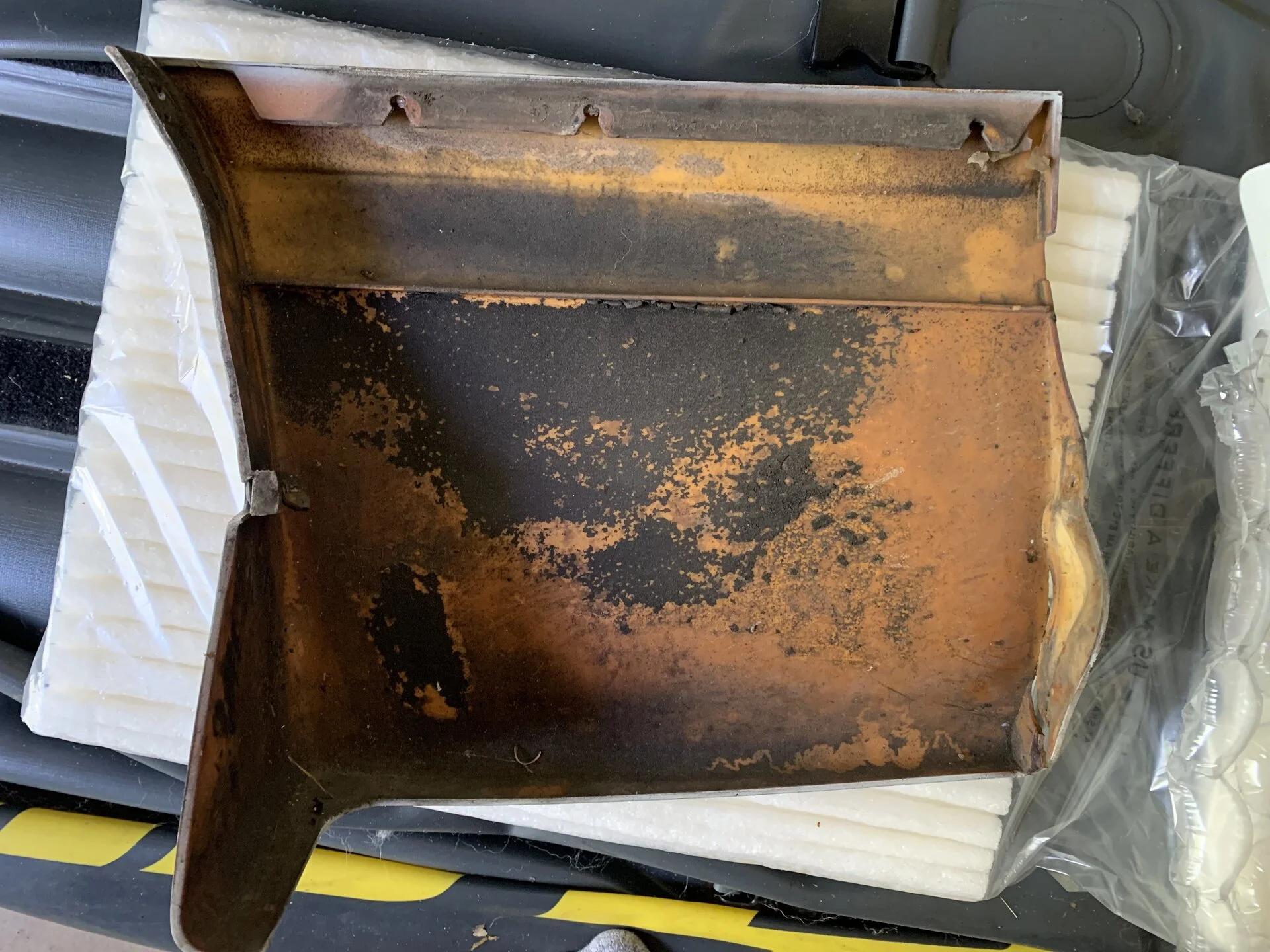

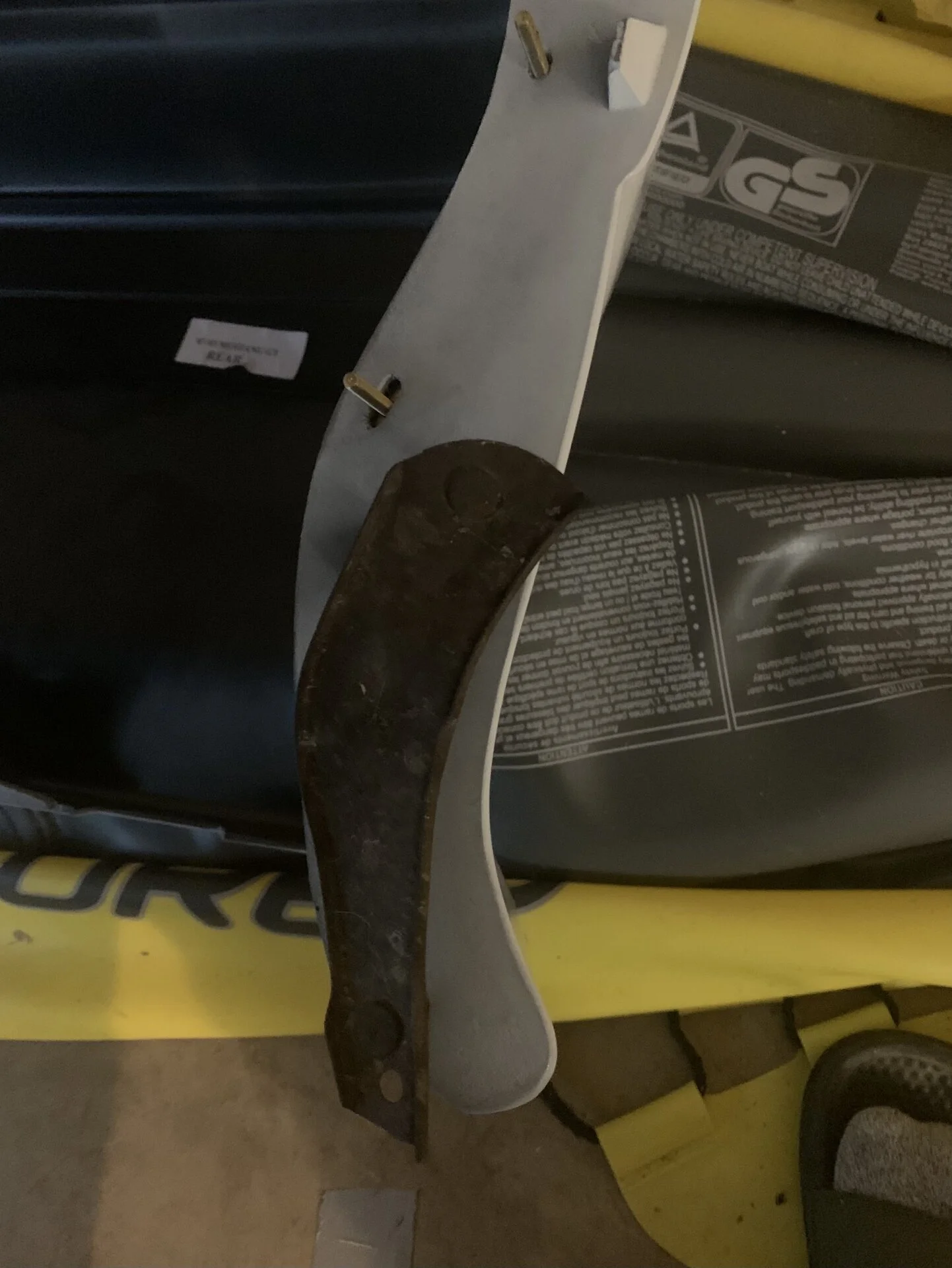

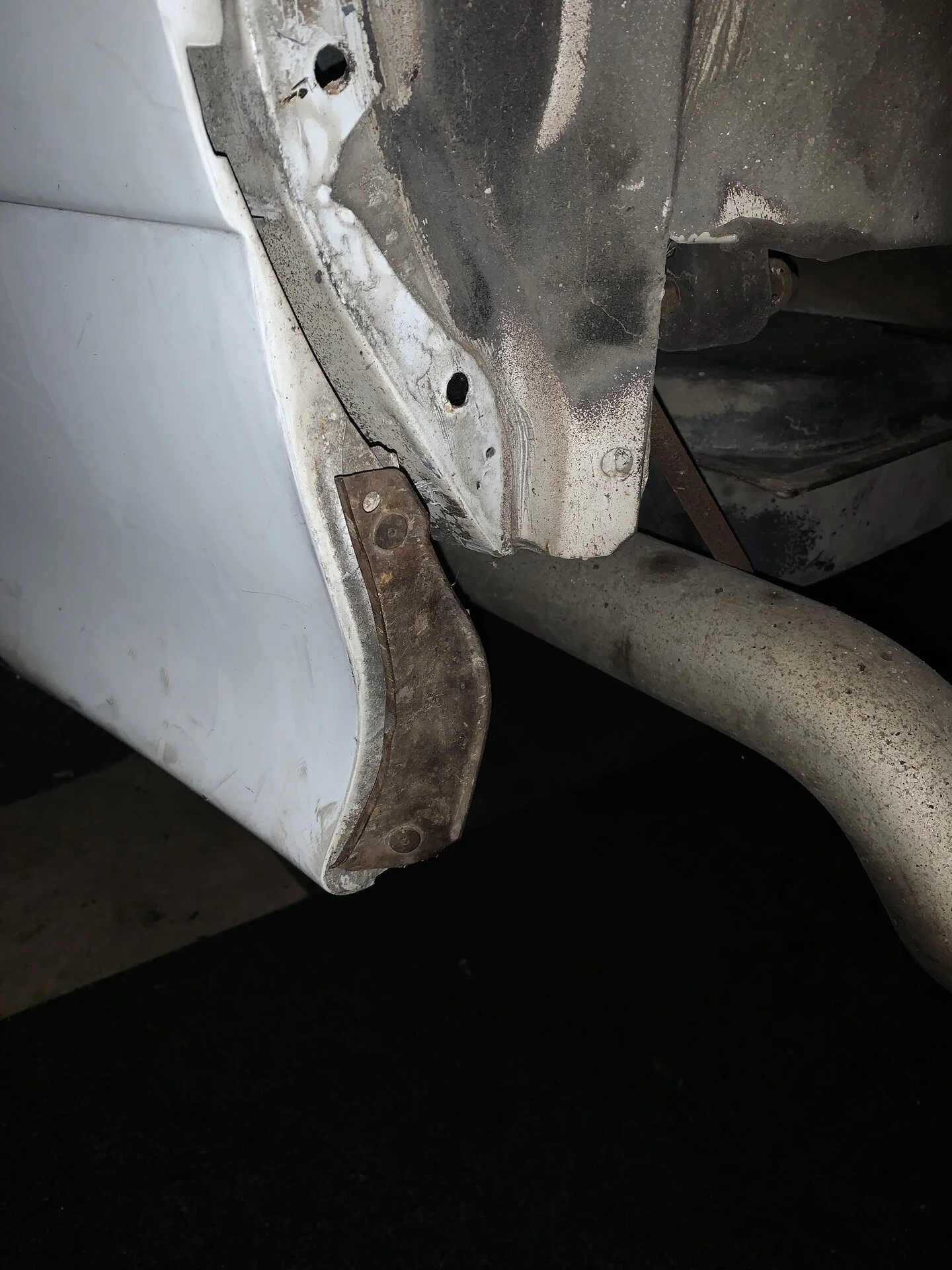

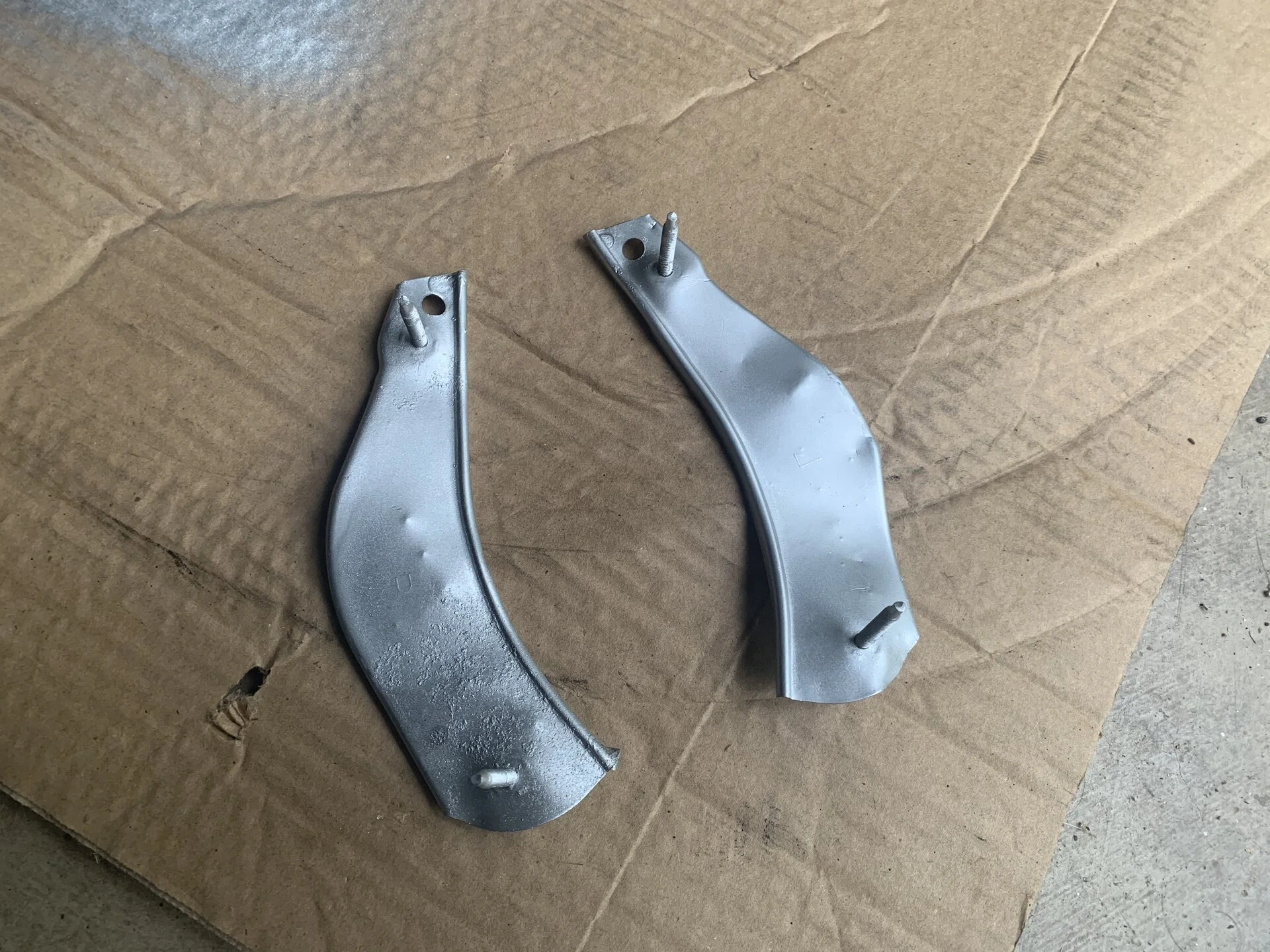

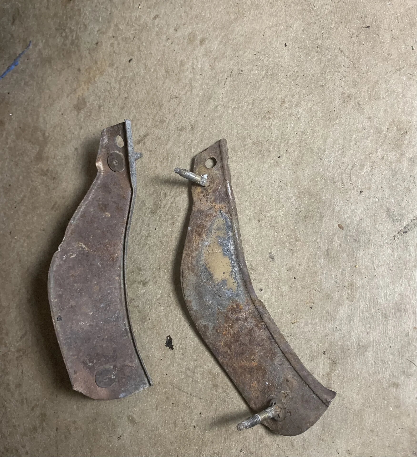

I called MRT to see if there’s any way to get the new brackets from this kit without ordering the whole kit. They are supposed to get back to me. If that doesn’t work out, I’ll likely be trying to fix my oem brackets as you suggested.That looks a lot better. Those things could be cleaned up with evapo-rust and a quick chase of the threads with a tap and die kit. Cheap at local stores. Paint them to add some longevity.

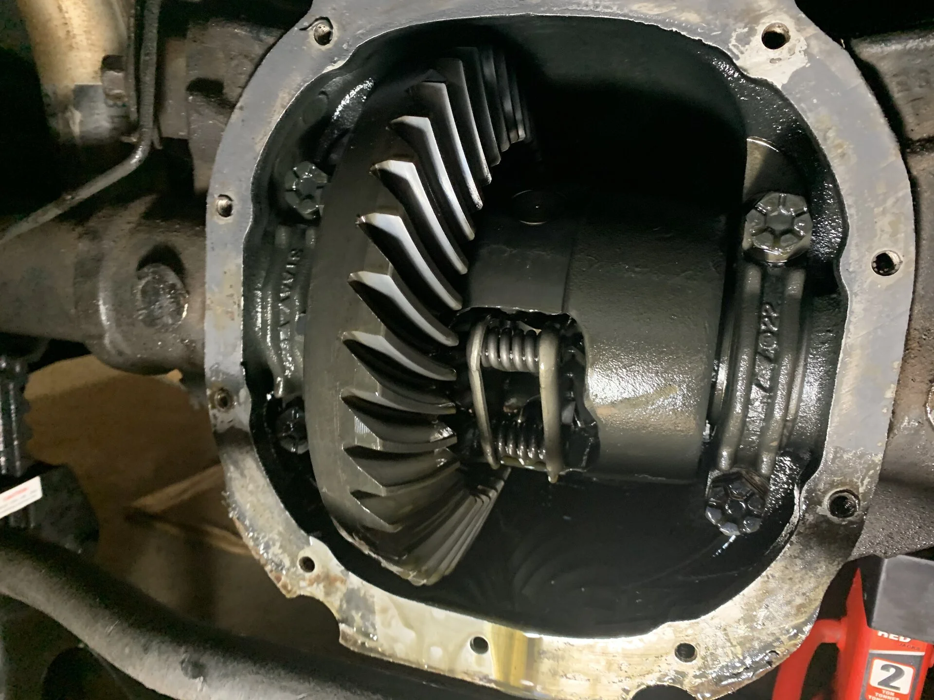

If it does, it would have been done by a previous owner. Is there any way to tell visually? I didnt take a super close look when I flushed the diff fluid last year.Just got done reading through this thread.

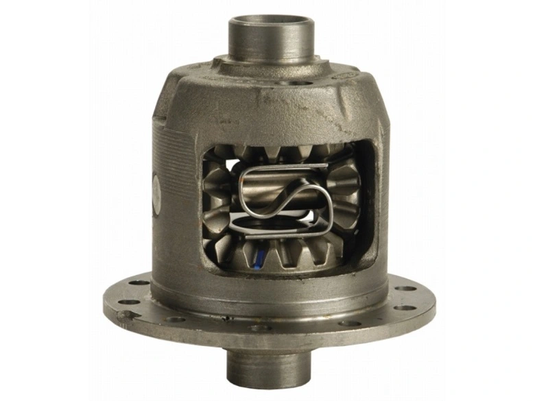

I may have missed this, does your car have an Eaton Diff?
I'm not sure, but it definitely doesn't look like a stock Trac-lok unit to me. Trac-loks have the big heavy duty "S" spring, whereas it looks like yours has the coil springsIf it does, it would have been done by a previous owner. Is there any way to tell visually? I didnt take a super close look when I flushed the diff fluid last year.
Wow. That’s helpful. I was trying to look up pictures of stock diffs but wasn’t finding anything that seemed clear and legit.I'm not sure, but it definitely doesn't look like a stock Trac-lok unit to me. Trac-loks have the big heavy duty "S" spring, whereas it looks like yours has the coil springs

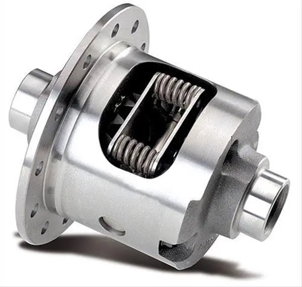

This is a trac lok:
This is an Eaton Posi:
And if someone went through the trouble of installing an aftermarket diff, I can't imagine they'd keep the stock gears.

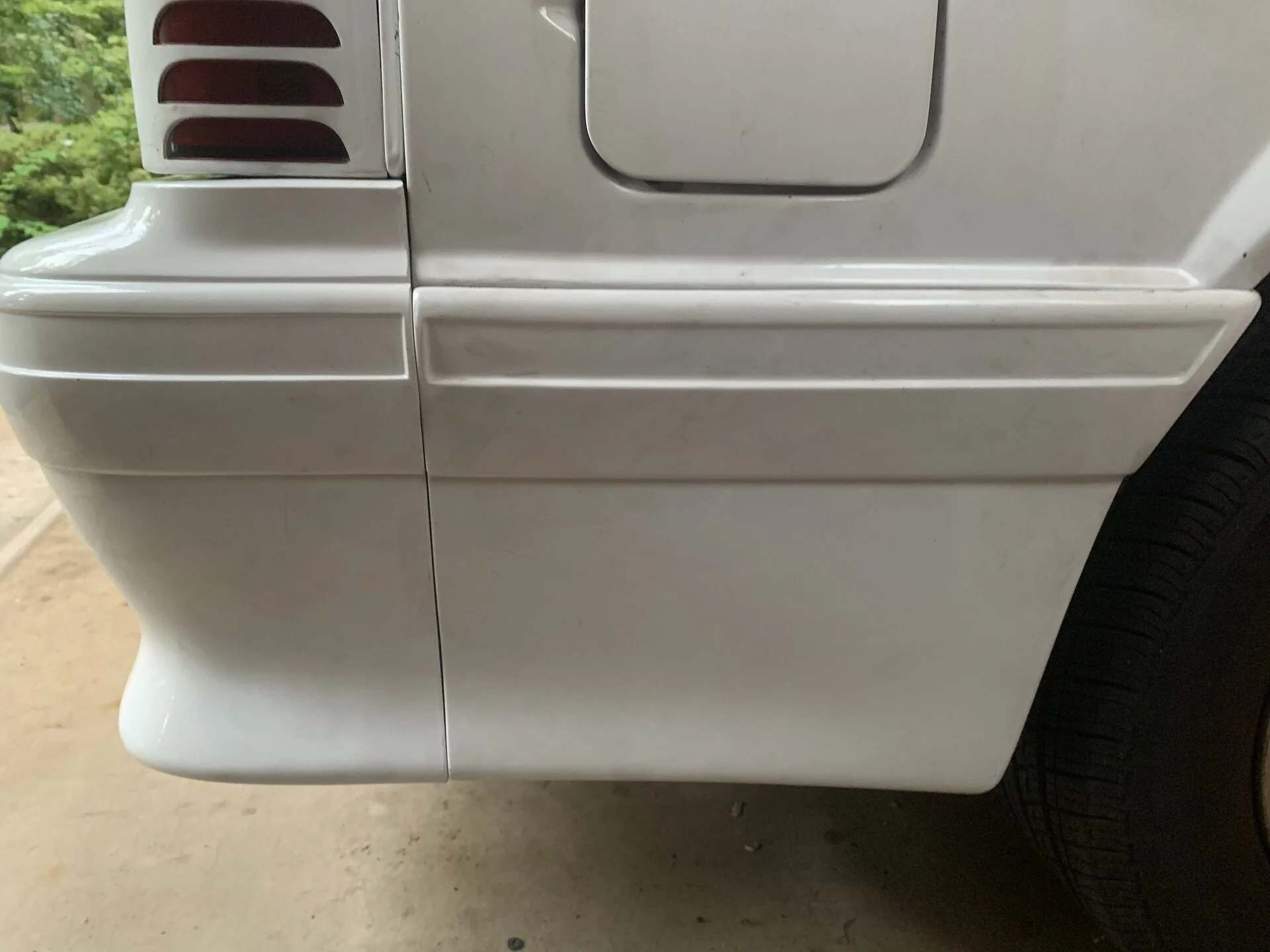

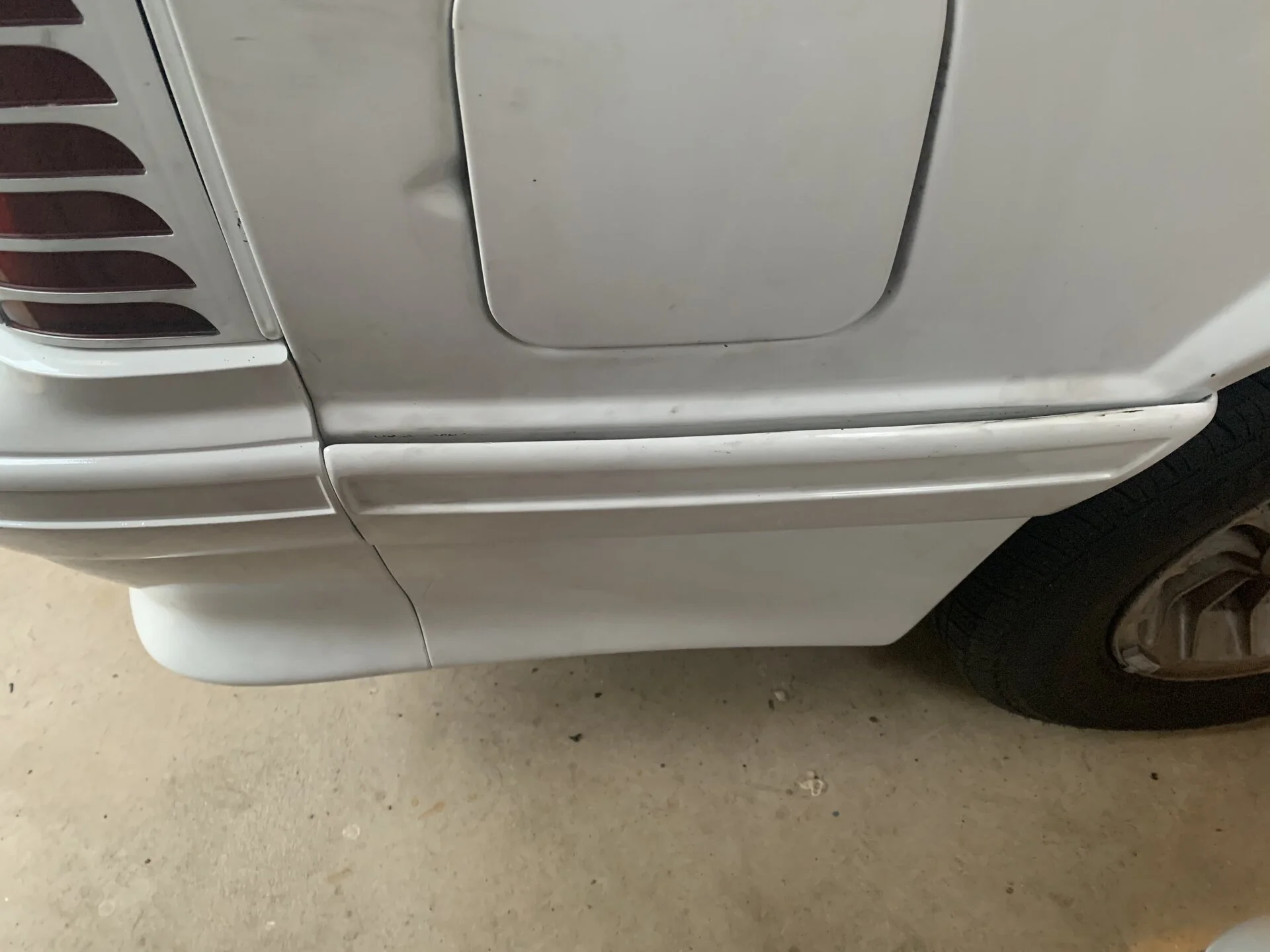

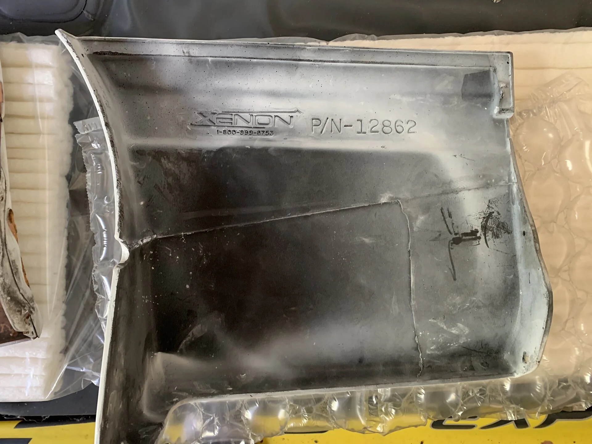

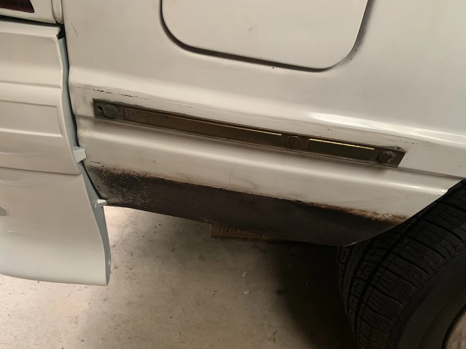

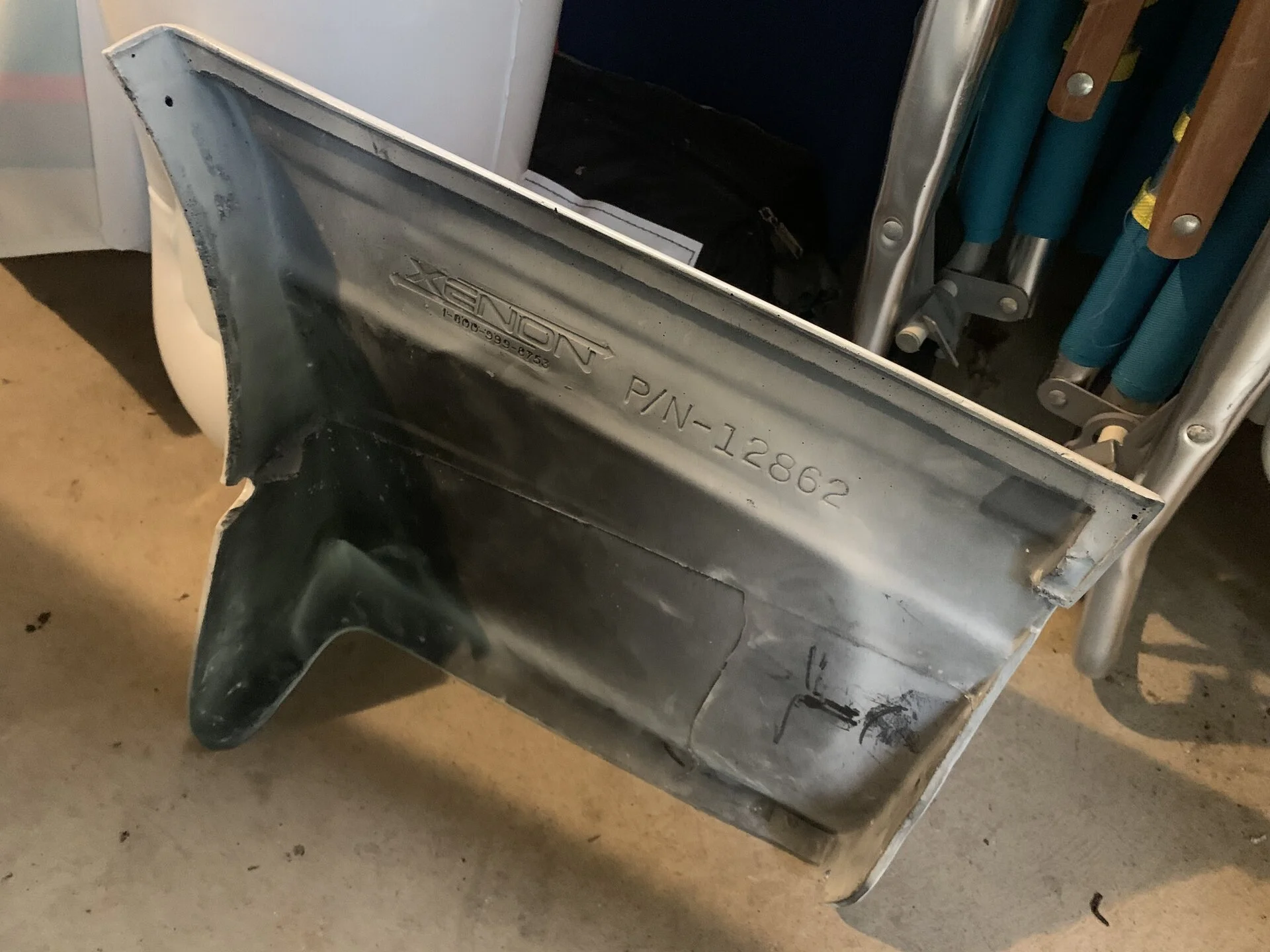

Yeah the OEM piece has some notches but the aftermarket/replacement piece doesn’t have them. Kind of lame but hopefully I can still make the new piece work fine.The metal bracket on the body stays and the lip of the ground effect slides behind it , iirc it was a pretty tight fit , careful not to mar the paint.
Those pieces on my 93GT had notches cut in them were they slid around the rivets on the body mounting bracket ,
yours look a little different are they aftermarket ?

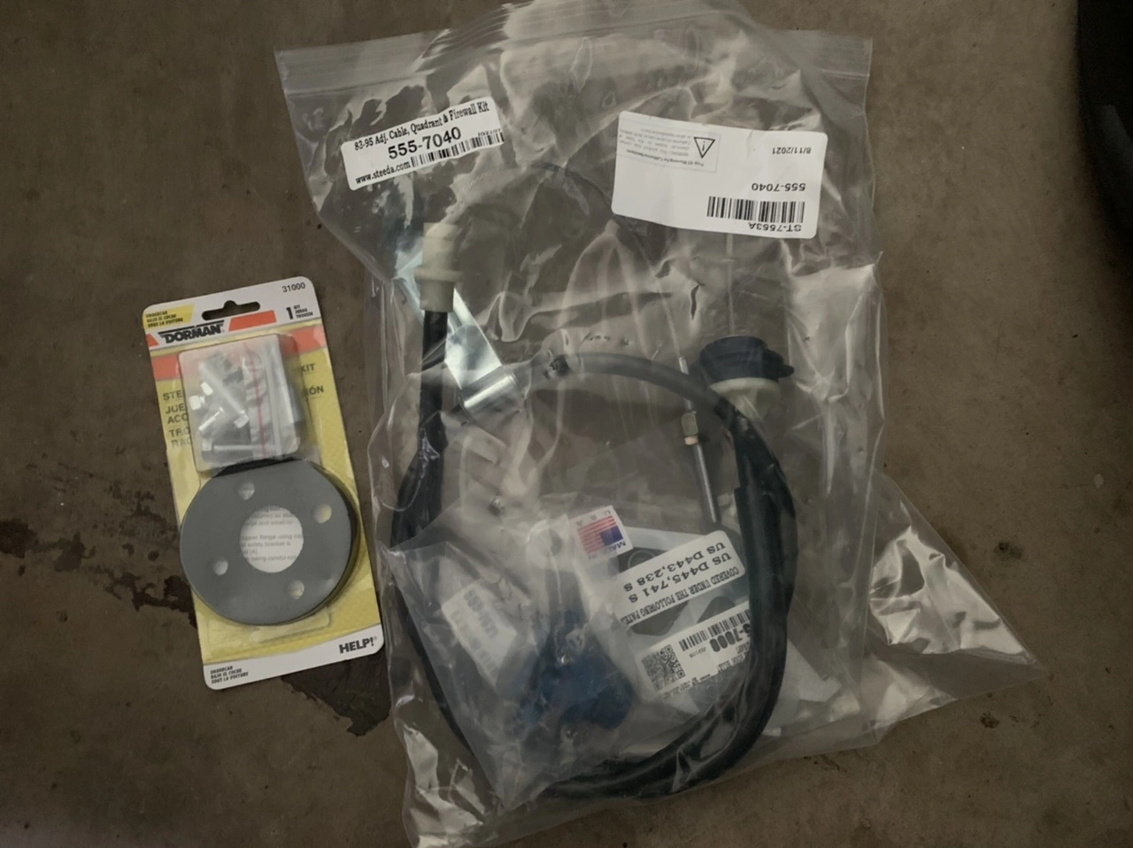

I still haven’t had time to install the MM steering shaft assembly. I also picked up a Steeda clutch cable kit recently so I’m hoping to do both of those around the same time.
