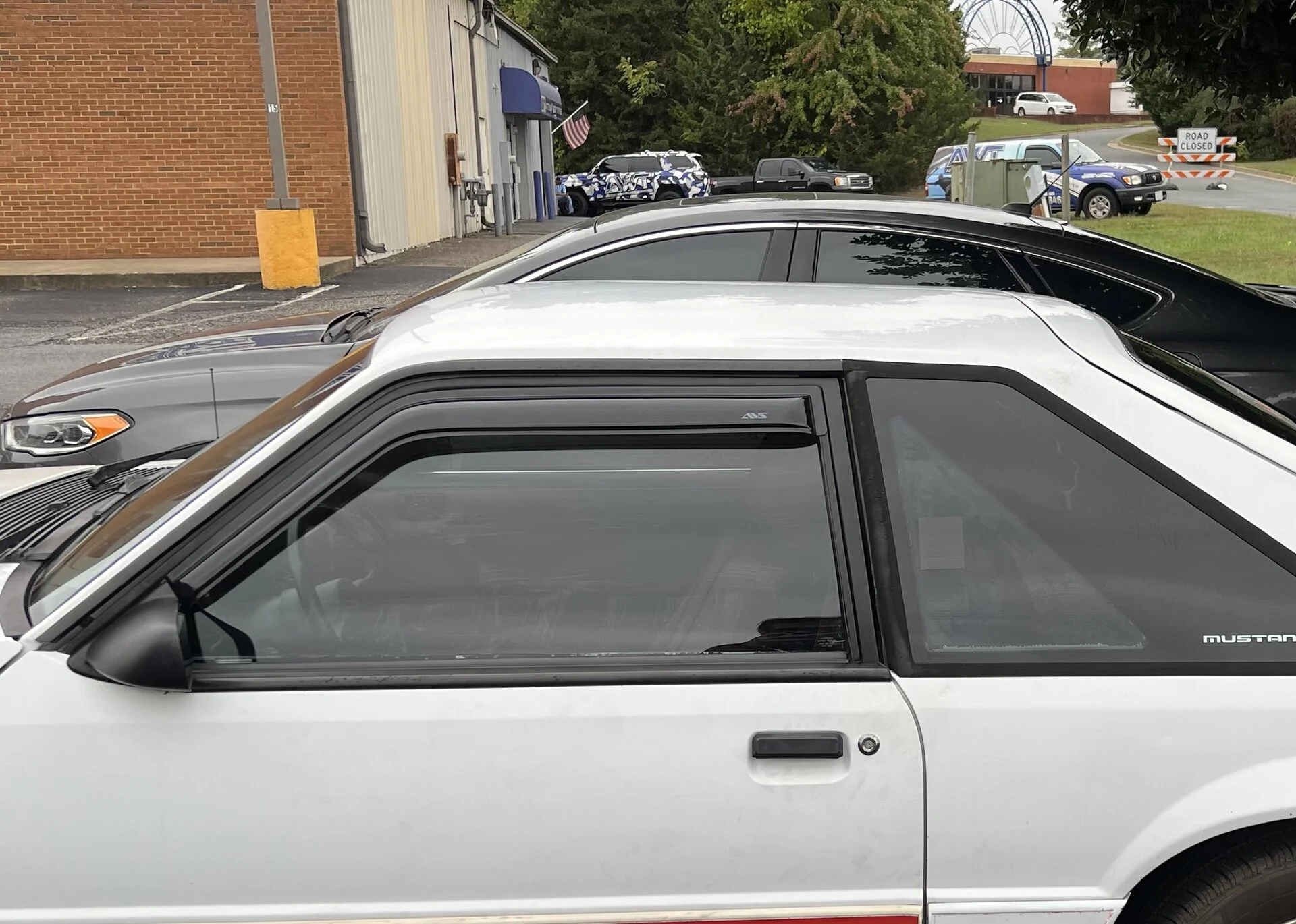

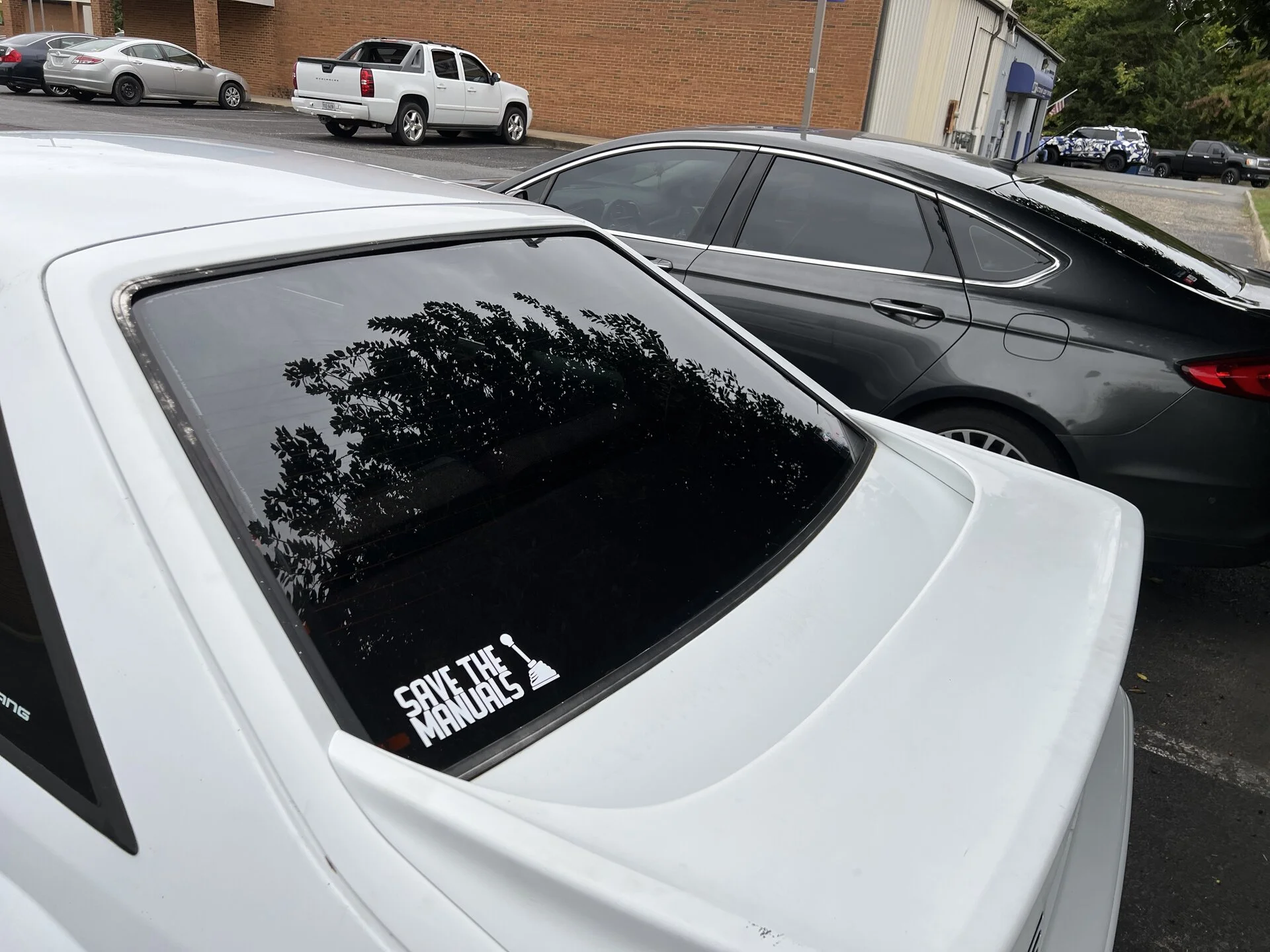

Just picked up the car. I paid $265 total. It’s still legal so it’s 35 percent on the rear and 50 percent on the sides (darkest you can go legally in Virginia). I’m pretty happy with the look and it doesn’t seem too dark inside the car (but will have to check it out at night to see how that is).
Need to get some better pics but here’s how it looks:

Looks really good! There's something about tinting the windows that just makes it seem like it has a lower roof line. =)
Thanks for posting the cost. That helps, it was in the ballpark of what i had estimated.
I'll have to check into the rules for Michigan, I think they're much worse about the tint levels than other states. I definitely need the rear window done. The slope makes it almost like a greenhouse. Plus, it would probably save me the trouble of hitting the mirror button when driving at night.
Thanks for posting! It has been fun to watch the progress on your car. Nice work!

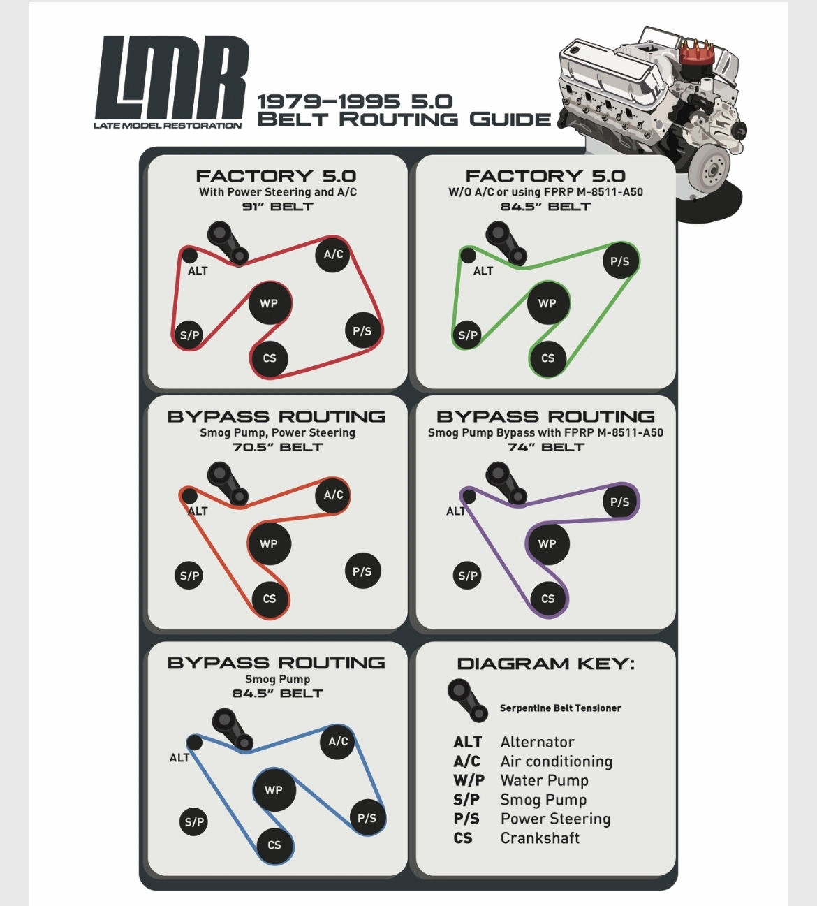

Where did you see the 84” number? Is that for smog pump bypass and AC delete?
I’ve seen some mixed info in a few different places. According to LMR’s belt routing guide, it should be a 74” belt:
But this belt that appears to be for the same application (for sale on LMR) is listed as 73.5”.
Also, CJ Pony Parts has one like this listed at 73 inches.
I guess I could just try to use measuring tape to simulate the route and see how long it is.

If you are having trouble figuring out what size belt you need you can do what I've done in the past. You should be able to get in the ballpark with a string or research. Go to your favorite parts store and buy a few belts in half inch increments. 73, 73.5 74, 74.5. Tell them what you are doing and they will let you bring back the ones you dont need. I did that when I changed the belt on my car. It only has the smog delete, but the recommended belt size did not work. Turns out the belt on my car is the same as what they use on a V6 Dodge Magnum.

Sorry, I forgot about the AC delete. I used the same diagram you showed to get the 84” belt for my smog pump delete.
Reactions: DudeStang

I will double check when I get home to see what belt size I used for “no AC/ no smog”, but I also had to try a few to get it right, where the tensioner was in the right place.

73.5” is what ended up being the right fit for my motor.
