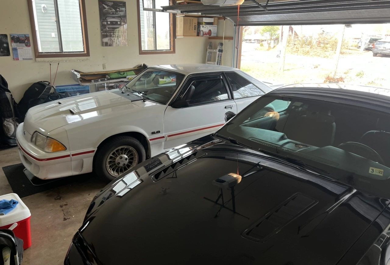

Almost a month later, I finally picked the Fox back up today. The 4.10 gears are installed…..along with new 31 spline rear axles, a new rear main seal, a new clutch, a new clutch cable, and the speedometer gear kit. Long story but I think most of you know how it goes. I wasn’t thrilled to spend more money but I am happy that some things I knew the car needed (or would need not too far down the line) are fixed or replaced.
So far, I’ve only driven the car back from the shop to my house because I am working today. I didn’t drive it too hard right after picking it up. Maybe folks on here will have thoughts but it seems I should not go too bananas for a few hundred miles after the new gears are installed.
So far, my takeaway is that this was extremely accurate:
The advantage will be you don't have to down shift to pass at 50 mph.
It actually reminds me a bit more of my other mustang now, in that it feels like there’s enough power/torque no matter which gear I’m in. We’ll see how I feel in a few weeks or months.
Also, the clutch feels lighter, which is nice. I haven’t driven the car in almost a month though. Will need to drive it more.
I’m curious to see if the RMS being replaced will help significantly reduce the amount of oil dripping. Fingers crossed.
